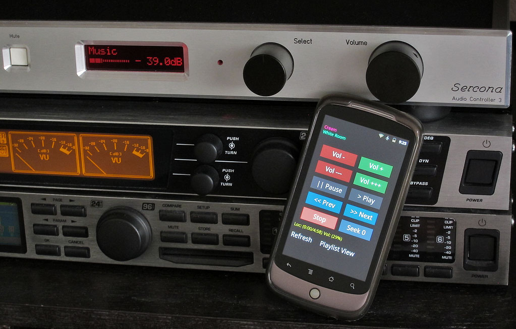

I have discrete input, middle and output boards. it gives me a chance to change things out or play around before I settle on something final.
input board is passive in its current state but will get some 8pin opamps as input buffers. the caps (green nichicon muse) will be after the input op-amp but before the cirrus input pins. that will hopefully offer the most click-free volume changes.
the output board has room for opamps as well but I didn't finish all the wiring for them and so I have jumper stubs in place, for now. the relays do work and they do a great job of muting if 'bad things' happen or even just at turn-on and at turn-off time. even abrupt turn-off does a fast mute, so things are safe and quiet. these relays also act as a way to do output selection.
the rear has a firewire port (6pin standard using standard pc style cable) that goes to my DIY spdif switch. or it goes to my DIY port selector on my dac 😉 either way, when I select inputs, it changes the spdif source. I have an option for analog relay switching too but these days, I do everything digital as a source.
the ribbon cable on the far left goes to a db9 on the back. there's a plastic dongle that holds an xbee rf modem. that gives me wireless remote control via a peer xbee that is connected to my pc via usb. a webserver connects to that usb/serial port and they talk. I threw together a shell script that keeps the local alsa system vol control in sync with the serial port cirrus chip. it works pretty nicely and its a nice new way to control things, using existing gui apps that others have written for their phones.
I'm very happy with this cirrus. very. even with all this crazy hand wiring, it still sounds really good and has none of the trouble that I was getting with the pga chip.

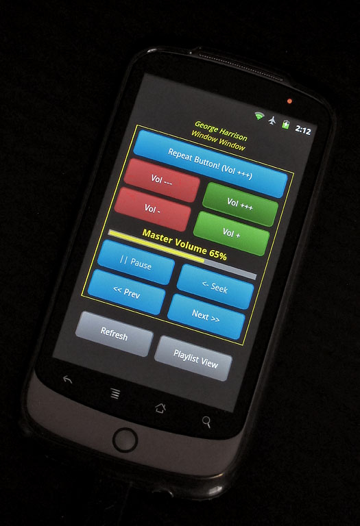

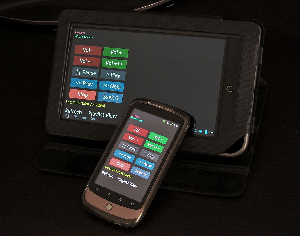

taking the free software 'mpdremote' (php web app) and hacking it to be a bit more usable for my own preamp.
not a native android app but it didn't take much effort to get this going (and I am not yet an android developer).
when the rasp pi board is stable enough to use, it will be a nice little web back-end processor. for now, though, I still use a mini-itx intel board (dn2800 atom mobo).

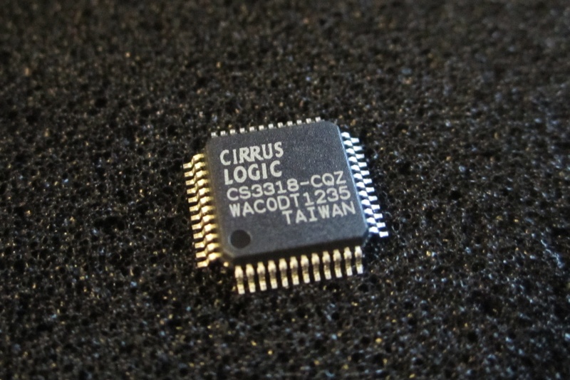

Hi Bryan, I am following your steps on more forums incl. AMB as I intend to follow similar concept. As I am in pure stereo listening I wonder if going cirrus way makes sense? What was the trouble you got with pga? For my purpose pga seems easier to handle (soldering, less pins, ready kits on eB...;-)
mba
even for just 2ch, I would prefer the cirrus. it was just easier to get better sound with this chip, for some reason. I tried a few pga variations but always had some noise bursts in some channels. could have been layout (they were mostly ebay boards with no understanding of how layout should be done) but its hard to believe the performance would be THAT bad. but it was. otoh, the cirrus with just hand wiring and perf board construction gives me no noise or issues.
the only thing I don't like is that the voltage is a bit low (9v) and so you can clip the input if you have a very hot (+22db style hot) input. for normal 2 or 4v signals, the cirrus is fine and there won't be over-driving.
soldering can be hard but using the schmart board makes it easier than it looks, in fact.

the chip was about $30 a year ago, but now its a bit lower.
fwiw, the schmartboard is very high quality. I can't always say the same about unbranded china stuff.
but its just an adapter, not too much to go wrong. when I get things like this, I check for continuity on all lines before I solder down. just to be sure.
