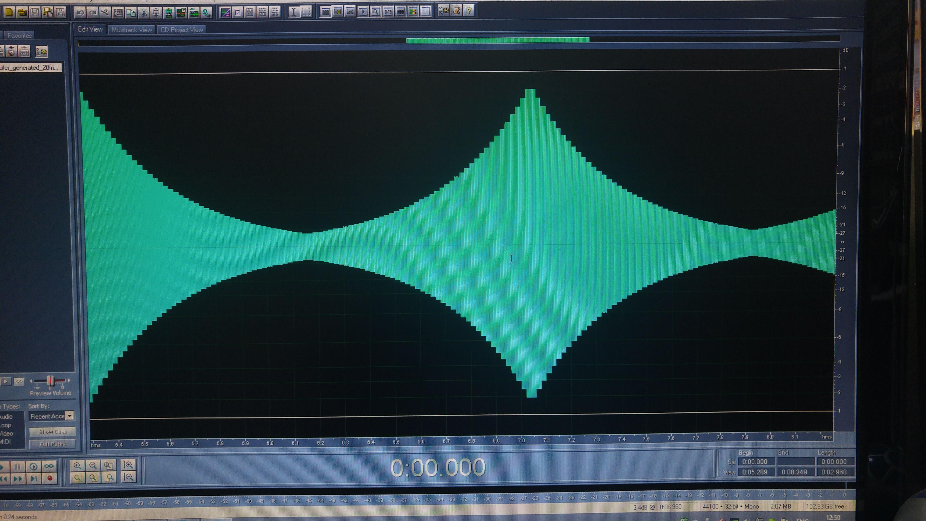

I did the audio using only 500Hz
Or you mean something else?
I attached the audio file pic, you can see the steps
As it goes high in volume the steps are more significant same goes for the clicks.
This is how exactly it looks and sounds from the output of the PGA2310

Band limited?
Yes I did mean something else. You can switch levels at zero crossing but you can still have very sharp changes at that point, as I described earlier. It is as if you modulate the signal with a square wave.
So you must band-limit the total signal to say 20kHz to smoothing the changes at the zero crossing otherwise you will have the sharp transitions cause short pulses at the switching rate. Possibly you hear that.
A simple experiment would be to run your artificial signal through a (software) 20kHz low pass and see if that changes the sound.

But when i turn the encoder to have one step, only one step and hear this one step, this theory was over.
Unless you think otherwise?
The second test i did was connecting pin 15 (AGND) to GND via 30k resistor to increase the resolution, and from the output of R to the input of L, from the output of L to the studio monitor.
In addition Some changes in the code.
The clicks are totally gone.
this solution is like touching your left ear with your right hand.
