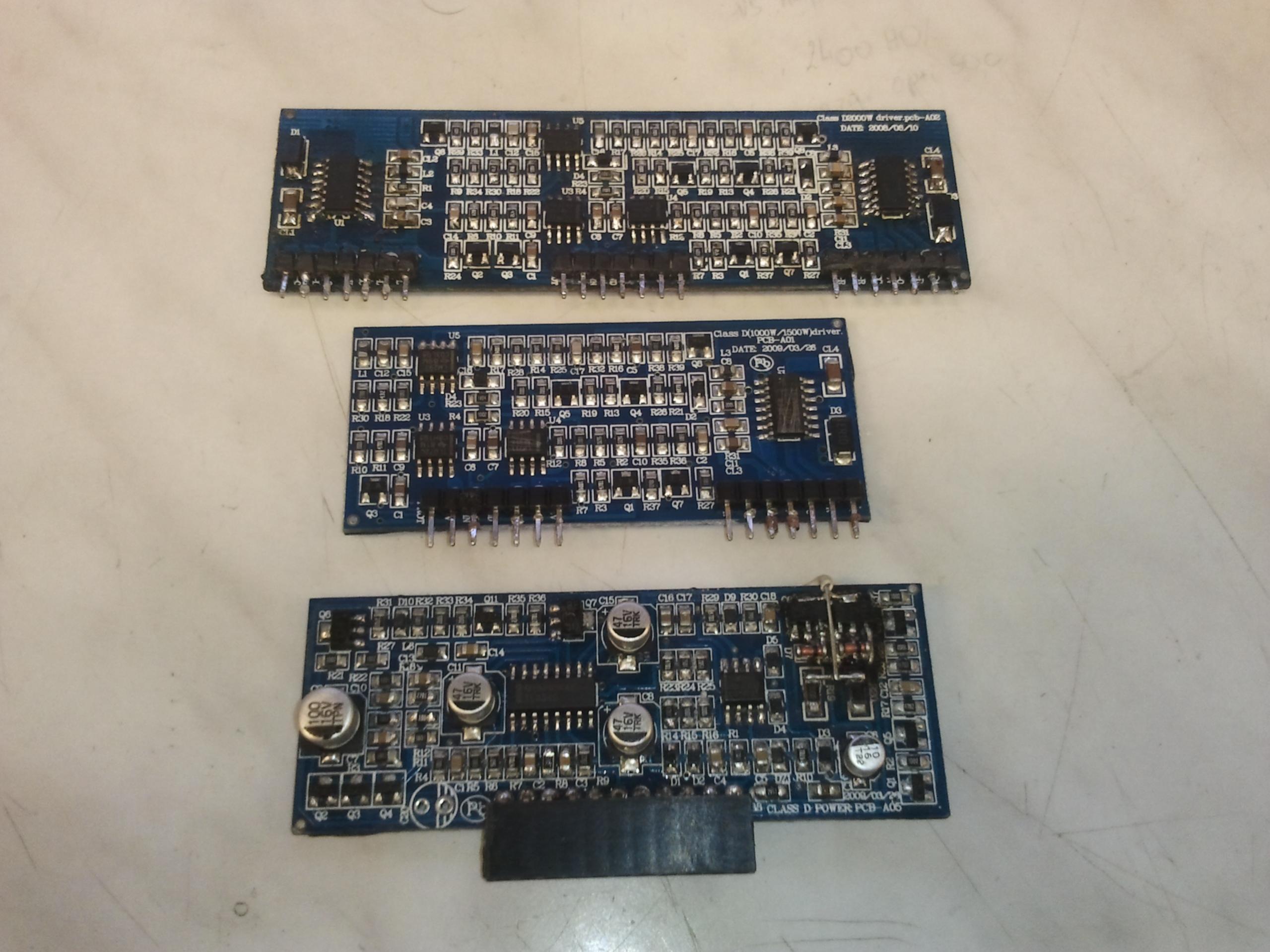

So far Ive found that this driver card is used in at least 4 amps, this amp, the brutus 4000d ,the kicker ex2000 and lightning audio la1000md, ive been trying to hunt down schematics and spare driver boards, no luck yet.
I have made a mistake, the driver card i was refering to was the PS driver board not the output board.. sorry about that.
