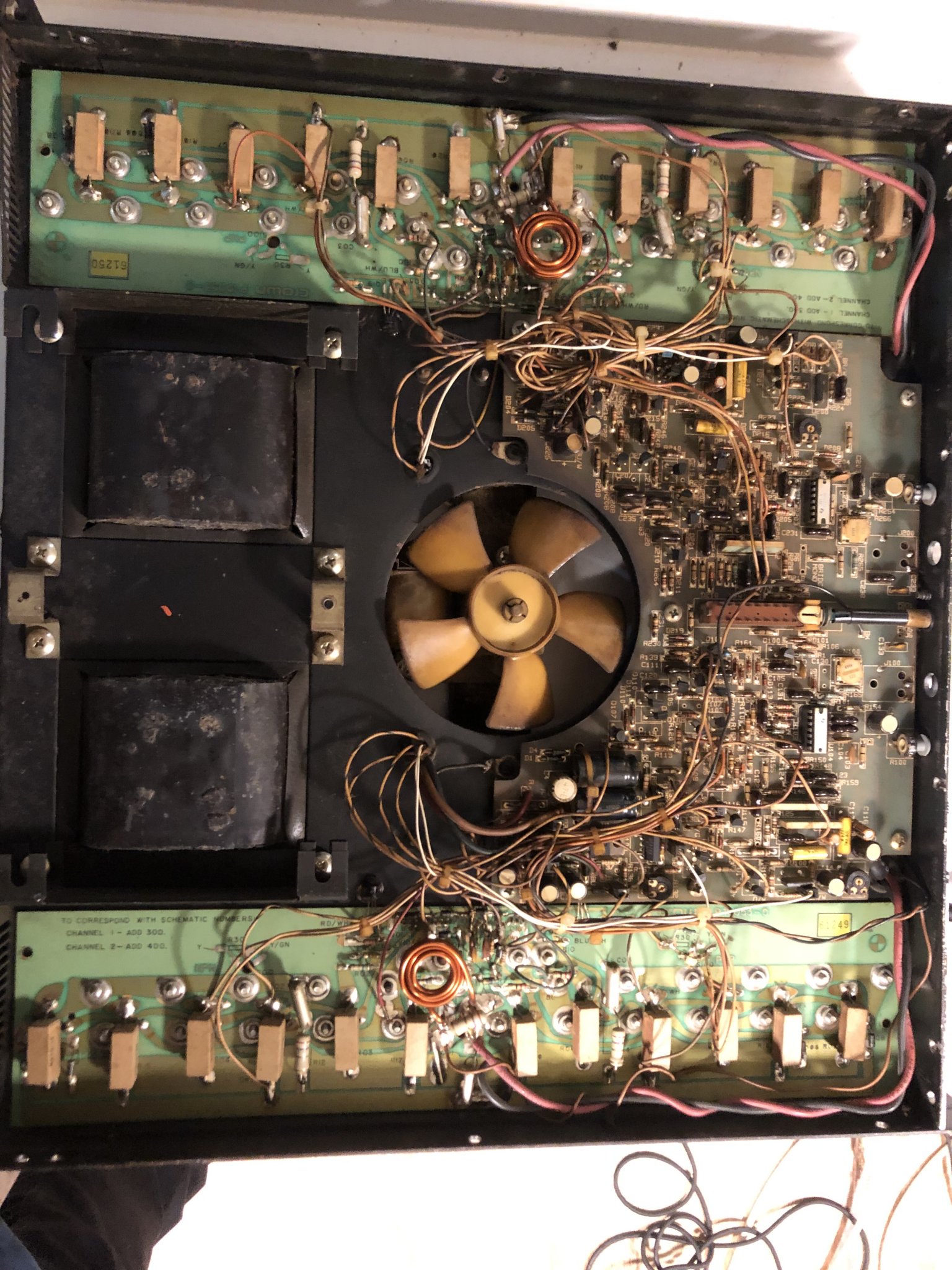

I'm working on a similar project, getting a MicroTech 1000 back to life. It's a really old one, branded as Amcron for the European market (I think it's near 30 years old).
I've already managed to get it back up and running, the FanFormer had problems starting up, causing whole lots of noice but no correct 15V circuit.
That I've resolved in the meantime.
I'm now going through tests, doing the measurements and configurations. There was working on similar as you guys are discussing, the ODEP an BIAS.
Using manual and diagrams, I've been able to set up the ODEP voltages correctly, however I'm having problems with the BIAS.
I can locate the corresponding R (3/4) 02 and R (3/4) 21 resistors and they measure off (200 and 400mV), so I need to adjust the potentio meters R (3/4) 21 and R (3/4) 23 to get them in the 300/320mV range.
It might be me...Maybe I'm blind... But I am unable to locate those potentios. They should be on the output board. Or are there MT boards without adjustable BIAS?
Board number is P-10053-O
Many thanks if you would be able to give me a hint 🙂
Regards Jan

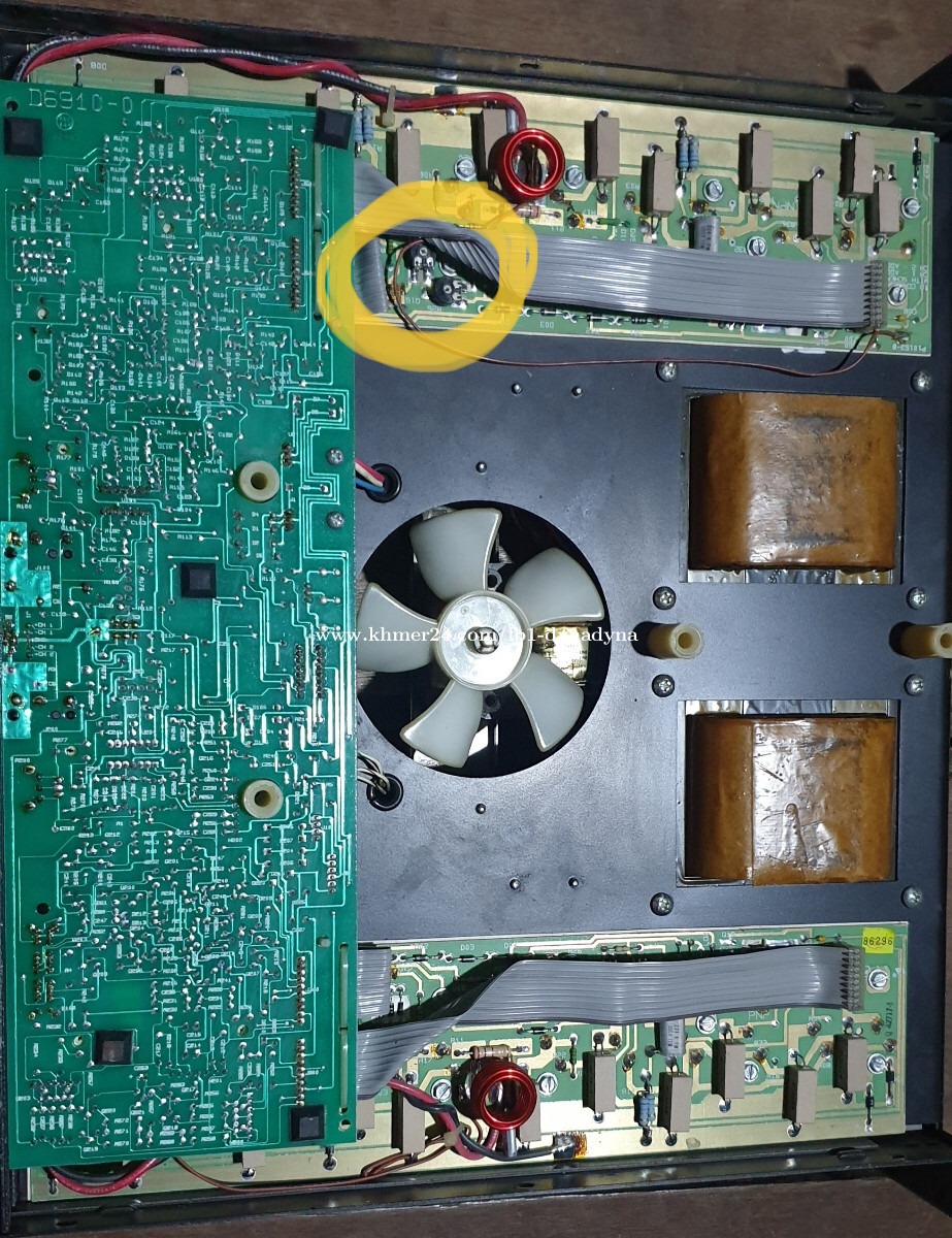

@JwBroumels trying to insert a picture from this iPad.. hopefully I get it correct showing the pots from the underside of the output board

Thanks for the reply @geoturbo ,
Looks like my MT has a quite different board.
A lot of the schema compares, but not all.
Attached a photo of the layout.
It looks sick, has been smoking 20 packs of sigarets a night for many years.
I’ve got it from a night club, where it had played 1993-2010 every weekend, without a failure. It was used as a “mid” amp only, so not much pressure.
There are several more I can get, but I wAnt to be sure I can get them back up and running.
I do believe they prove their strength. 30 years old, 12 years unused, and 3 hours of work, they seem pretty healthy again.
Hope this board makes some sense, as attached
