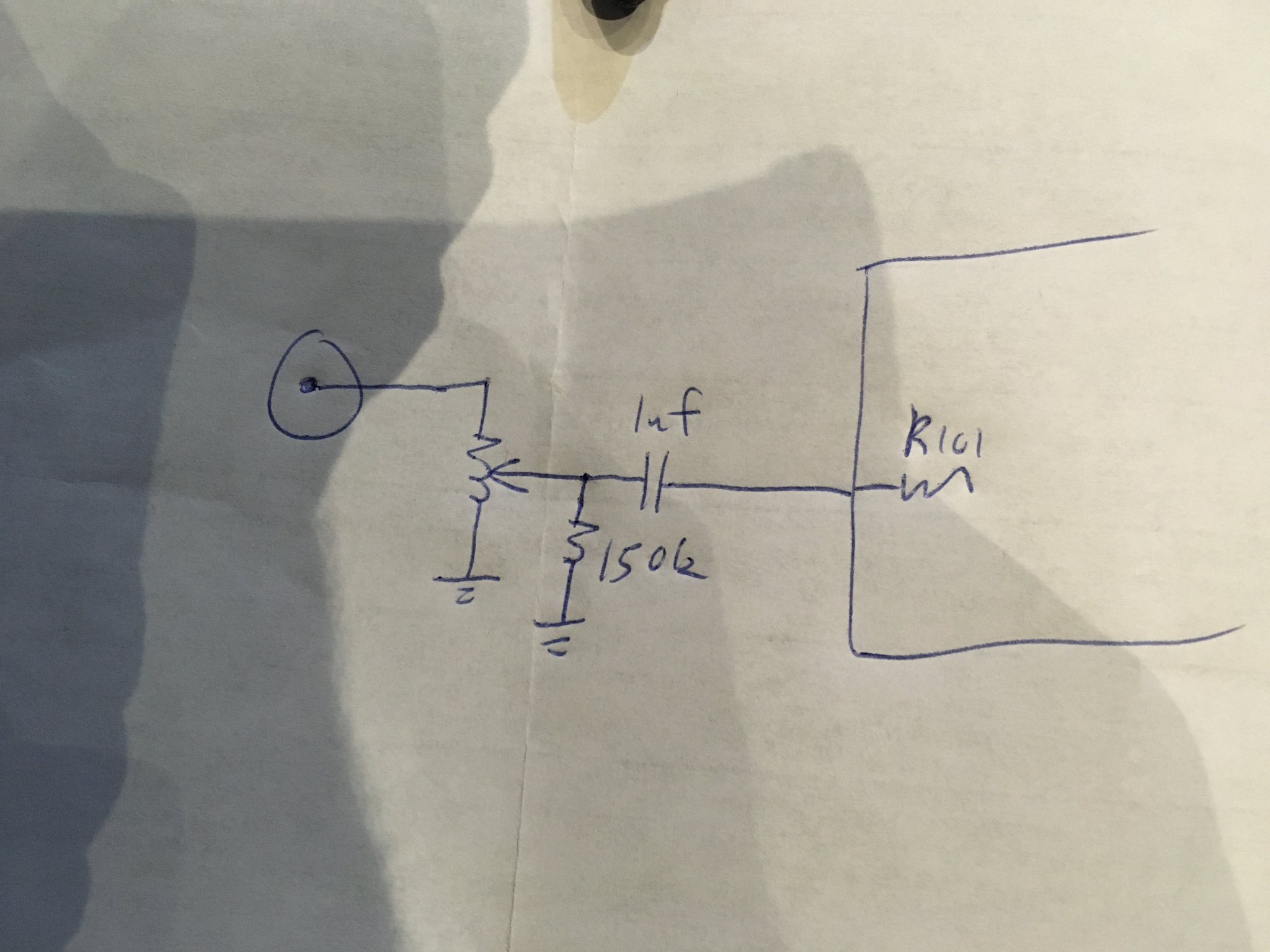

I've added an RC filter. After the gain control. 150kohm resistor to ground, then a 1uF cap between the gain pot and the board. Resistor is on the input side of the cap. Just in one channel for now.
I'm still using this on the DBT. Currently got a 200W bulb. When the caps discharge enough, and I power the unit on, I get a bright bulb and DC on the outputs. But if I power it on with the cap shorted, it is fine. And if I turn it on again before the caps have bled down it is fine. Maybe it would be okay off the DBT and this is just a weird reaction to the current limiting? But I don't want to damage anything again.
It seems this changed something the circuit wasn't expecting? Does anyone have an explanation? Should I do this differently?
Here's a quick drawing.

I suspect there is a small input offset error, so there is likely a turn-on thump: the added DC block cap passes current until it settles to the input offset error.
Try an experiment: set input gain to 0, and connect a clip lead across your blocking capacitor. When you lift the the ungrounded end of the clip lead, I predict you'll get a thump and a click/pop when you restore the connection. Try adjusting the input bias pot R103 to minimize this transient glitch. Once minimized, there's an output offset pot (R121) to trim output error.
Please let me know if this helps. Good luck!
Once the unit is on, shorting/removing the short on that cap has no effect.
When I turn it on from cold with the cap in place, I get DC to both speakers as well (with the DC blocking on only one channel). Forgot to mention that.

So if I understand correctly, input offset is already well adjusted. At power on, there's initially DC present at speakers but it eventually settles to near 0V, assuming output offset has been trimmed?
If this is the case, it appears that the initial DC error may be the nature of the beast, since output presumably settles to nominal as the amp settles to equilibrium over the course of several minutes. Does this sound like what's transpiring?
BTW, how large initial output error?
