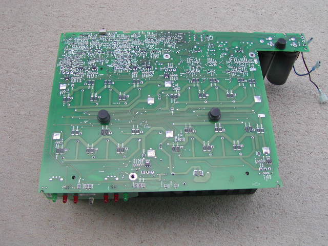

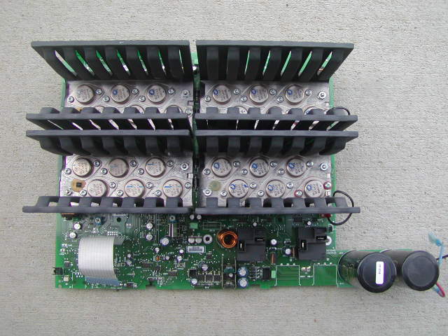

It must be the month for Crown CL2 repairs. I have in my possession (2) Crown CL2 amplifiers. Both have no positive waveform what so ever. Is the fan supposed to turn on upon start up and then turn off? I have no fan operation at all. Never played with one before. Any help would be appreciated.
I'll try again

Interesting photographs. Is it difficult to repair amplifiers with Surface Mount Devices compared to traditional devices and are the surface mounted Semiconductors easily obtainable?
Are these type of PCB's also more prone to having damaged tracks which cause the PCB's to be non usable? Please excuse my questions as I do not have that much experience with repairing SMD populated power amplifiers.
Thx
Had to bend the chassis in order to remove the board. Will have to make up some wire harness extensions in order to work on it effectively. Someone should be punished for designing something like this.:2c:
To answer your question.... for me this type of amplifier isn't repairable because I cannot deal with surface mount parts. My particular amplifier isn't showing surface track damage but I have seen it in the past on other amplifiers.
