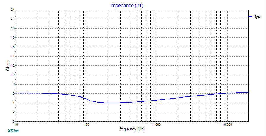

Peerless GBS-135F25AL02-04, with 4 ohm L-pad set to 0 dB attenuation (just happened to be a file I had handy):

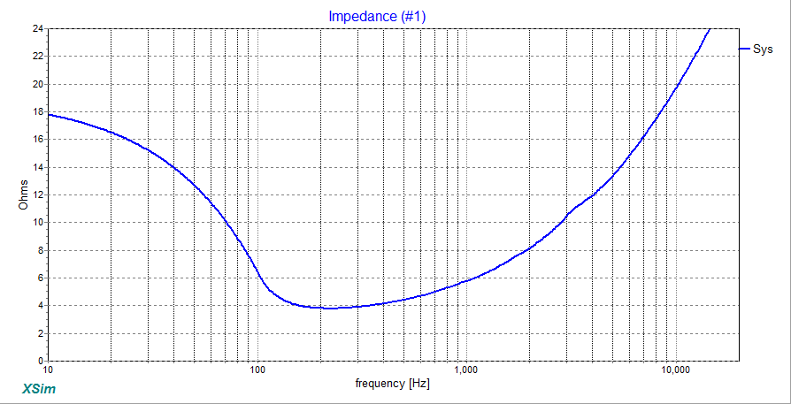

L-pad set to 5 dB attenuation:

Well, the design of an L-pad is a device that is made to present a true flat impedance to anything driving it.
Inside the L-pad are TWO variable resistors behaving in 'harmony' to maintain the constant intended value.
At full clockwise position, the internal resistors actually disconnect thereby directly connecting the tweeter
to the crossover as if the L-pad wasn't even there.
When the L-pad is dialed anticlockwise the internal resistors come into play.
Due to the purely resistive nature of the L-pad internals, any driver impedance variation is proportionally
reduced by the amounts of pure resistance introduced.
Another example is: If you use an 8 ohm L-pad in 'mid position' but connect a 4 ohm driver,
the crossover will see a load closer to 8 ohms than 4. This is how I would describe an L-pad as having a 'smoothing effect'.

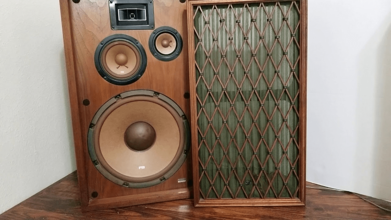

...I already have the speakers, so have to find a way to cross them over so they sound half way good. My cabinets are old Pioneer CS-77a's a friend gave me. The surrounds were all rotted and missing. I'm not sure what to do now. ...
Option/devil's advocacy: What about just a recone for the woofers? There are still plenty of people that like those--go poke-around on the speaker forum at AK. If nothing else, you can find plenty of threads on the CS-77A's. They're cool old cabs, and everybody would do something different. If you are itching to build, there are plenty of ways. If I have this straight, you have the new set of drivers so you could do a standalone project at least partially funded by selling reconed CS-77A's? Or you might like those and can let your new drivers move-on. My only input is to keep it fun.
I agree with AllenB. Though the impedance shift caused by the L-pad looks significant, the affect on frequency response is typically surprisingly small over a practical attenuation range, and the largest differences tend to be at frequency extremes where things are down enough in level that their contribution is lessened when the drivers combine.
Also, my impedance plot above has issues below 100 Hz. My data cut off there, so I'm not sure if XSim did some kind of prediction down there or what, but below 100 Hz is not representative of that driver. The predicted combined effect of the speaker/L-pad should be OK though.
