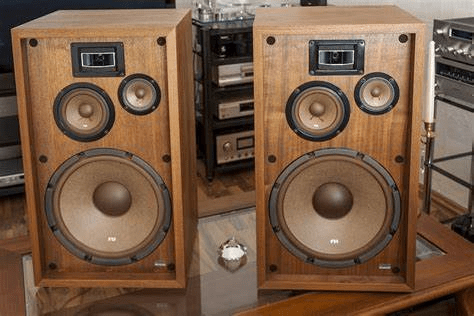

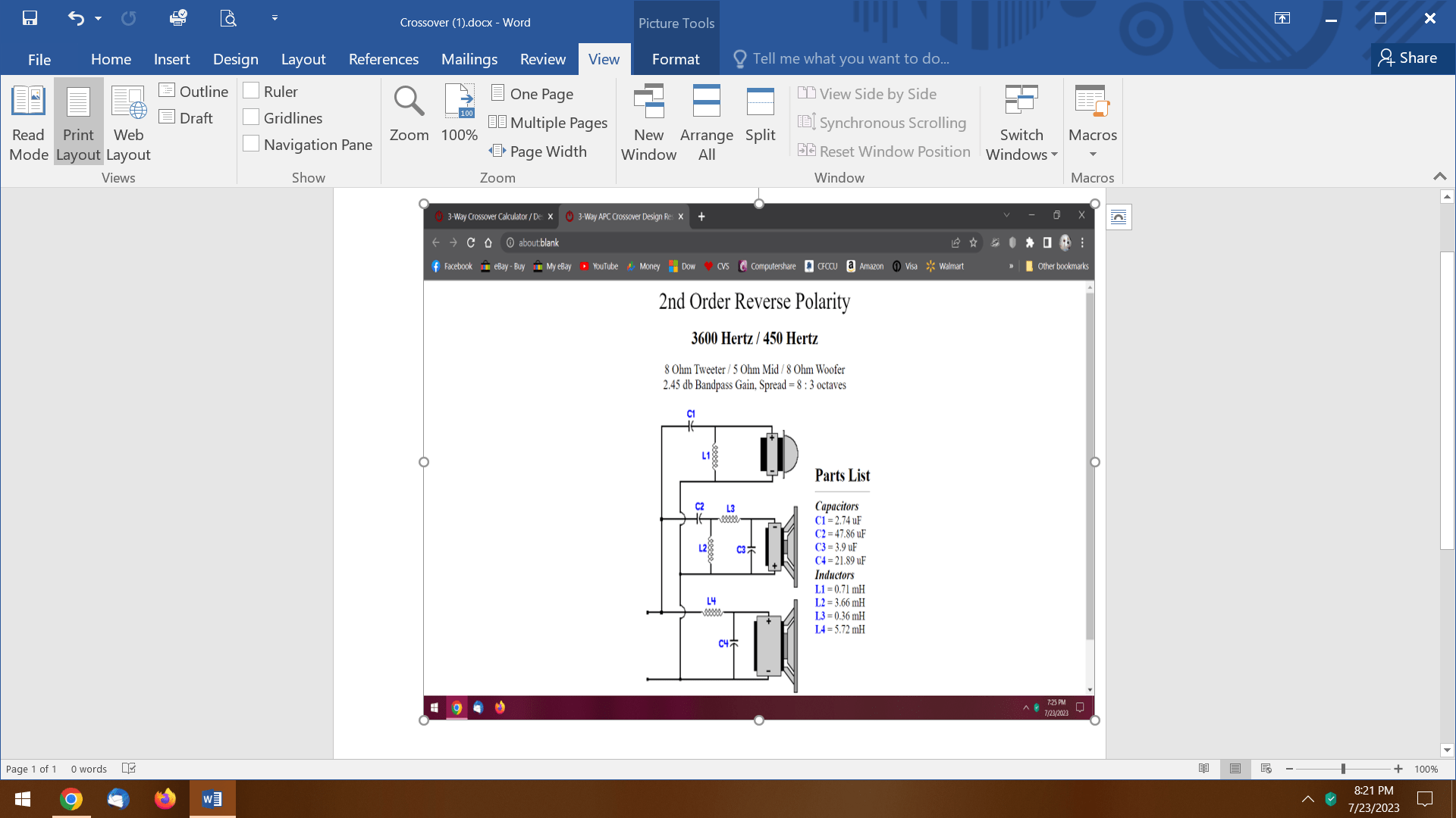

...I already have the speakers, so have to find a way to cross them over so they sound half way good. My cabinets are old Pioneer CS-77a's a friend gave me. The surrounds were all rotted and missing. I'm not sure what to do now. ...
Option/devil's advocacy: What about just a recone for the woofers? There are still plenty of people that like those--go poke-around on the speaker forum at AK. If nothing else, you can find plenty of threads on the CS-77A's. They're cool old cabs, and everybody would do something different. If you are itching to build, there are plenty of ways. If I have this straight, you have the new set of drivers so you could do a standalone project at least partially funded by selling reconed CS-77A's? Or you might like those and can let your new drivers move-on. My only input is to keep it fun.

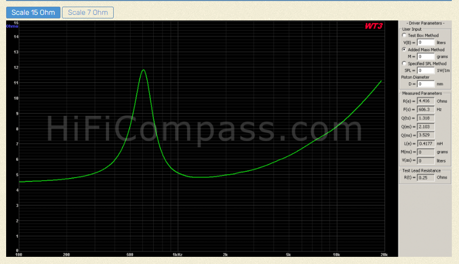

All changes have some effect, but an L-pad shouldn't be fundamentally changing the crossover frequency.so no go on understanding that an L pad on the secondary side of the filter will result on a shift of frequency
I agree with AllenB. Though the impedance shift caused by the L-pad looks significant, the affect on frequency response is typically surprisingly small over a practical attenuation range, and the largest differences tend to be at frequency extremes where things are down enough in level that their contribution is lessened when the drivers combine.
Also, my impedance plot above has issues below 100 Hz. My data cut off there, so I'm not sure if XSim did some kind of prediction down there or what, but below 100 Hz is not representative of that driver. The predicted combined effect of the speaker/L-pad should be OK though.
