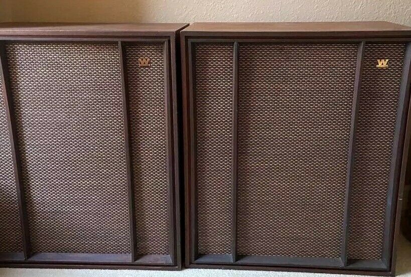

The speaker is a vintage design a Wharfedale W70 from 1966 that really shocked me as to how good it actually sounded, and that was with a very primitive xover - just a couple of capacitors and 2 L-Pads all of which are 54 years old , and at least from the L-Pads stand point are barely functioning.
-- I had read about the Wharfedale W70's , W90's and the SFB-3 speakers and I was really interested in the SFB-3 which was their answer to the Quad 57 that had just come out about that time -- ( their goal was to make a speaker that could sound as good as the quad but be much more dynamic )... so I wanted to try the SFB-3 but it's more rare and a lot more money than the other two , so I decided to go easy and try the smaller version - the W70 and that way not having to invest to much money to find out if I agreed with what people thought of the sound quality of the speaker design. So I got lucky and found a pair of the W70's locally in very good cosmetic shape for their age and only paid $200 for them. And well --- they actually really did sound very good! So along with replacing the crossover and L-Pads, I have some other ideas about how to go about taking them to the next level after that too.
--- Here is a picture of the speakers , unfortunately this is before I cleaned them up - they were very dusty and dirty. I also want to refinish them ... and maybe add new veneer too - we'll see .... 🙂
https://i.ebayimg.com/images/g/eVYAAOSwQXZeTwJi/s-l1600.jpg

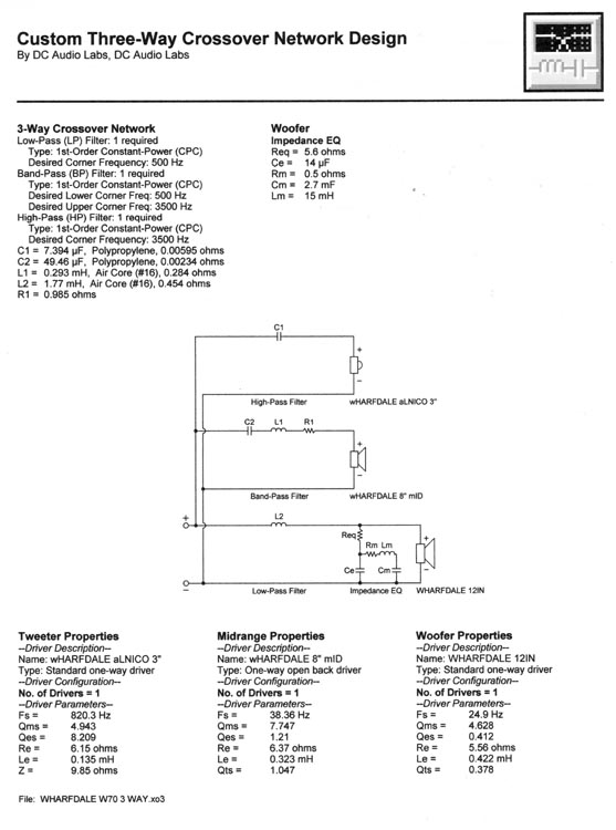

---- And here is one of the more modern but simple crossovers I want to try ---
http://www.cyberbilly.com/chicken/W70038.jpg

Ignore such comments, you've got a bit of loudspeaker history there!Iv'e gotten a few comments about why waste my time with a very old design that doesn't probably come close to today's speakers . . .
So, you are looking at a published, custom crossover design for the W3 - that is most helpful information.
I fail to see why the capacitor, inductor and resistor values have to be so precise given that your loudspeaker drivers will have aged differently from those of the person who designed the custom crossover.
Choose components whose standard values are close to those listed and don't get anal about the whole sheebang!

Alternatively, there's a lot to be said for renovating the crossover as it was originally designed, simply by substituting modern polypropylene capacitors.
This would preserve/enhance the vintage sound and prevent Wharfedale founder Gilbert Briggs from turning in his grave! 😉
I believe that Wharfedale used 50 ohm potentiometers and these could usefully be replaced with modern 8 ohm variable L pad controls.

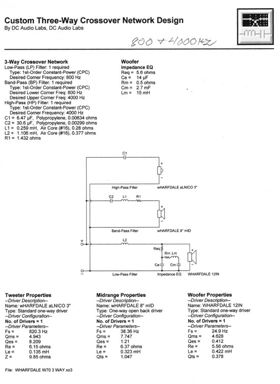

- Sorry for the commercial break ... Here is the second crossover ... it looks very close to the other one as far as the number of parts , but it looks like each part value is just a little different.
http://www.cyberbilly.com/chicken/W70039.jpg

- Anyone have an opinion on which which crossover is the one they would try - is there to tell from the Thiele- Small Parameters which would be best? I'm guessing that the the difference is at what point each driver is crossed over at is the difference - it doesn't appear to this Newbie that much difference in the basic design - as in 1st, 2nd , 3rd order -- that part seems the same .
