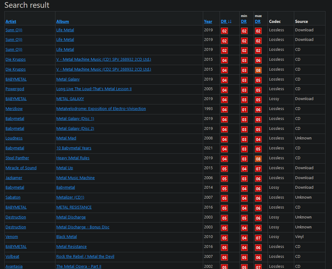

Another clue you don't get some of the reality of the job: all genres aren't the same and some require low dynamic range. It's an aesthetic requirement.
(Extreme) Metal, dance related electronic music, Hip Hop derivative, etc,etc, all require this as without high compression they would not sound the same...
The real issue with low dynamic range is when it's applied to genre unsuited to this.... which is the issue with loudness war: it doesn't make sense to have 6db dynamic range on jazz tracks or classical.
The list you give is an example, but given your taste i doubt you would listen to Babymetal ( i don't!), Die Krupps or Sabbaton anyway.
Baby Metal could have higher dynamic range, the wall of sound of Sabbaton would not sound the same with higher dynamic applied and Die Krupps would probably not benefits of an higher dynamic range either given what industrial is. ( i'm more into industrial than heavy/power metal as a musician but work(ed) in both style as a technician as well as many others requiring different approach to dynamic range applied to them ( including classical related music).

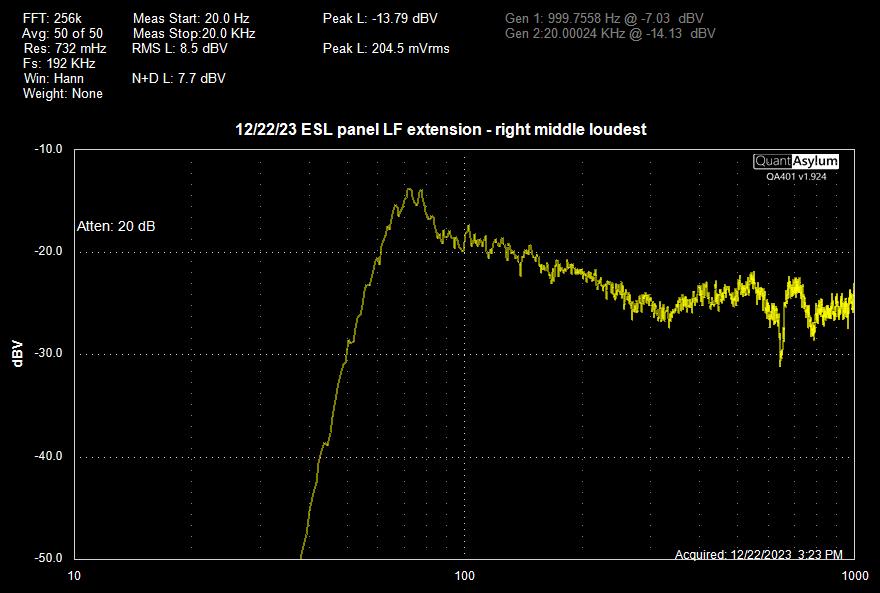

I think describing my system might help. It's 2.8 and is an earnest attempt at a ray generator for the highs and a wave generator for the lows.
Highs: Cylindrical radiation pattern (Beveridge 2SW-1 on the side walls)
Lows: Eight identical powered subs scattered all over the room
Correction loop: Dirac Live
So my soundfield has two really different 'shapes' or cubic geometries, one above & one below crossover.
I have a miniDSP SHD and up until 2 weeks ago I was running 2.1; all 8 subs shared a mono signal. But I've added a Flex Eight to the bass path and this will hold MSO cals for each sub individually. Should be fun but suddenly it's control loops inside of other control loops and so on.
Beveridges don't go deep, I've mapped power bandwidth vs. drive level (using white noise) and a conservative crossover frequency for headroom is 80Hz. At lower volume they make it to 60Hz but it pulls in when you drive them harder. An 80Hz stonewall is indicated here, I'm using LR48 slope.
The natural high frequency rolloff in my subs is 12dB/oct starting at about 140Hz. Listening tests have strongly told me this natural rolloff sounds great and restricting sub bandwidth any further reduces the sense of a solid central image - the sound moves away from the center of the room and retreats to the sides, if that makes sense.
Conclusion: Fine tuning woofer highpass has a profound, profound effect of the 'curtain of sound' drawn between the two speakers.

Here's what the low end of a Beveridge ESL panel looks like. This is a 2SW cabinet, an original Model 2 should tune different.
This measurement was taken loud, a few dB above my usual listening level. The drive signal is white noise known flat down to 10Hz. A 2KHz stone wall has been applied to this drive signal to be merciful to my electrostatics. The microphone is a 1 inch calibrated by CSL, it also is known flat. Mic was nearfield up against the lens foam. When I drop drive level 10dB the peak shifts left to about 60Hz but the shape hardly changes.
The problem with a gradual crossover slope is it forces me to throw away some of this energy. It can not turn my steep rolloff into a gradual rolloff. It can only mask my steep rolloff by overlaying a gradual rolloff that is tuned much higher, and the region between those two curves is "ray generator magic" right a critical region of the spectrum and I freakin' want it.
So I 100% take your point but I think some of these exotics are so shy of power bandwidth & SPL that the real world gets in the way. Does that make sense?
