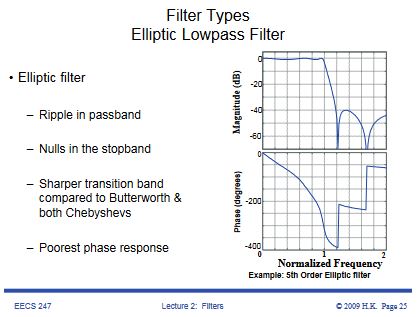

I don't know where you got that transfer function for an elliptical filter but it doesn't look in any way to what i've seen used on cuting lathe we used to have track s cut ( Neumann VMS most of the time, can't remember the module reference of elliptical filter in Neumann range but itwasn't a Chebyshev or anything exotic at all) neither the one i applied at mixing stage expecting what the Mastering Engineer will have to perform anyway ( which were most of the time an MS matrixing with filtered Side with a 1 or 2 pole hp filter to keep thing simple and under management as well as easy to recall in case the ME aslked for something different).
https://inst.eecs.berkeley.edu/~ee247/fa09/files07/lectures/L2_2_f09.pdf

Chris, thank you for the link. 5 or 6 pole Elliptical filter is to my knowledge never used. Might be an experimental thing, lab works, whatever, but not what was used in practice, on real life cuting lathe i've seen.
I found some reference to the Neumann modules i've seen used, those were Neumann EE66/EE70/EE77. 6db/octave ( 1pole). First two one used tapped inductors, 77 a switched RC network. Neumann had other ref like VAB84 but i do not know much about them, i would be very surprised if they were different though.
The most steep i've seen or used were ( are) 2poles hp. Not something that would render such anomaly in phase i'm sure you'll agree.
You talked about phase issue in the Schroeder freq range and the culprit being elleptical filters on many recording you treated.
I doubt about your conclusions ( but not your observations): one of the first and foremost role of premastering treatments ( audio treatments realised during a mastering) is to ( try) to counteract the issues related to acoustics of control rooms were mixing took place.

You talked about phase issue in the Schroeder freq range and the culprit being elliptical filters on many recording you treated.
There is often issues in the acoustics in the freq range you mentioned requiring ( sometimes) heavy eq treatments to compensate. I would rather take a look at this as a culprit of what you observed rather than an hypothetical issue with 1pole hp treatments occurring on side signals.
This was my intent--to highlight that I've empirically seen problems (many times) in as-produced music tracks that are correspondingly right on top of the same frequencies that we're talking about. That was in fact the point I was discussing and was attempting to bring into the discussion--that the Schroeder transition band has been a large problem in recorded music--mostly due to the small size of the mastering rooms used, and the monitors used that have no real directivity control below ~500 Hz, and as high as ~1500 Hz. Using a mastering control room that's been completely treated 100% by absorption squares in no way makes up for this deficiency in the monitors themselves, and in fact, displaces your comment about "average", above.
