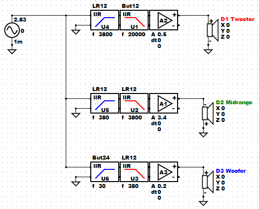

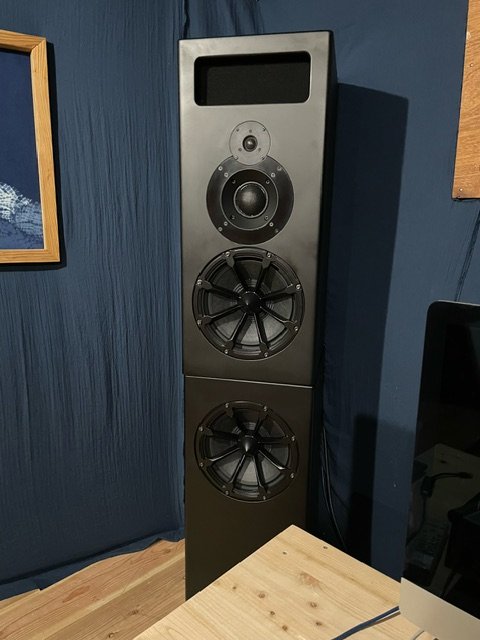

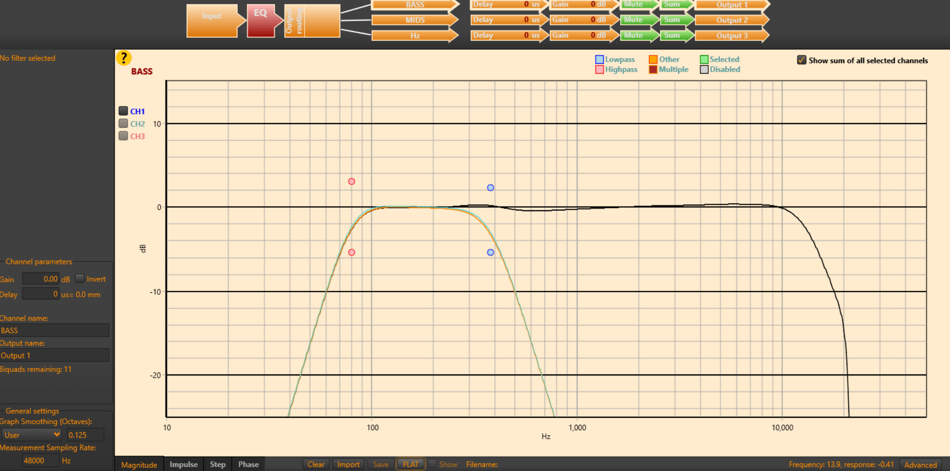

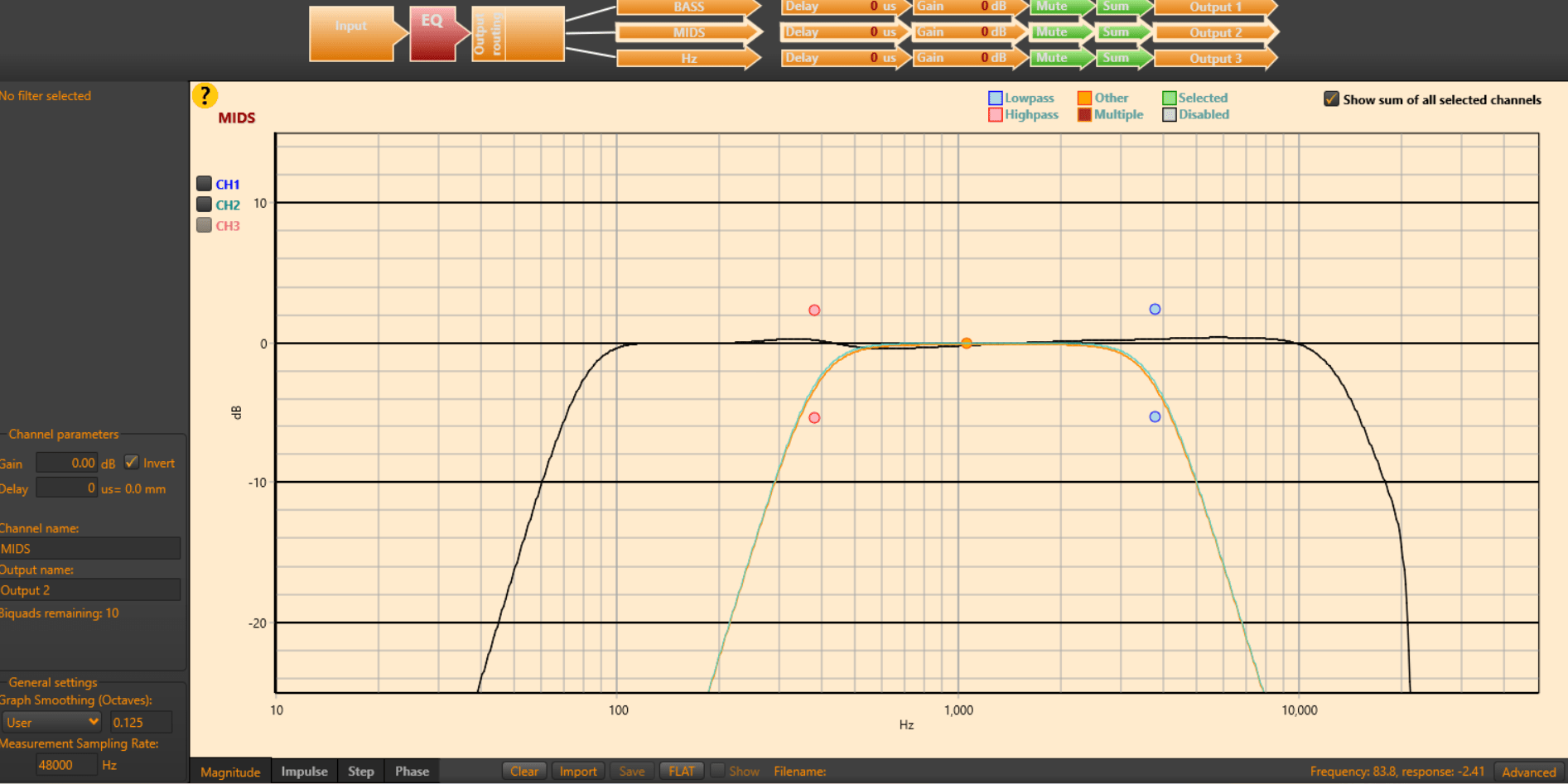

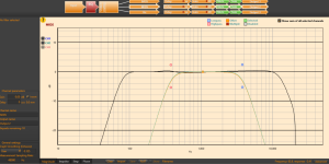

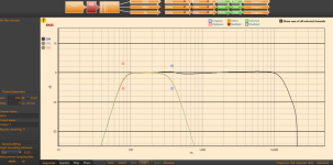

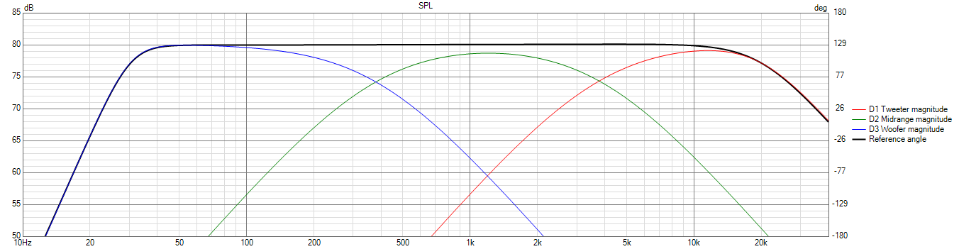

Hello everyone I recently finished a studio monitor project and i am struggling to find the crossover points of the PMC mb2s Xbd monitors witch my monitors are deigned around. I am using DSP Hypex amps to model the filters . But would be great if i could find out the original frequency's of the PMC speakers .
thanks..
thanks..
Hi speakerBob, PMC was one of the first places I checked. My original information on the build was from DiyAudio and everyone has been most helpful over the years, and this last bit of information would finally get me over the finish line. I did at one point directly email PMC but naturally they were not very forthcoming . All the very best Bob

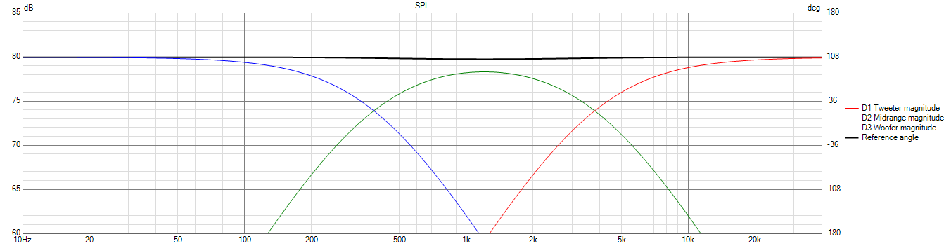

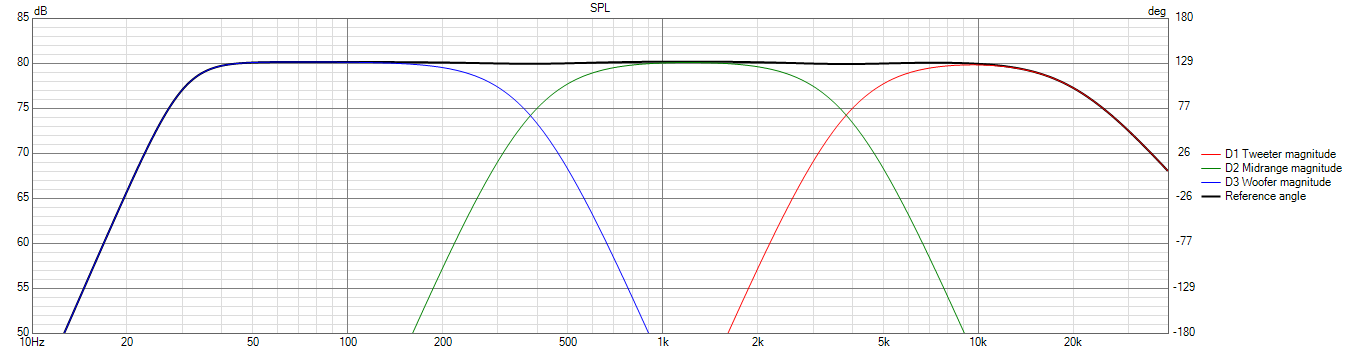

Thanks BoB but I was looking for some sort of visual frequency graph to copy that into my filters. excuse my ignorance , I am grate with hands construction but totally useless when it come to this side of the work.. With the 4 way crossover system i have just started with the speakers manufacturers infomation .. Thats as far as ive got.. Thanks again.

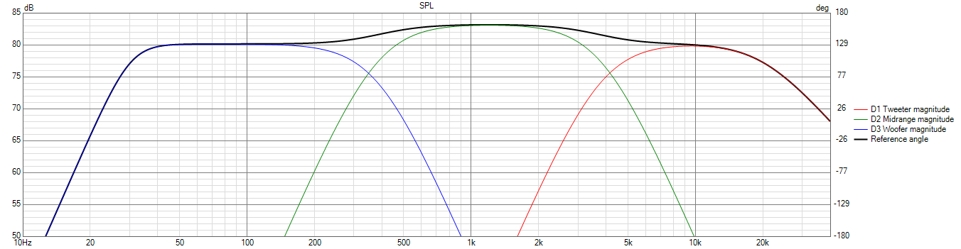

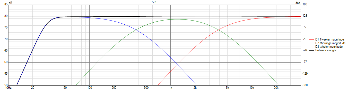

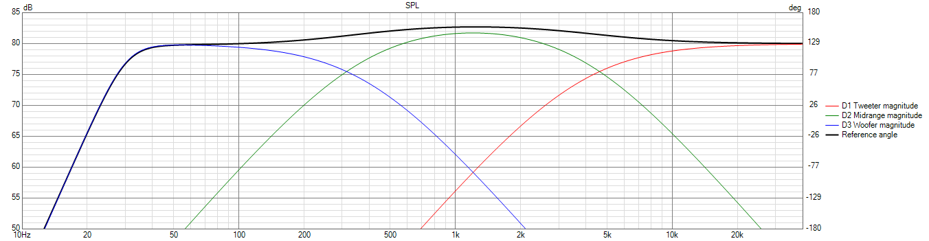

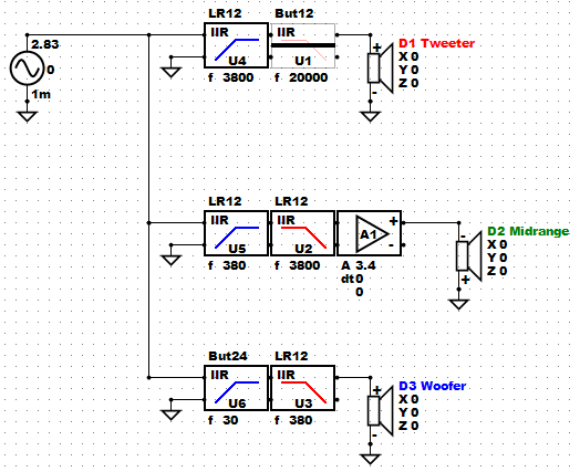

Is this the sort of graph you are looking for? This one is comprised of Linkwitz-Riley filters: a 2nd-order LP filter on the woofer section, a 2nd-order HP filter and 2nd-order LP filter on the midrange, and a 2nd-order HP filter on the tweeter. Note that the polarity of the midrange driver is reversed in order to get the correct summation to a flat response. The crossover frequencies are chosen to be 380Hz and 3800Hz, and the summation (black line) is quite flat. Of course, the natural frequency responses of each of your drivers will come into play, but hopefully this will help to get you started.

You have bought an excellent set of drivers, I have heard PMC's they were extremely good. (powered by Bryston amps)Thanks BoB but I was looking for some sort of visual frequency graph to copy that into my filters. excuse my ignorance , I am grate with hands construction but totally useless when it come to this side of the work.. With the 4 way crossover system i have just started with the speakers manufacturers infomation .. Thats as far as ive got.. Thanks again.
You owe it to yourself to buy a measuring mic and work with actual graphs from the speakers you have put all that hard work into.
Bob.

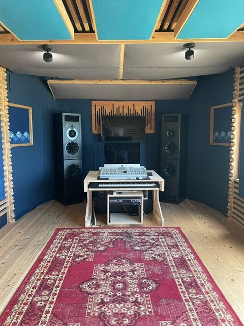

Hay once again thank you all and "Bob" so much, its reassuring that there are people here to help , Ive stated the crossover filter work and the results are very promising at the moment. The drivers are absolutely spot on , the only thing letting them down is me . But sounding good at the moment, im sure ill be tweaking for the next few weeks.
. I have sound id sonarworks Bod so ill be using that once i streamline my room more . I will send link so you can check out the audio once ive finished ..
Hi, so I have a bit of a frankenstein set up , for the 3 way i am using 2 Hypex 503 and for the subs lab gruppen ipd 1200 witch has the DSP , i am using one of the Genelec sub settings and tweaking that between 80 and 30hz although Volt say 27hz .. Ayway once things are up and running ill pop back and send you all a link so you can give me some feeed back.. Many ThanksThe Harrison site says ACCURACY ± 1% @ 22KΩ LOAD. That's because the crossover frequency of the passive FMods will change due to the load splitting between the monitor amp and the sub amp.
