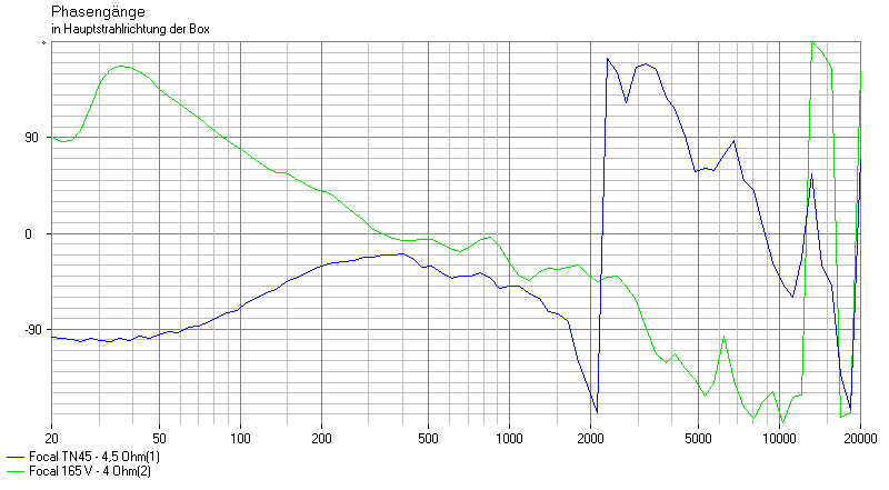

The TN45 is a 4,5Ohm and the TN47 is a 6,9Ohm, but the xover I designed works well with both (adjust). Now, with this tweeter (look at Fs=2K4) you need to be careful not to cross it lower than the 4Ks. You adjust intensity with the Lpad attenuation R1/R2.
Your xover has a (few) big mistake(?), note the inversion of the phase of the drivers, on the xover I showed you first.
I just saw the inversion why you do this ? can you explain me plz .

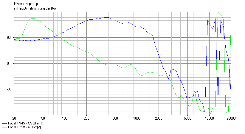

In a xover 2.order phase is shifted 180º like in pic.1. So you need to change phase in one of the drivers to have same phase like in pic.2 at xover frequency ~4KHz.
