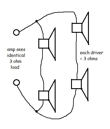

Can I power 4 of those small speakers from 1 channel on the alpine? - and how would I do that...
My simpleton monkey brain is telling me split them into 2 groups, of two speakers.
They are each 3 ohms, so I'm thinking wire two 3ohm speakers in series to make them 6 ohms,
and then repeat that with the other two and connect them all to the same channel.
So the amp would see 6 ohms, I think.
I am not sure is that right, or will it destroy my amplifier.

On the subject of 4 small speakers on one amp channel: Wired the way you described would present the same load to the amp as would one speaker. Each one gets one-fourth of the power, so altogether they can accept 4 times more -- even though the amp doesn't know the difference between that and a single driver.
