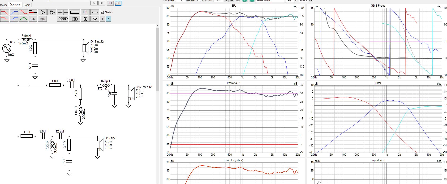

Crossover mods needed for Seas Classic 3 Way w/ driver changes?

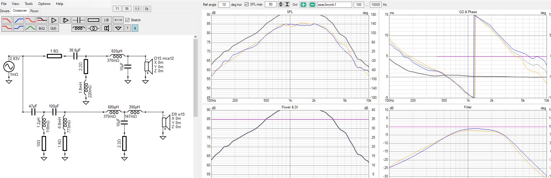

Here's the W15 bandpass. It was a lot trickier to trace the MCA12 curve, and maybe it can be done more simply.
Observations:
-mid is inverted as per Troels
-don't recognize the filtered slopes as particularly close to any textbook shapes; just have to trust the differences come from baffle step and diffraction, which I don't know how to verify using this approach
-attenuation resistor was removed for W15 to match filtered amplitude of MCA12
-W15 needs 4th order electrical HP and 3rd order electrical LP to match MCA12 filtered slopes
-there's a small peak on the W15 around 5k - might need a notch filter
-so I agree with the concern that by not doing a native design bespoke for the specific driver, you're perhaps precluding a simpler crossover
-then again, the overall transfer function does seem to be able to be replicated

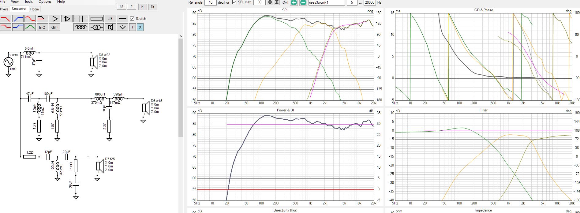

Moment of truth:
Original XO and transfer function, summed response:
Refitted XO with W22 + W15 Nextel + T25 Millenium:
Quite close! Probably can be optimized. But hmm, looks like this would work as a starting point, and overall it should sound similar to the original.

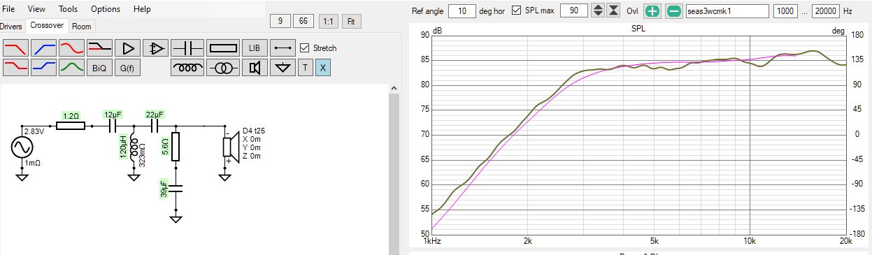

The Millenium can also be swapped for the T25CF001 -- might address the recess near the XO, but I need to take another break!

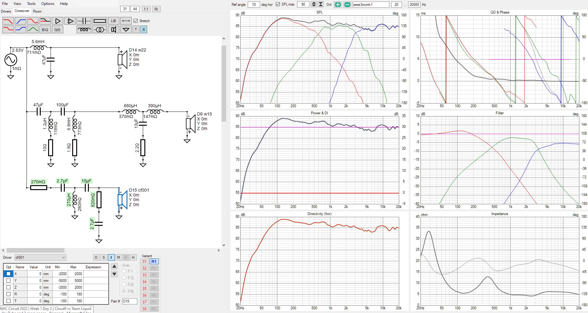

Swapped in the T25CF001. It tracks the T27 curve easily, but there's still a final response wrinkle around 6.5khz where one may need to just optimize it separately, ditching the original curve from here. Impedance also looks smoother with the CF001 instead of the Millenium. I think it'd be a good choice.
I also learned how to use a target curve by creating SPL files from the original XO per driver; attached below with the T25CF001 FRD and ZMA.

Some good work shown here motokok.
The W22 reaches 89db at 120hz vs 87.6db for the CA22 - is attenuation needed or do you go with it for the new system?
Either you force the woofer down, or you bump up the target curve by the needed dB. In that case duplicate and increase the tweeter level as well, and alter the tweeter crossover to that target.
The W22 doesn't have the breakup peak of the CA22 at 2.8khz.
The breakup region can have axial differences which don't show on a response plot. Fortunately the aim is to cut the breakup region out anyway, and the response is down. The drivers are the same size so it happens around the same frequencies and what you see shouldn't be unexpected. Looking at phase, the response peak hasn't taken it for too much of a ride.
The W22 doesn't need the parallel resistor to track the curve on the downward slope
