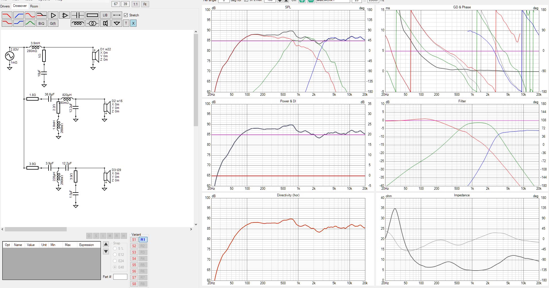

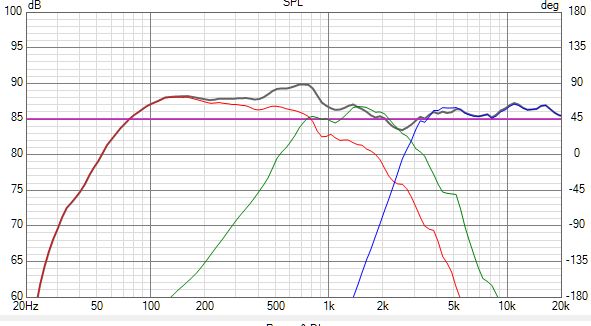

Here's the W15 bandpass. It was a lot trickier to trace the MCA12 curve, and maybe it can be done more simply.
Observations:
-mid is inverted as per Troels
-don't recognize the filtered slopes as particularly close to any textbook shapes; just have to trust the differences come from baffle step and diffraction, which I don't know how to verify using this approach
-attenuation resistor was removed for W15 to match filtered amplitude of MCA12
-W15 needs 4th order electrical HP and 3rd order electrical LP to match MCA12 filtered slopes
-there's a small peak on the W15 around 5k - might need a notch filter
-so I agree with the concern that by not doing a native design bespoke for the specific driver, you're perhaps precluding a simpler crossover
-then again, the overall transfer function does seem to be able to be replicated
Observations:
Here's the T25 Millenium swap:
Observations:
-tweeter is inverted as per Troels
-even with its reduced sensitivity, the Millenium can still match the T27's filtered amplitude
Observations:

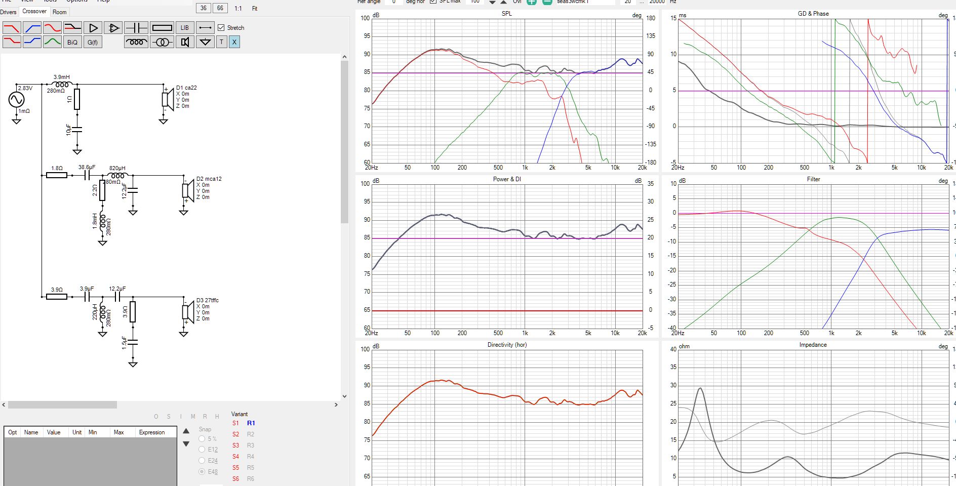

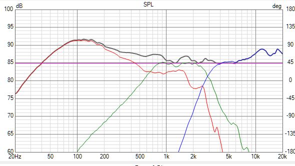

Moment of truth:
Original XO and transfer function, summed response:
Refitted XO with W22 + W15 Nextel + T25 Millenium:
Quite close! Probably can be optimized. But hmm, looks like this would work as a starting point, and overall it should sound similar to the original.
The Millenium can also be swapped for the T25CF001 -- might address the recess near the XO, but I need to take another break!
Swapped in the T25CF001. It tracks the T27 curve easily, but there's still a final response wrinkle around 6.5khz where one may need to just optimize it separately, ditching the original curve from here. Impedance also looks smoother with the CF001 instead of the Millenium. I think it'd be a good choice.

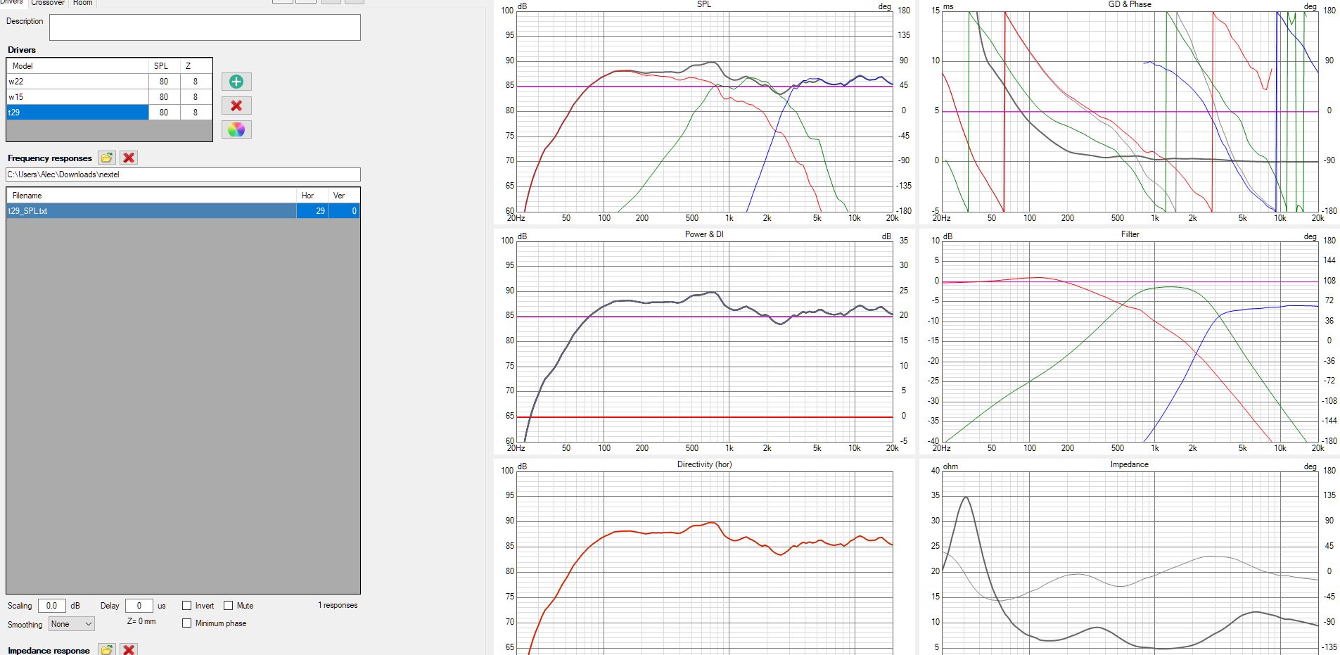

I also learned how to use a target curve by creating SPL files from the original XO per driver; attached below with the T25CF001 FRD and ZMA.

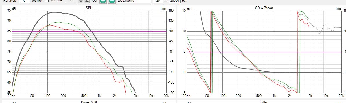

Some good work shown here motokok.
Either you force the woofer down, or you bump up the target curve by the needed dB. In that case duplicate and increase the tweeter level as well, and alter the tweeter crossover to that target.The W22 reaches 89db at 120hz vs 87.6db for the CA22 - is attenuation needed or do you go with it for the new system?
The breakup region can have axial differences which don't show on a response plot. Fortunately the aim is to cut the breakup region out anyway, and the response is down. The drivers are the same size so it happens around the same frequencies and what you see shouldn't be unexpected. Looking at phase, the response peak hasn't taken it for too much of a ride.The W22 doesn't have the breakup peak of the CA22 at 2.8khz.

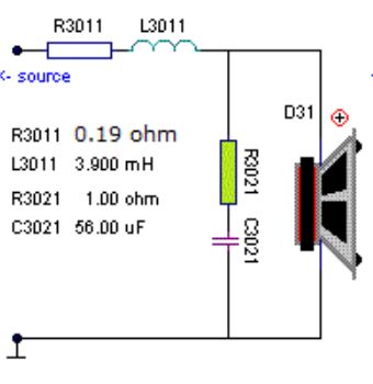

No problem.The W22 doesn't need the parallel resistor to track the curve on the downward slope
Thanks, @AllenB! I hate manual SPL tracing but I learned a lot from this exercise, and I think the 3WC is a very cool, public DIY design.
I think I'm done with modelling for now. Would you mind giving your perspective on some of the objections to the OP's design intentions here? Specifically, the worthiness of replicating transfer functions in simulation?

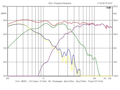

Yes, that's good modelling work by motokok but I think unfortunately the underlying assumption behind it is flawed.
In matching the responses from 1 set of drivers with another we are assuming that the differences between the measurements in the spec sheets and the measurements in the real world for each set of drivers is more or less the same. Or to put it another way, we are assuming that the 2nd set of drivers has exactly the same discrepancies between spec sheets and real measurements in their FR's and impedances as the original ones which, even though the drivers are all from the same manufacturer, is an idea that may or may not be true but more than likely not. So still a bit of a shot in the dark in other words.
Staying solely in the realm of modeling, you might be better off if you can find pre-existing builds with on baffle measurements using the upgraded drivers and then work backwards from there, subtracting out the baffle effects to obtain more accurate real world measured FR's and maybe Z's too that can then be
used to model the new design after the original.
As another suggestion, if the OP might be willing to learn how to take accurate measurements, then there are any number of competent people here who can take those and do the xo simulation work for you which should give you the best results.
