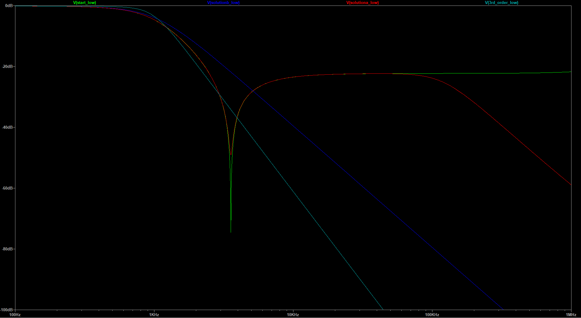

Here are some different solutions.
1) If you remove LF_C1, you will get a 12dB/octave low pass (blue plot)
2) If you put a 2µH 2Ohm coil in series with LF_C1, you will get a quiet similar curve with higher impedance above 100kHz. (red plot)
3) Is a 3rd order Butterworth lowpass filter with f(r)=1kHz. (I don't like third order lowpass filters for 2way crossovers, cause the inductance of the woofer voice coil is higher than the inductance of the second filter coil, and in my opinion, the second filter coil is mostly useless) (cyan plot)
The design of this crossover got it's benefit with a steeper rolloff between lp transition frequency and parallel transition frequency(green plot). But why should you burden your woofer with frequencys above 5kHz?

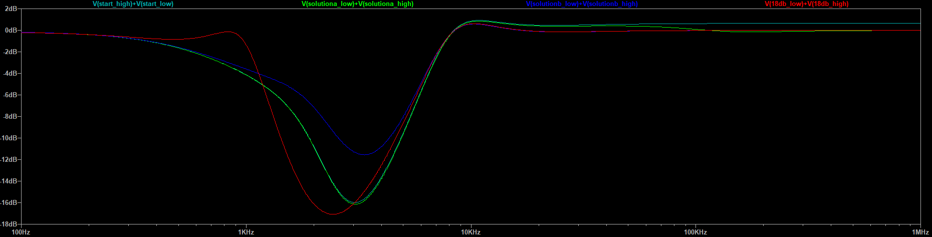

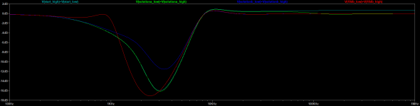

The second plot shows the complete crossover designs
original design (cyan)
2µ 2Ohm design (green)
without LF_C1 (blue)
3rd order lowpass (red)
I think, that solution 2) (additional coil) is worth a try, cause it got a similar characteristic without the high frequency problems.
