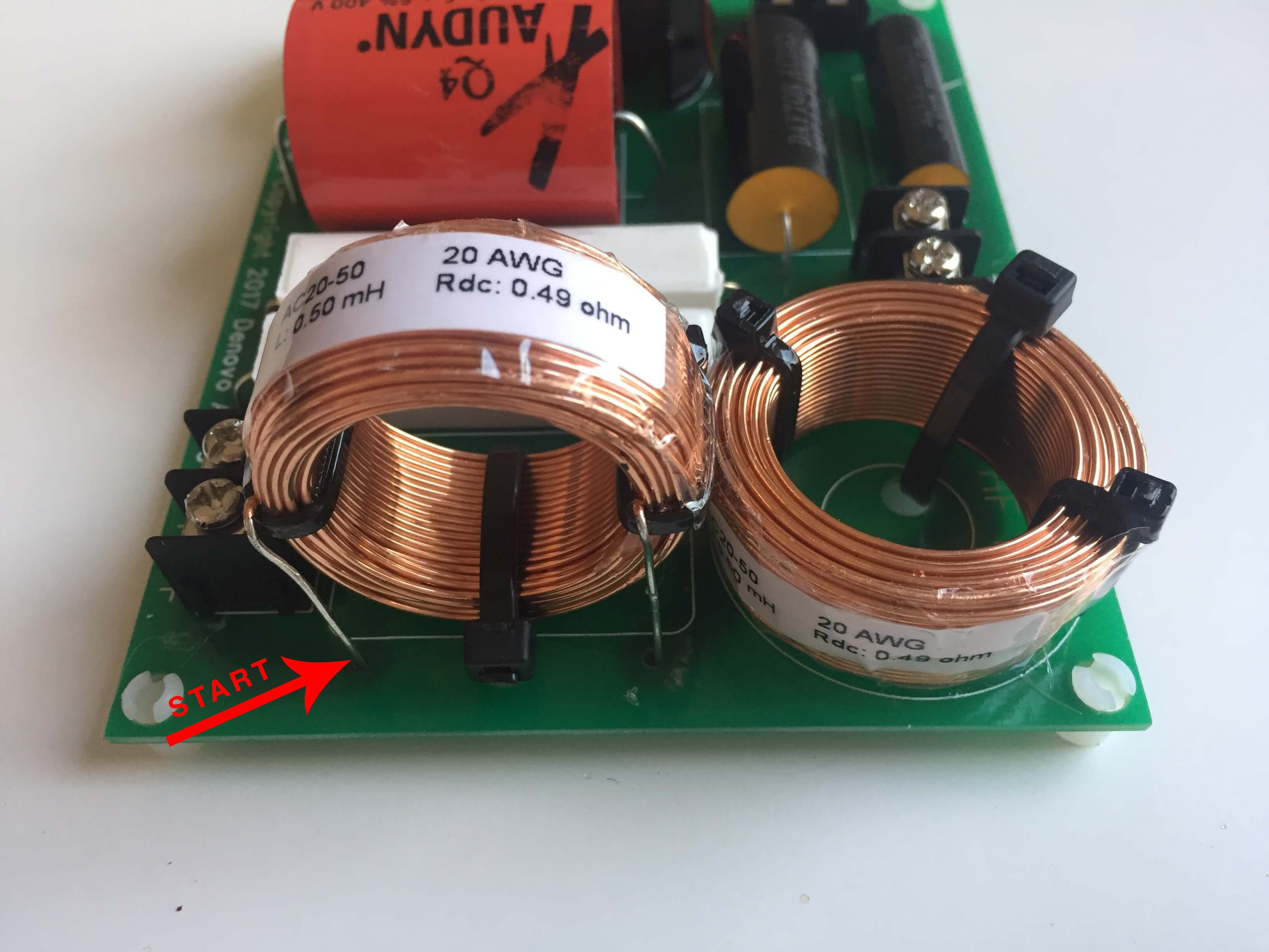

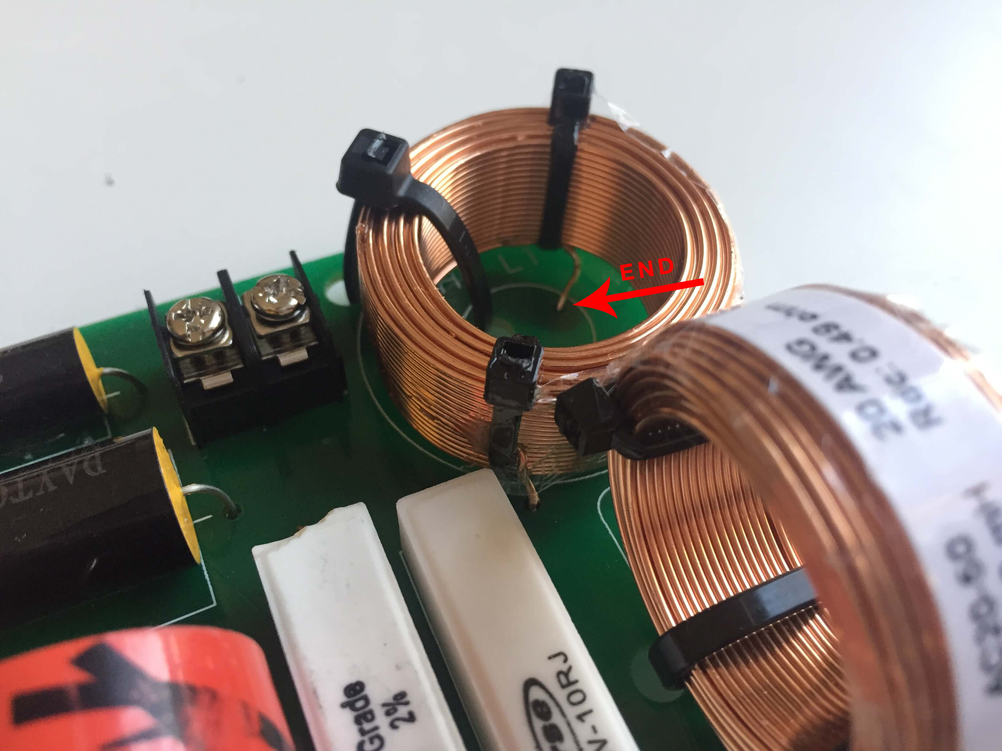

There was a time when I had zip-tied down a coil, and the ratcheting of the part to the board allowed the urethane on 2 places of the coil to rub and short out. It is possible that the coil in the tweeter spot might be doing this. This could look like a short to the amp.
Later,
Wolf
This might be a point. In this case, each coil on itself would still measure 0.8 ohms and seem OK, but the short wrecks the operation. The test for this could be a resistance measurement between the end of one coild and the end of another coil.
Jan
Tried measuring now. Still get 0.8 ohms for both boards.
Just to make sure, I've attached pics of where I measured:

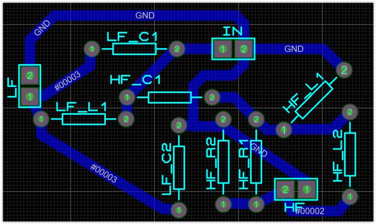

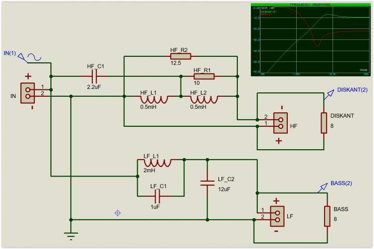

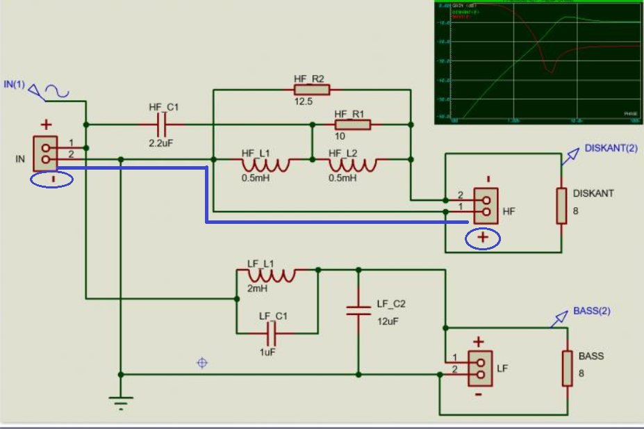

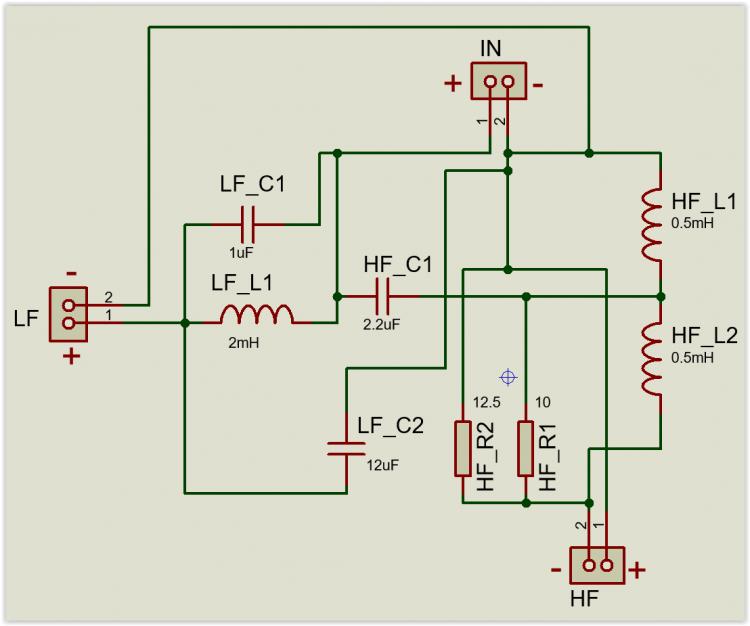

See attached pics. Pretty sure its correct.
First is board layout.
Second is schematic based on board layout.
Third is re-arranged to make it easier to read.
Hope that brings some value!
