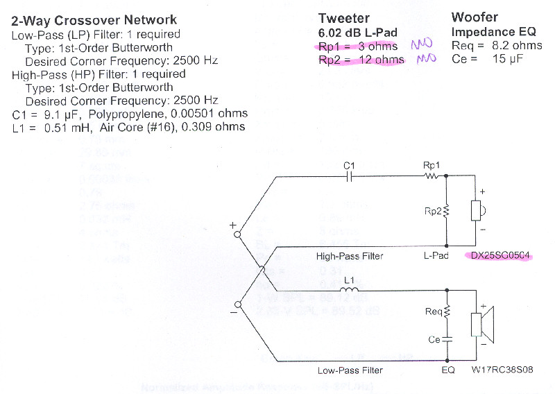

Could anybody take a look at this crossover design as supplied to me? I am hoping sombody out there can suggest a better design.
The specs for drivers are at the following link and I have attached xover jpeg.
The Woofer is Silver flute W17RC38S08
The Tweeter is Vifa DX25SG0504.

All designs are compromises.
This looks like a competent, simple design given the drivers.
Are you looking for something in particular?
If it were mine, I might target a LR4 acoustic target.
WAG is that would be second order electric, but I would have to have driver measurements to do more than guess.
Good Luck.
