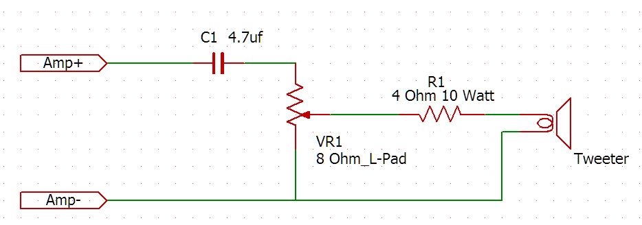

No I just think it sounds better, the horn Adda something that the full range driver can't do..then when I added the ribbon tweeter it just sings!! String instruments just sparkle in the air, I love the way they all sound together, that's why.
Have you tried the ribbon tweeter alone with the full range? It will be that small tweeter that's giving you that sparkle.
From what you've told me the horn cuts off lower than the full range and is of a much higher impedance, so it's unlikely it's contributing all that much to the overall balance of sound.
You could likely get as good or better results by putting the ribbon tweeter on a nice wooden baffle then wiring it up like the thumbnail along with your full range speaker.
You can get all the parts rather cheaply from Parts Express.

Capsa cut of low freq, and only let high freq pass correct? And coils opposite right? I was looking at your diagram for the load and ribbon tweeter, since the load is 8ohm amo will see it as 8ohm and not 4 correct? But the since I will connect it parallel with Full range 8ohm driver it will give me a total of 4 ohm, correct?
I think we should get technical..
100Hz is a woofer frequency, and at 100Hz your 2uF capacitor is blocking for your tweeter, like you said. Its impedance is high at 100Hz and its impedance is low at high frequencies so the treble is not blocked to the tweeter.
At 100Hz the capacitor impedance is 800 ohms. It is in series with the tweeter, so add that which makes it 804 ohms (*).
Now, the current from the amp can flow two ways, through the 8 ohm woofer and through the 804 ohm tweeter with capacitor. Do you think the tweeter will get much interest?
