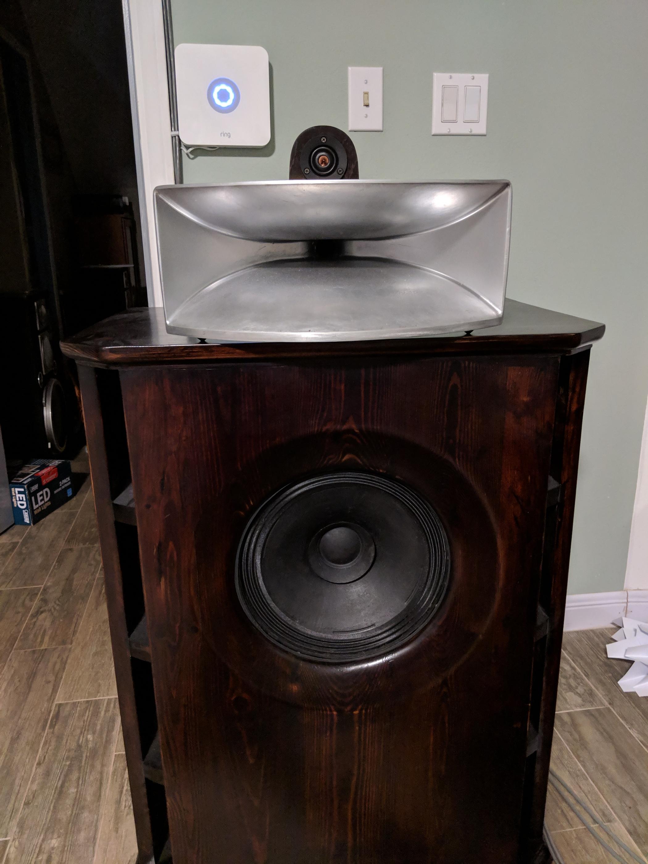

100Hz is a woofer frequency, and at 100Hz your 2uF capacitor is blocking for your tweeter, like you said. Its impedance is high at 100Hz and its impedance is low at high frequencies so the treble is not blocked to the tweeter.
At 100Hz the capacitor impedance is 800 ohms. It is in series with the tweeter, so add that which makes it 804 ohms (*).
Now, the current from the amp can flow two ways, through the 8 ohm woofer and through the 804 ohm tweeter with capacitor. Do you think the tweeter will get much interest?
Not much if any

Have you tried the ribbon tweeter alone with the full range? It will be that small tweeter that's giving you that sparkle.
From what you've told me the horn cuts off lower than the full range and is of a much higher impedance, so it's unlikely it's contributing all that much to the overall balance of sound.
You could likely get as good or better results by putting the ribbon tweeter on a nice wooden baffle then wiring it up like the thumbnail along with your full range speaker.
You can get all the parts rather cheaply from Parts Express.

I now have just the ribbon tweeter (4ohm) with a 2.4uf cap, connected with the full range driver(8ohm) only. Sounds good.. any thoughts..

There is no actual cutoff frequency here. The high pass capacitor is always letting some amount of current through even at 10 hz. What it does is to allow increasing amounts of current as the frequency increases. At some point the current it passes will become significant enough that the tweeter begins to contribute to the sound you hear. It's a hill ... not a cliff.
