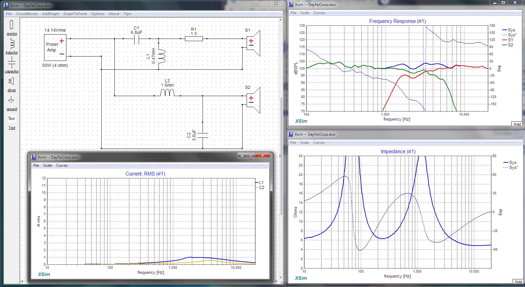

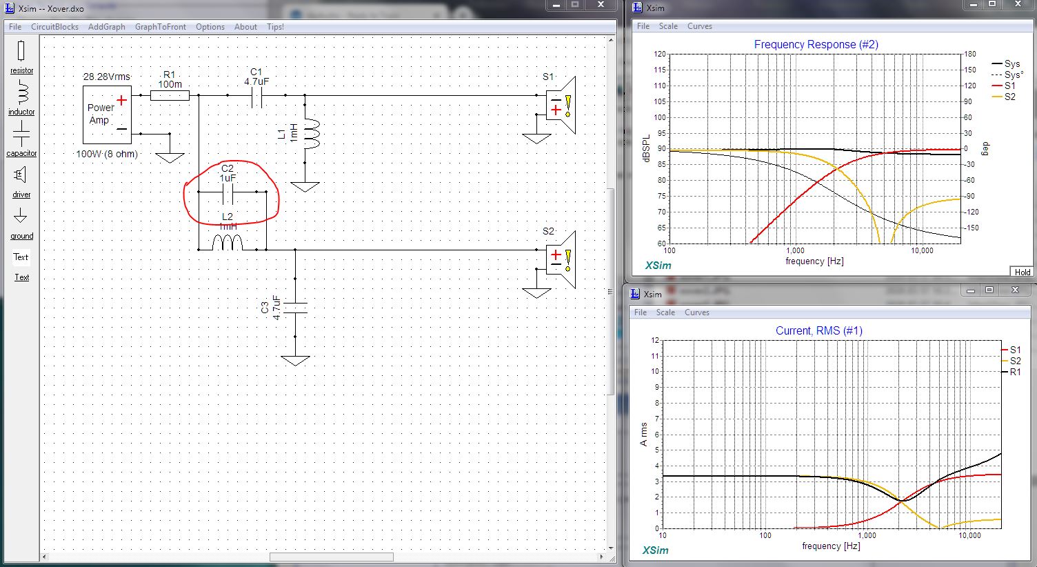

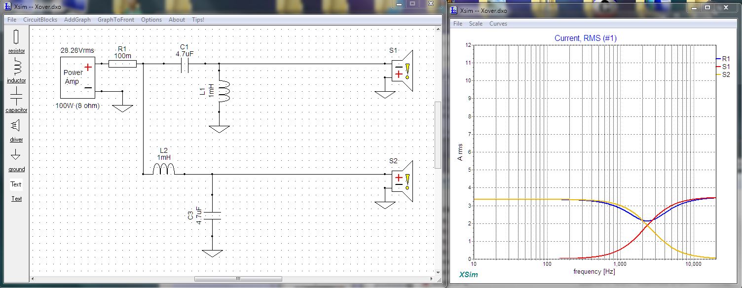

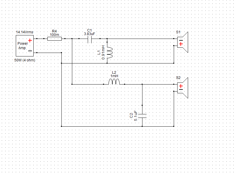

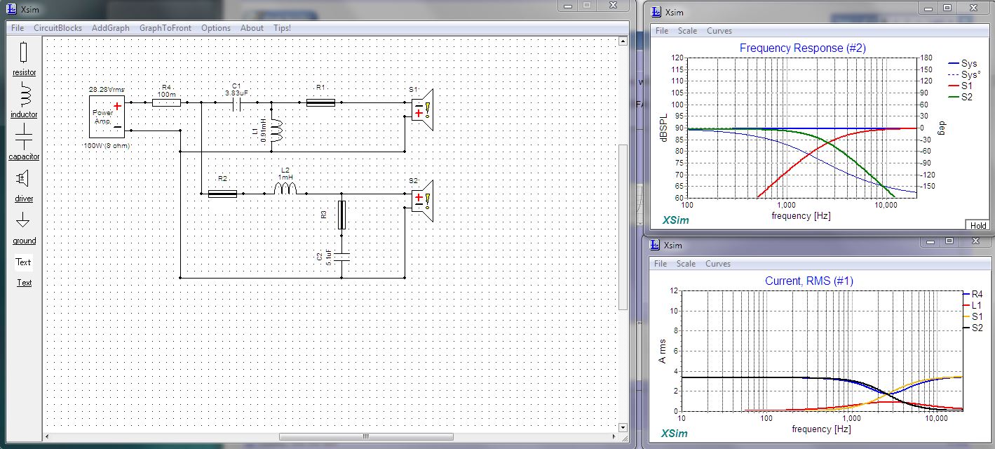

Okay one final point on my current tracking scheme...
The first thumbnail shows a relatively high efficiency crossover, almost all of the current flowing goes through the speakers. In fact the current traces the speaker currents almost exactly.
Now lets add some inefficiency and see what happens... The second thumbnial shows a common error that some "experts" actually advocate as a form of baffle step compensation. Notice that the frequency response curve is altered only very slightly... but look how the overall current graph (R1) gets separated from the driver's current. That extra current is going someplace... In fact the new capacitor forms a nearly dead short with C3 and the current just races. I find this much more informative than the impedance chart XSim opens by default.
There, done... now you guys can get on with your design...

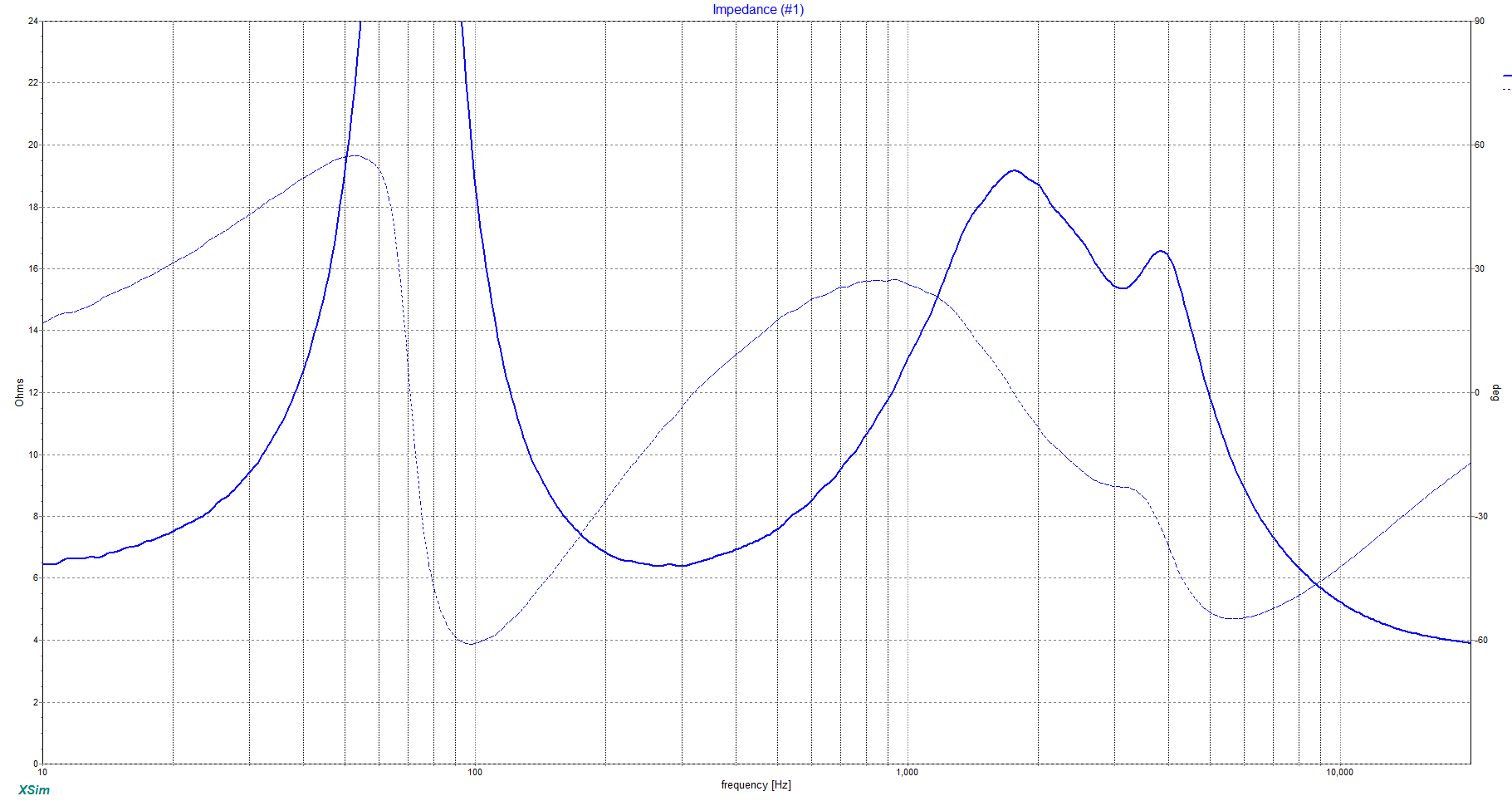

I was just looking at these two drivers:
FaitalPRO 5FE120 5": FaitalPRO 5FE120 5" Professional Midbass Midrange Woofer 8 Ohm
Dayton Audio TD20F-4 3/4" Soft Dome: Dayton Audio TD20F-4 3/4" Soft Dome Neodymium Tweeter 4 Ohm
The loud 5" 90dB midbass, unusually, looks like a closed box 7L driver.
But impressively flat.

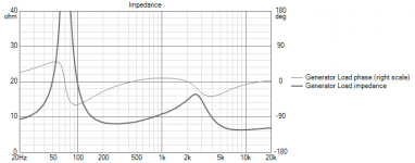

The tweeter is also 90dB. A lot of the impedance problems must stem from having to run the tweeter almost flat out. Hence no impedance raising resistors allowed. Which you'd normally do like this:
Peerless HDS PPB 830860
Everything would become easier with a louder tweeter. Maybe SB Acoustics. Maybe some sort of horn or waveguide design.

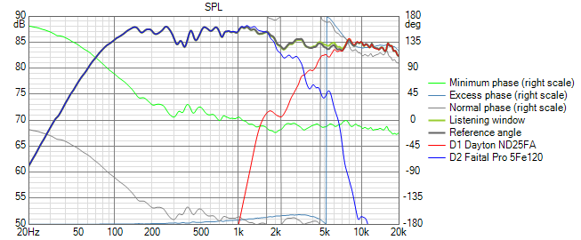

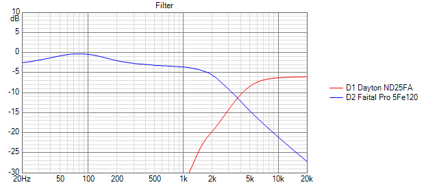

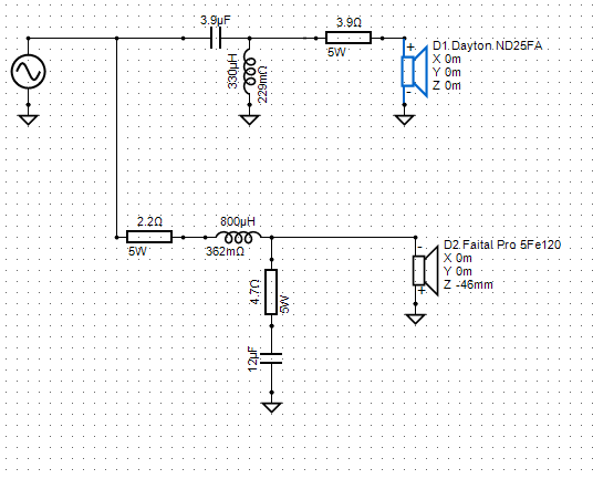

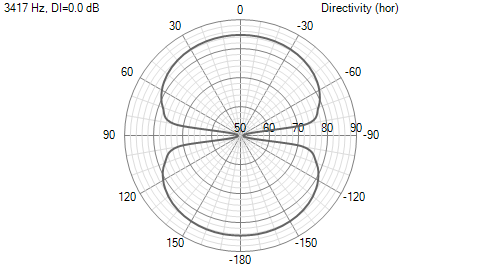

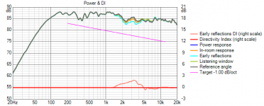

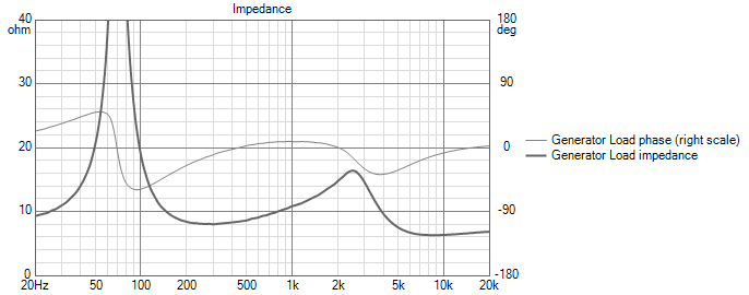

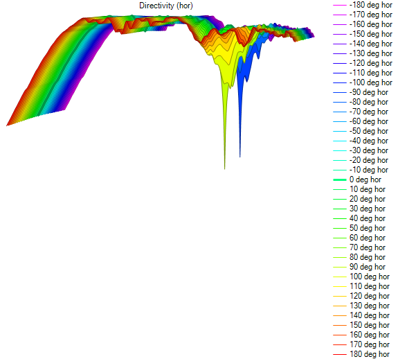

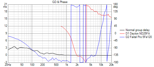

Hey guys, I have made another design trying to follow what I understood from the discussion. Can y'all have a look?
This time I am using a different tweeter, Dayton ND25FA and the same woofer Faital Pro 5Fe120. Hoping this one is a better design than the previous one.
Project 2.ii (Dayton ND25FA and Faital Pro 5Fe120) Polar Chart.png37.7 KB · Views: 132
Project 2.ii (Dayton ND25FA and Faital Pro 5Fe120) Directivity (hor).png56.2 KB · Views: 119
Project 2.ii (Dayton ND25FA and Faital Pro 5Fe120) Filter.png17.4 KB · Views: 119
Project 2.ii (Dayton ND25FA and Faital Pro 5Fe120) Power+DI.png28.1 KB · Views: 170
Project 2.ii (Dayton ND25FA and Faital Pro 5Fe120) GD+Phase.png24.7 KB · Views: 169
Project 2.ii (Dayton ND25FA and Faital Pro 5Fe120) Impedance.png22 KB · Views: 171
Project 2.ii (Dayton ND25FA and Faital Pro 5Fe120) SPL.png35.9 KB · Views: 183
Project 2.ii (Dayton ND25FA and Faital Pro 5Fe120) Circuit.png15.6 KB · Views: 180

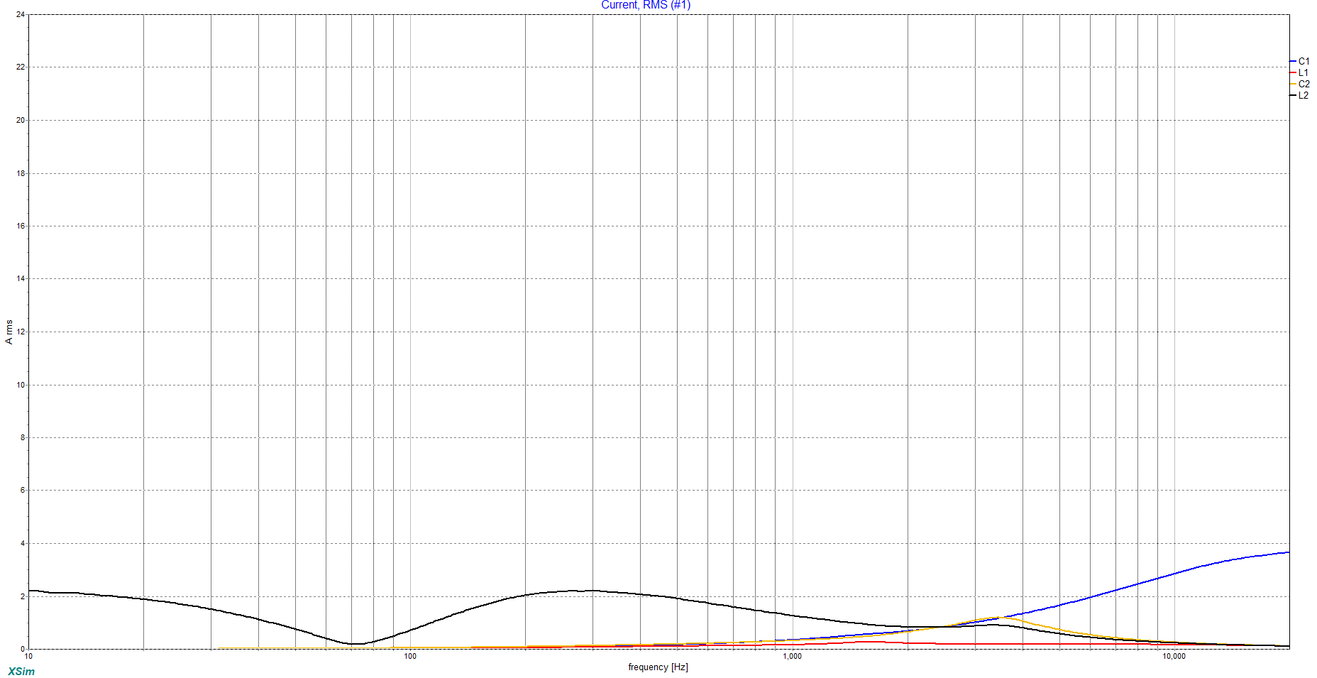

Okay... looking a lot better... Just a couple of tips...
1) If you take the series resistor out of the woofer chain (2,2 ohms) you will get about an extra 6db sensitivity (output) from the woofer. Also there's no way a 5 watt resistor is going to last in that location, with any amp beyond about 10 watts.
2) After #1, you can reduce the resistor in series with the tweeter to match the levels up.
3) It really isn't a big deal, but when necessary I usually reverse the tweeter polarity. This because it's a lot easier to get at the tweeter and flip the wires later, if you have to.
4) If you get rid of the 4.7 ohm resistor going to the cap in your woofer chain, you can adjust the capacitor's value to give you essentially the same result.
5) You may want to increase the value of the coil going to ground in your tweeter chain. It's still pulling quite a bit of current.
TIP... coils and caps can waste energy as current to ground but resistors waste it as heat.
This is a big improvement over your first attempt.
I've attached a thumbnail of your design in XSim, with a few adjustments... you may want to try them in your design. The lines through the resistors mean they are shorted and would not be included in the final design. (I didn't use the exact driver specs, but it should be pretty close.)

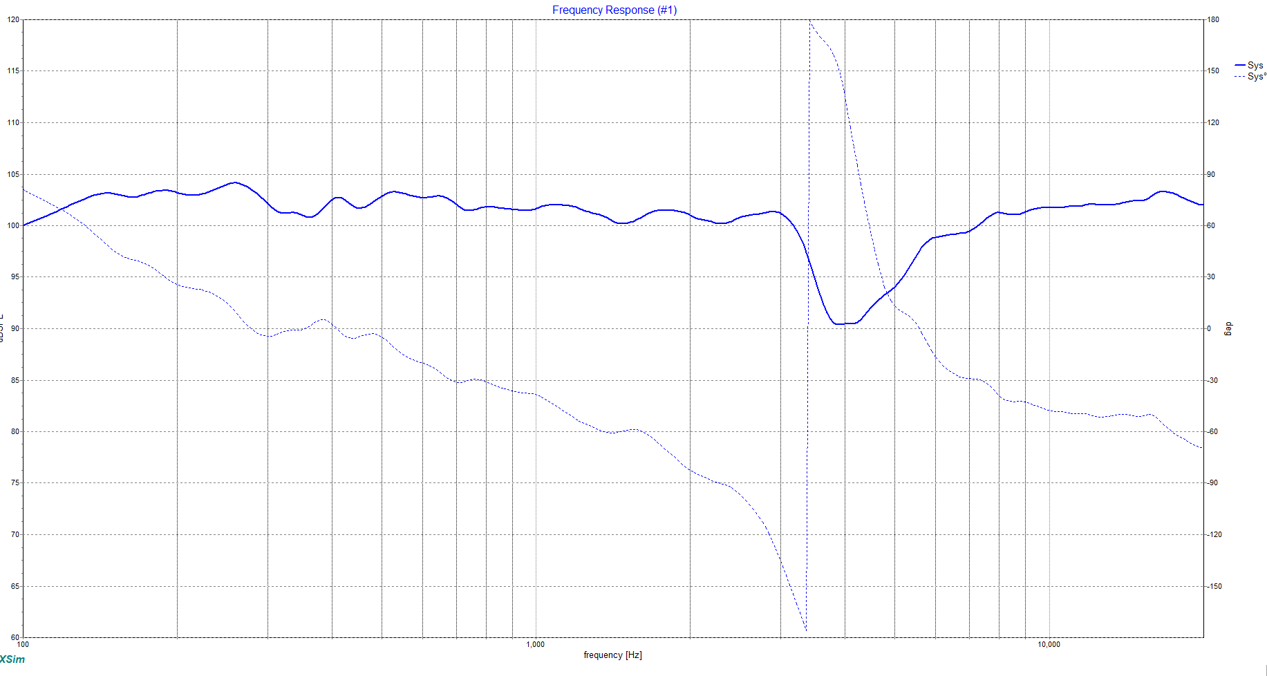

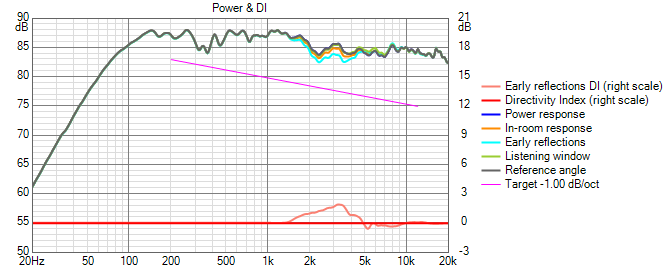

Well, I did use your design and I am getting these results.
Also, I kinda tweaked my previous design. I am also attaching the dxo file. Can you take a look at that?

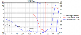

Okay got it...
The DXO was not an exact match for the images... but boy it's getting close.
A new DXO is attached.
1) I set the tweeter back to normal, instead of inverted, that got rid of the dip at the crossover point.
2) I tinkered with parts values just a bit. in particular making the woofer's first coil a bit bigger (let it do more work)...
And lookie there... within +- 3db and all waste currents in the safe zone.
The dip at the crossover point was because of me accounting for the acoustic center. I am using Vituixcad for the simulation. So I initialized a -2 cm difference and then went on to to get a flat response. But I have no idea how to account for the acoustic center difference on Xsim since I do not have any measurement gear.
Also, the power dissipated from the single resistor is around 13 watt. So I will be using two 3 ohm resistors in parallel.

- Crossover Design: Low Impedance after 5k in the Impedance Curve
