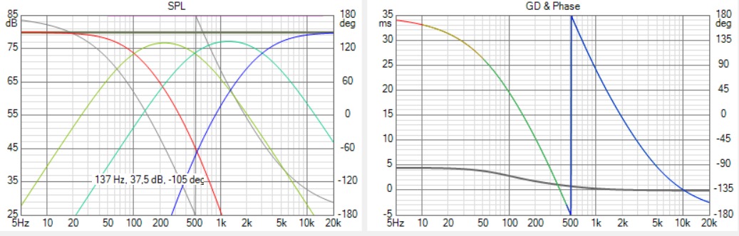

Robintipp said:
Then this happened.

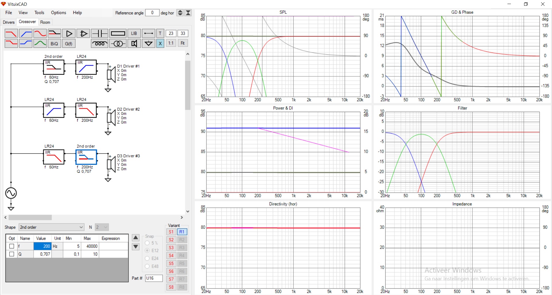

Correct, putting a decade between crossover points will prevent this problem. SL showed an example with only 2 octaves separation.
This can be done with no channel cascading, no EQ and only one extra filter. Are you interested?

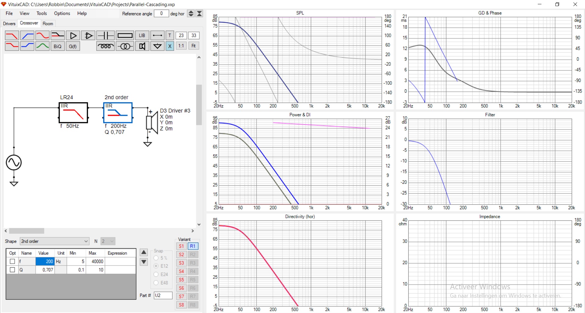

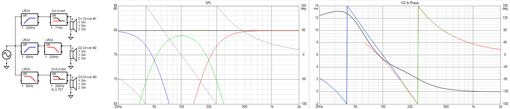

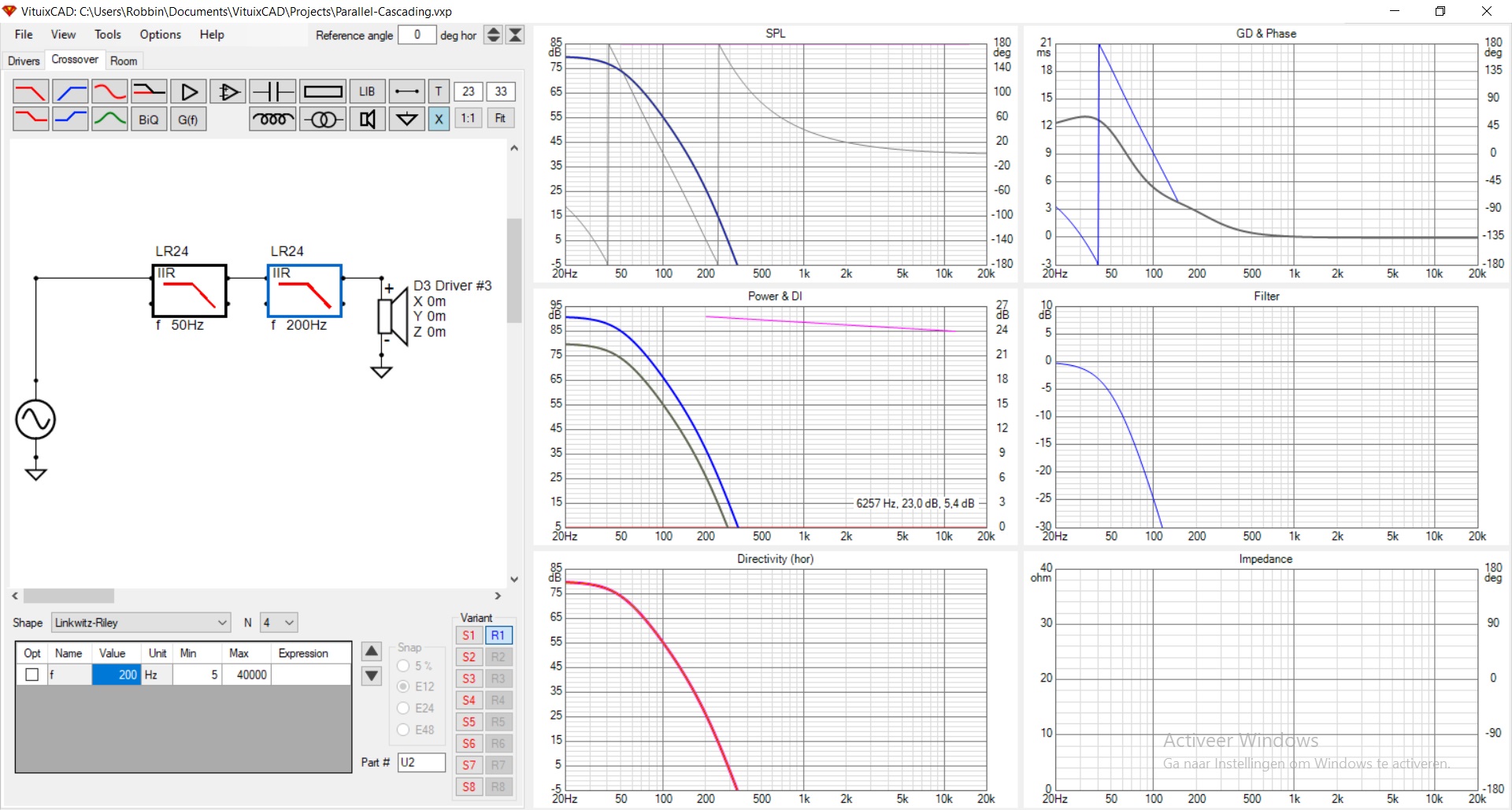

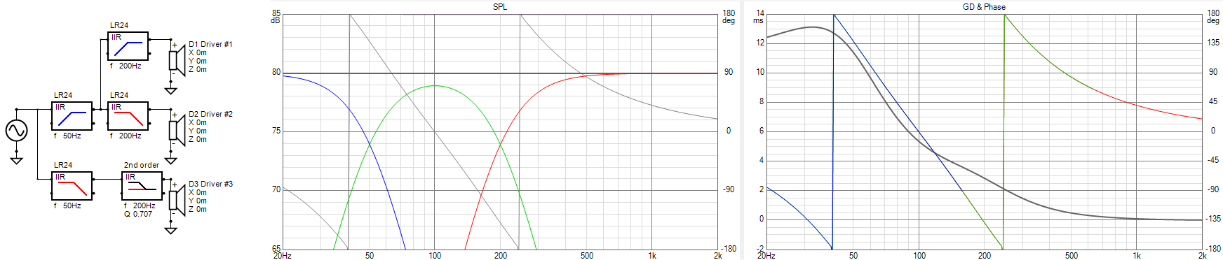

Thanks Alen,
Sure am interested.
The example you posted shows both cascading and paralleling + all-pass works even when mixing them.
So I've split them up to see what could be different...
I couldn't spot them this way.
diyAudio Moderator
Joined 2008

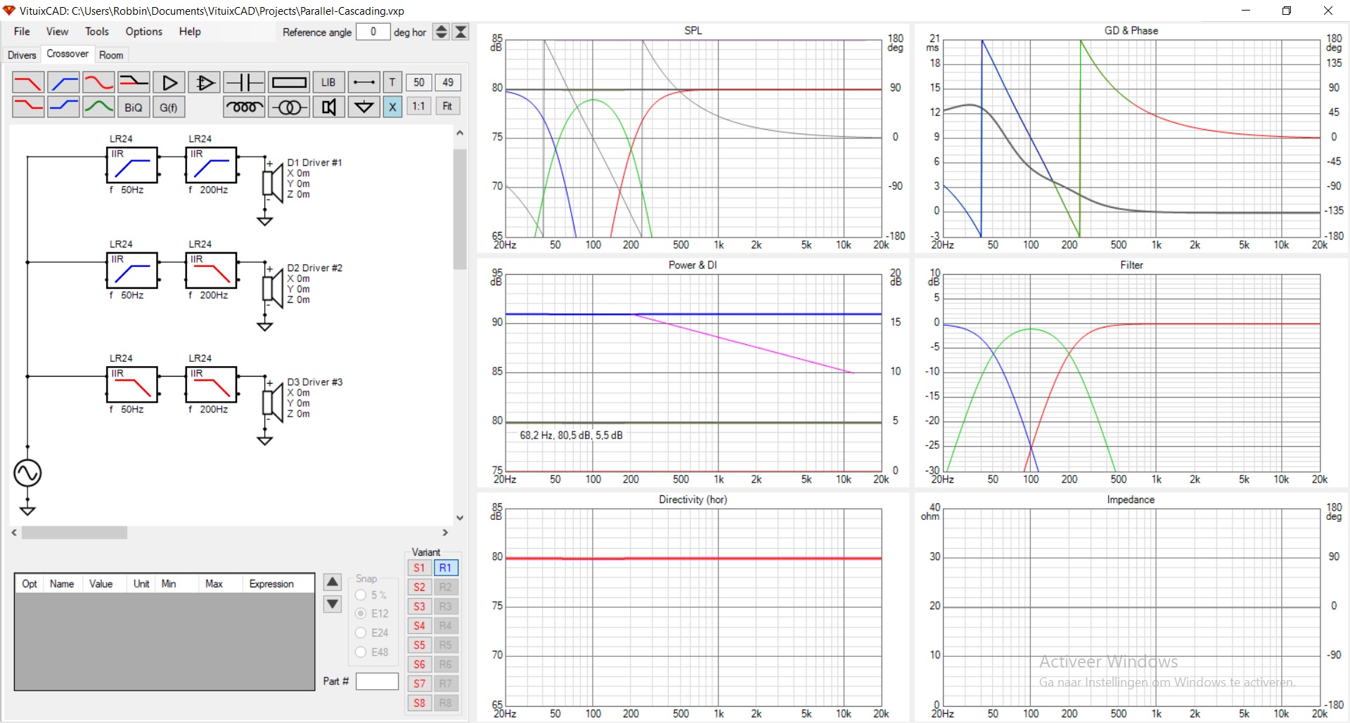

Nailed it.
Only one of the lower two is correct, the one with the all-pass filters. Linkwitz has it summed up with this
SL said:
A maximally flat response is obtained when also the 200 Hz lowpass filter phase shift in the W channel is duplicated in the SW channel by an allpass filter with the same phase response.
Just for fun, here is a version with the tweeter polarity inverted.

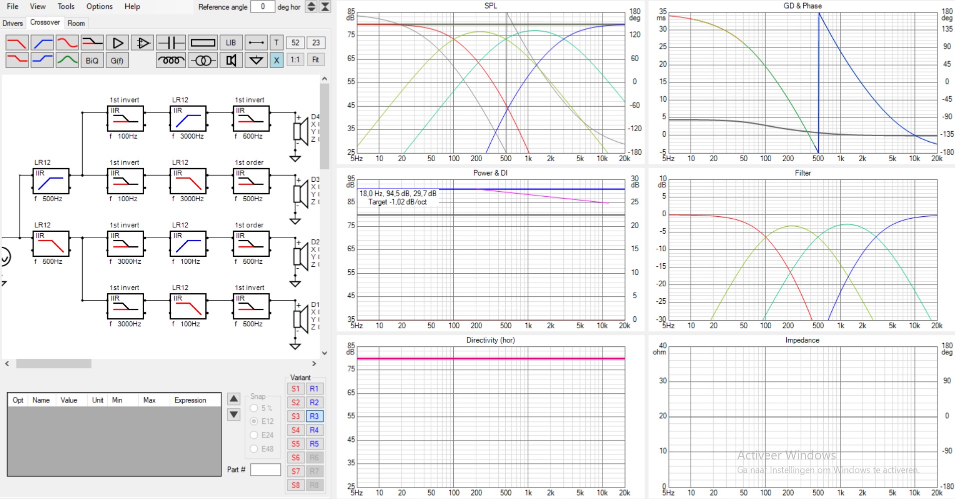

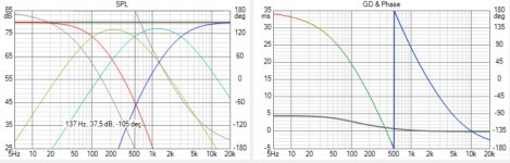

Playing around with VCAD is fun, but have strong doubts that the image I attached could be translated into the real world.
All LR12 slopes, IIR..
Not possible... Right?
Prefer to stay stay with IIR, but the introduced phase rotations I'd like to eliminate.
I have read about forward-backward filtering. Unfortunately can't find any reference to programs that can do that kind of filtering for audio yet.
But before I go searching...
Reversing the audio sample to filter it, then reversing it again. Does the post-ringing of the reversed sample turn up as pre-ringing after reversing it again?
If so, is this in the same order of magnitude as with a FIR filter that has the same slopes? No free lunch I'd guess.. :(
Thanks for your answers.

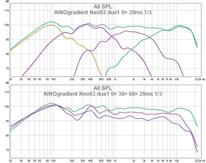

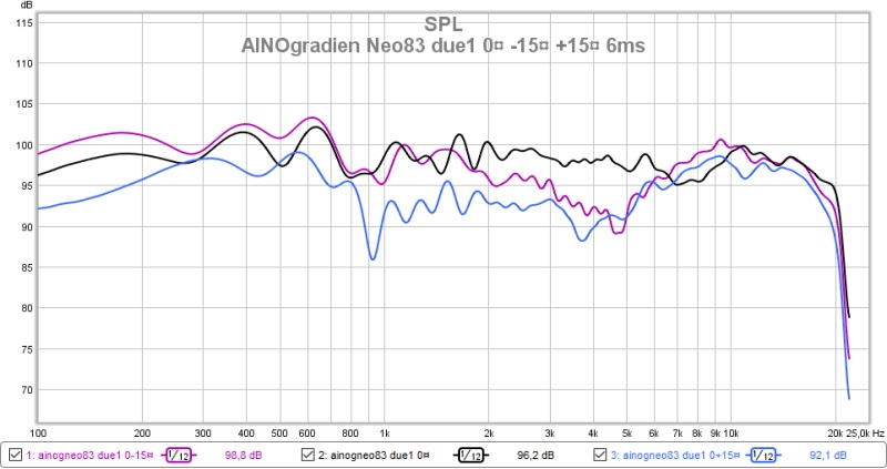

I haven't learned FIR, my 4-way Ainos have IIR LR2/ellipitic acoustic xo setting with minidsp 4x10Hd.
It is risky to measure/ analyze in-room, but the challenge is to have control of each driver's response and delay so that phases of woofer and tweeter match and sum below the mid. This can be tested by muting the mid and measuring. Phase will rotate inevitably, but softly with LR2 or Duelund.
My indoor measurements, also vertical off-axis
