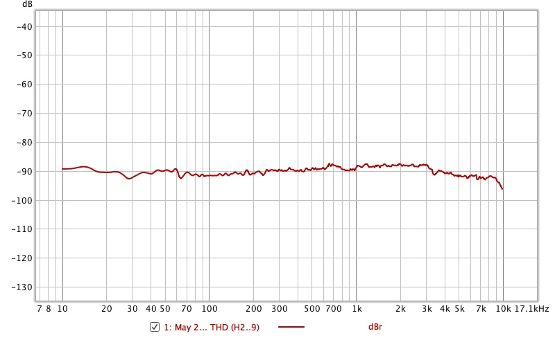

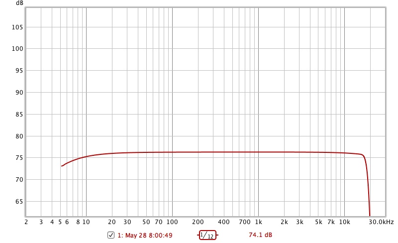

....I ran into a similar problem with the DCX2496....
One chart is FR of my elderly DCX2496, razor flat in the audible range.
The other chart is distortion. If you don't know how many zeros are needed to convert "-90dB" (right across the band) to percentage, you can look it up on the web*.
Don't forget, when I measure the DCX2496, a lot of really old gear is also in the measurement loop adding to FR error and distortion.
B.
*quite a few
Nope, no clipping.+15dB is a lot of boost, it was probably clipping, did the clip LED come on at all?
This was before the ouput mod, with the original +22dBu at the outputs. To say I would have noticed clipping would be understating it lol.
Distortion is relative to signal, present at all amplitudes but only when the value in software is +15dB. At +14.9, it is gone. -15dB is no problem. It's not something you might immediately notice when listening but Arta showed it. It's not a big deal, I just put the filters at +14.9 if I really have to. Seems like a bug.
Your graphs look examplary.One chart is FR of my elderly DCX2496, razor flat in the audible range.
B.
*quite a few
