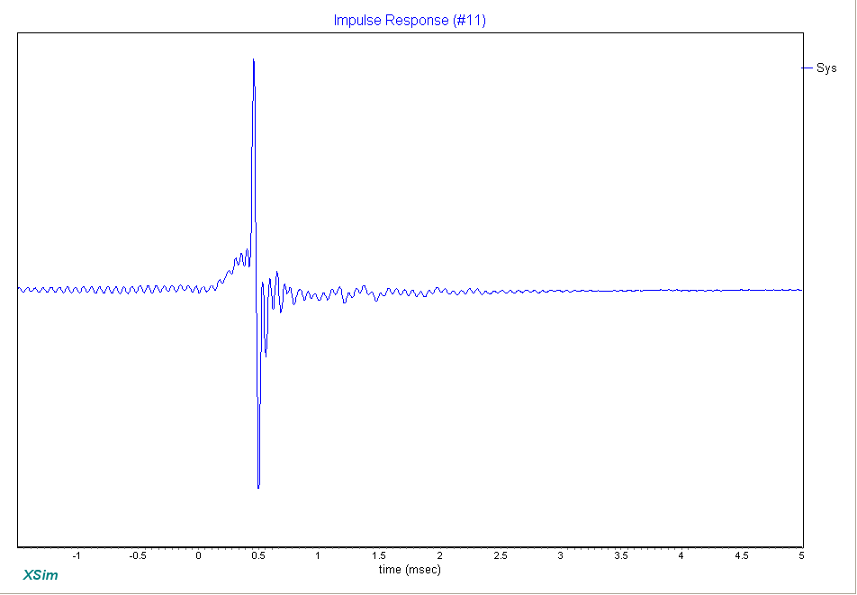

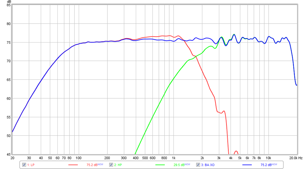

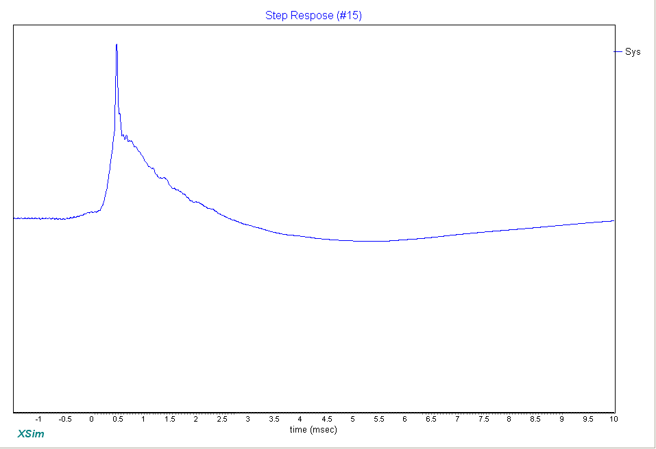

Here was what Anthony Bisset and I came up with:
508909d1444824308-crossover-design-contest-win-prizes-active-passive-entries-due-oct-9th-ba-xrk971-abisset-system-fr.png
Impulse:
508907d1444824046-crossover-design-contest-win-prizes-active-passive-entries-due-oct-9th-xrk971-abisset-ba-xo-ir.png
Step:
508908d1444824046-crossover-design-contest-win-prizes-active-passive-entries-due-oct-9th-xrk971-abisset-ba-xo-sr.png
I would not have chosen this combination of drivers either, but thought maybe they were paired together to provide a challenge to make us flex our brains in coming up with a XO. Given the major peak on the woofer and several peaks and dips on the tweeter, it was not as easy a task like taking a flat-as-a-board AC130F1 and RS28A like the drivers in the Continuum.
You are all giving me too much credit, as if I carefully "crafted" the competition and intentionally chose these drivers to challenge people. Hardly that. I got some drivers donated, realized they could be used to make a pair of small MT monitors, and hatched a plan to get people doing something. Then I threw together the rules, found three judges to commit their time, and made the measurements (including cutting a baffle for the box myself) all in 1 week before finally announcing the contest.
Hopefully I can do this again with alot more advance planning, a better set of drivers, and so on. This was, let's say, a fun first try at this kind of thing. So please don't take it too seriously or point out all the flaws in the system or drivers.
