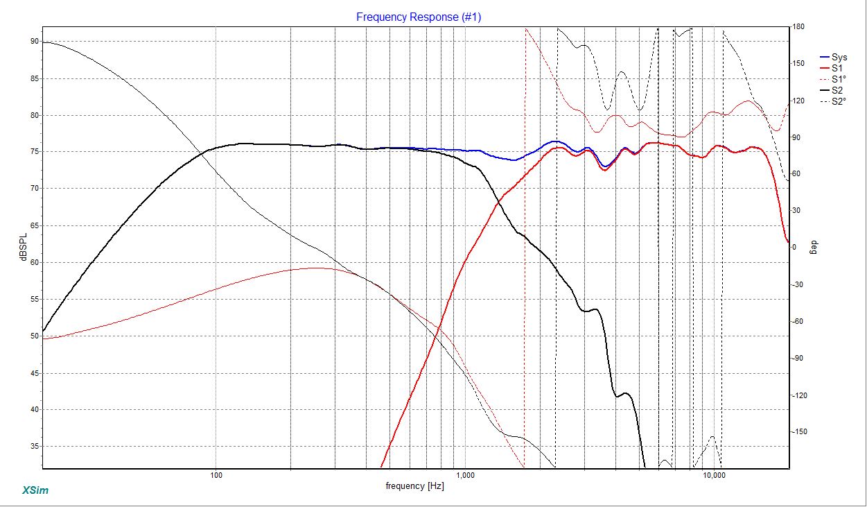

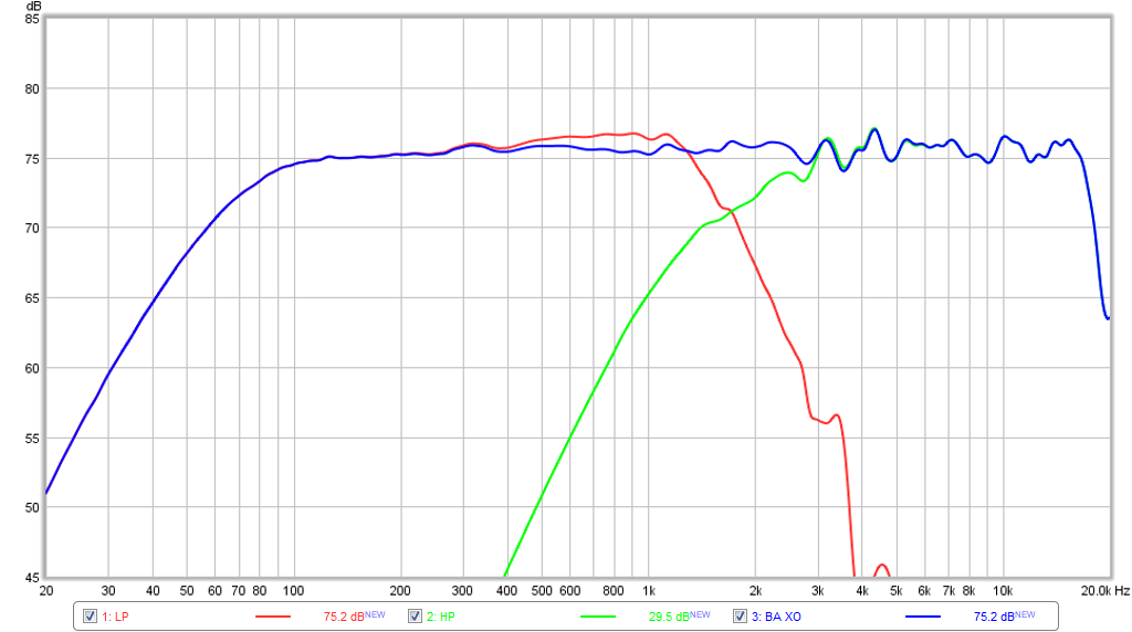

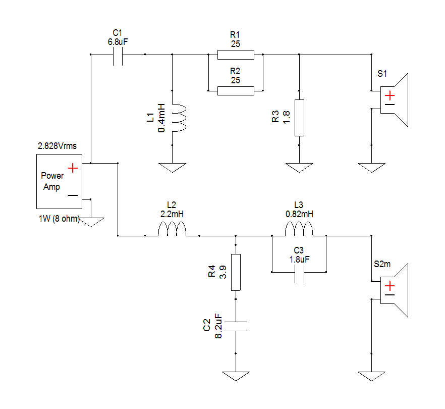

...and the winner and runner-up in the 2015 Burning Amp Crossover Design Contest are:
We had quite a few good designs and the judges spent quite a bit of time comparing each beyond simply looking at the submitted info. My thanks go out to them for serving on the panel.

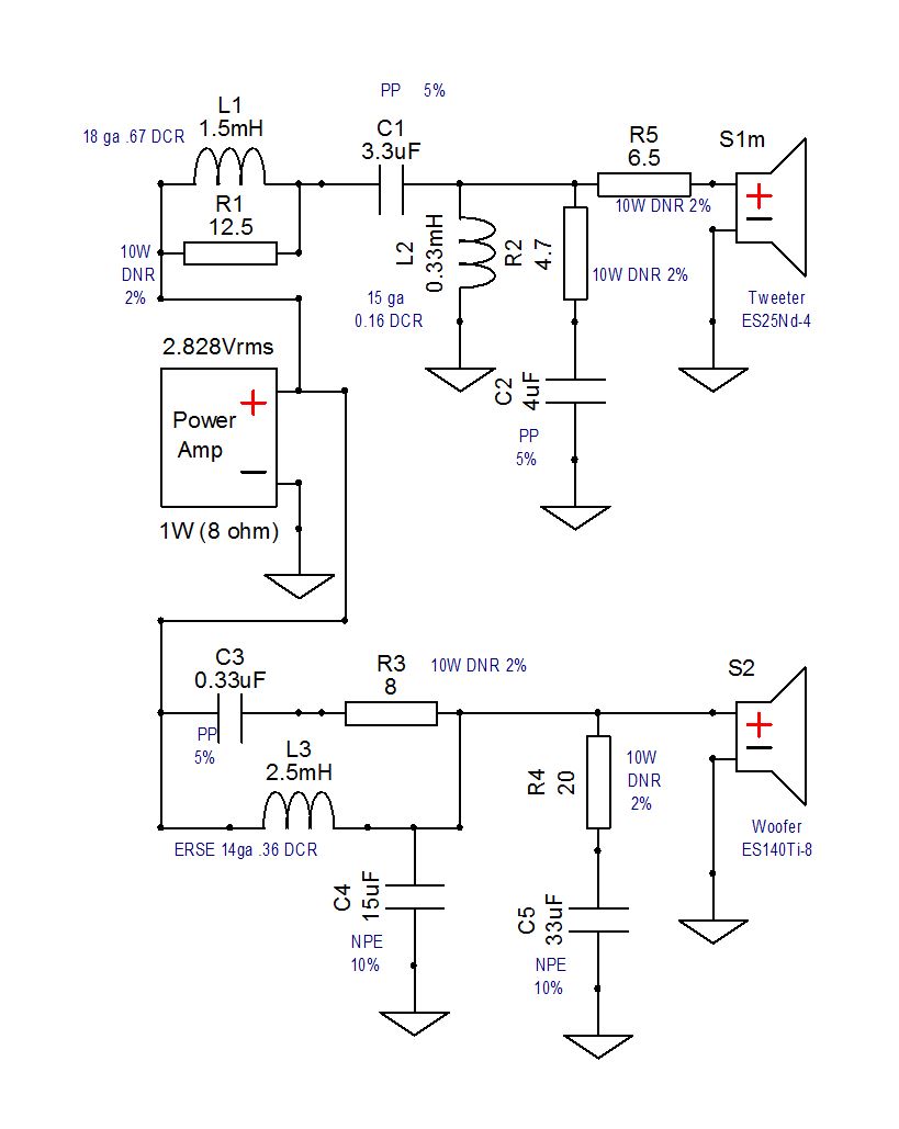

Below you can find the crossover schematics for the winning and placing designs as well as the system responses for each (first two are from winning entry, remaining three are for runner-up. You can also look at the filenames by hovering over the icons before opening them).
- WINNER: 4thTry (PE TT user name)
- RUNNER-UP: Lojzek (DIYaudio user name)

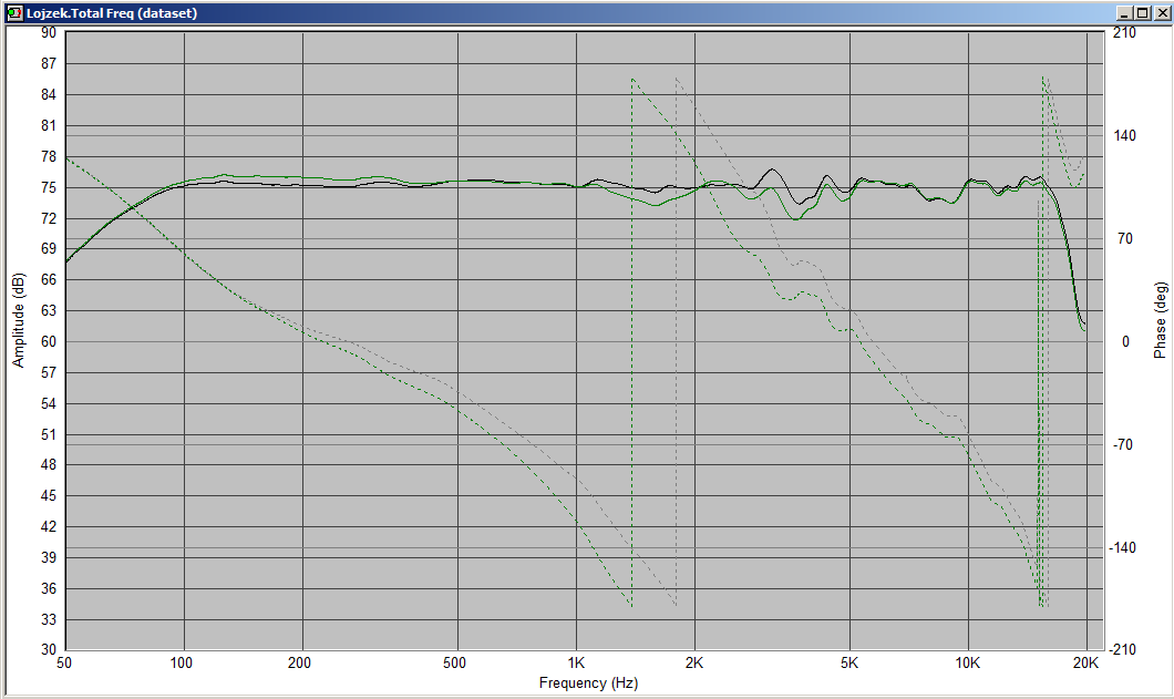

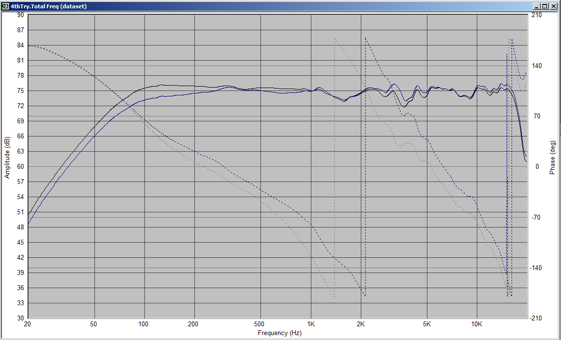

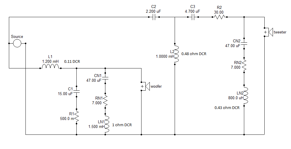

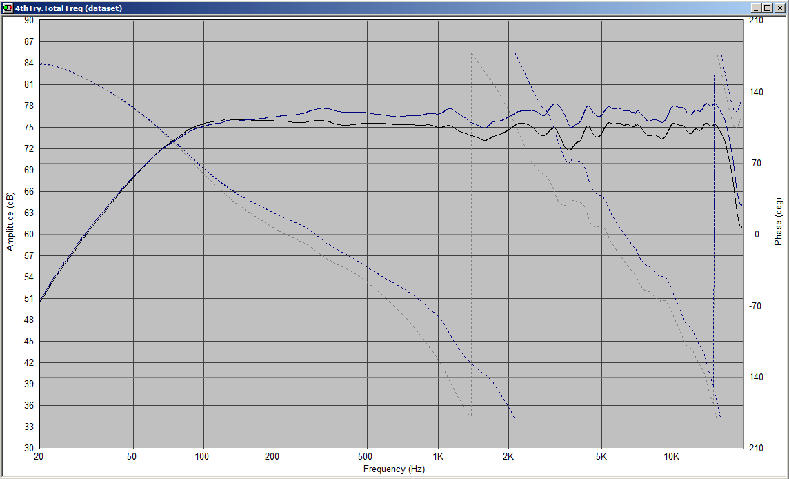

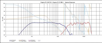

As always I like to compare how others do things to how I have done something. I just modeled 4thTry's crossover (had to do it in speaker workshop as I can't work out how to get that topology in PCD) and compared against my implementation. It's interesting to see the similarities (basic driver characteristics) despite very different implementations.
I was struggling with how much attenuation was required, and tried to squeeze a bit more sensitivity out (going for a 77db target) That cost me in the bass from 200Hz down.
Attached is the comparison 1st showing the sensitivity difference, and then with mine dropped 2db to see how close (other than the bass) they are.. pretty close considering the different topologies and crossover points! edit: mine is the blue curve in both 😉
I'll do lojzeks later (coil dcr would be nice) I've exceeded my lunch hour 🙂
my coil values were:
L1 1.2mH 0.11DCR
LN1 1.5mH 1 ohm DCR
L2 1mH 0.48 DCR
LN2 0.80mH 0.43ohm

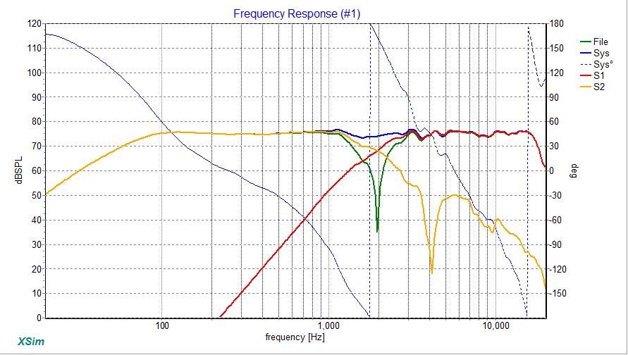

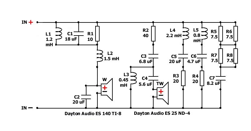

Thanks Tony !
L1 1.2 mH; dcr 0.33; 15 awg
L2 1.5 mH; dcr 0.38; 15 awg
L3 0.45 mH; dcr 0.46; 20 awg
L4 2.2 mH; dcr 0.84; 18 awg
L5 0.8 mH; dcr 0.62; 20 awg

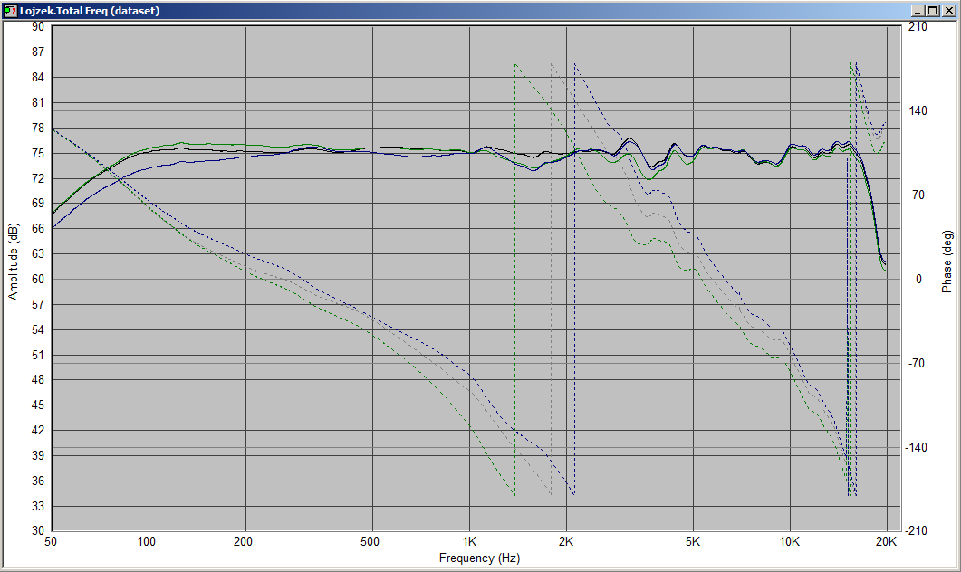

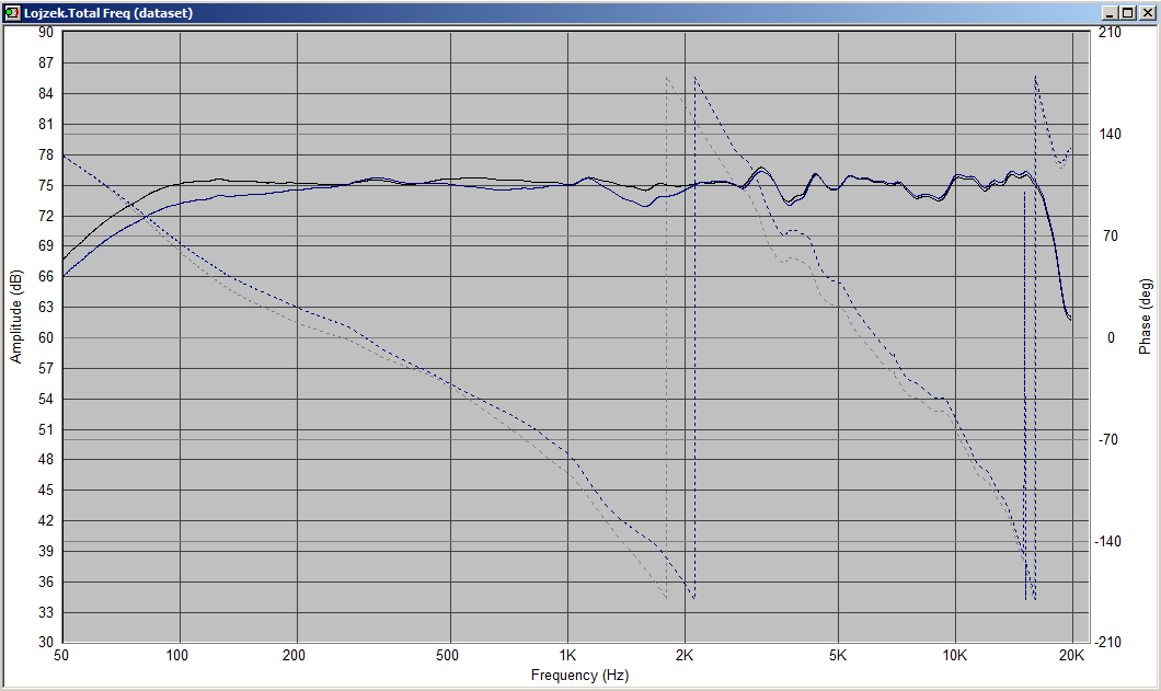

OK here are the comparisons of Lojzeks implementation. Only small differences to 4thTry's
I've often read that dips are less noticable than peaks and it looks like 4thTry has gone with that thought when you look at the the peak/dip in the 3-4Khz range.
I really struggled trying to get rid of the dip in the 1-2Khz range, and gave up in the end thinking it wasn't possible, but Lojzek has succeeded exceptionally well in this regard!
first attachment is comparison between Lojzek and 4thTry's.
second attachment is comparison between Lojzek and Mine (with mine scaled down 2db).
Third attachment is comparison between all three.
So my assement of my own work after seeing these is:
I underdid the bafflestep compensation a bit. and I overdid my notch a bit, and probably should have concentrated a bit more on the peaks rather than worrying about that making the dips deeper 🙂

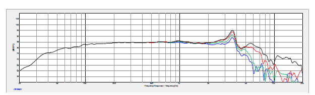

I feel like a bit of a party-pooper here, but these cheap knockoffs of Dynaudio's large voicecoil polycones, and Vifa and SB acoustics ring radiators just suck to the highest degree.
These must come from a part of the World that has no respect for patent law at all, which is strange because Dayton Audio portrays itself as being as American as apple pie. 🙄
As for that woofer. I mean really, why are we having to deal with such a horrible peak at 3.5kHz. Well, because it's an unsuitable glass fibre cone.

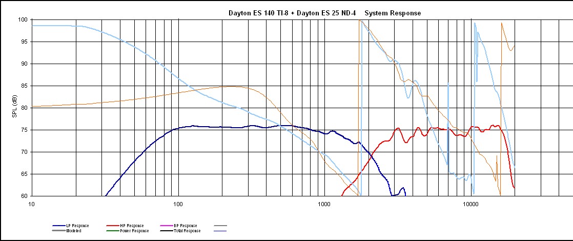

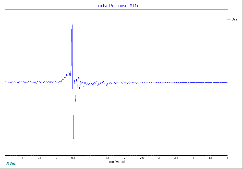

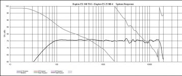

I would not have chosen this combination of drivers either, but thought maybe they were paired together to provide a challenge to make us flex our brains in coming up with a XO. Given the major peak on the woofer and several peaks and dips on the tweeter, it was not as easy a task like taking a flat-as-a-board AC130F1 and RS28A like the drivers in the Continuum.

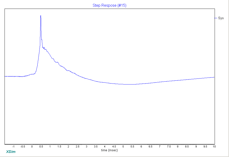

Here was what Anthony Bisset and I came up with:
Impulse:
Step:

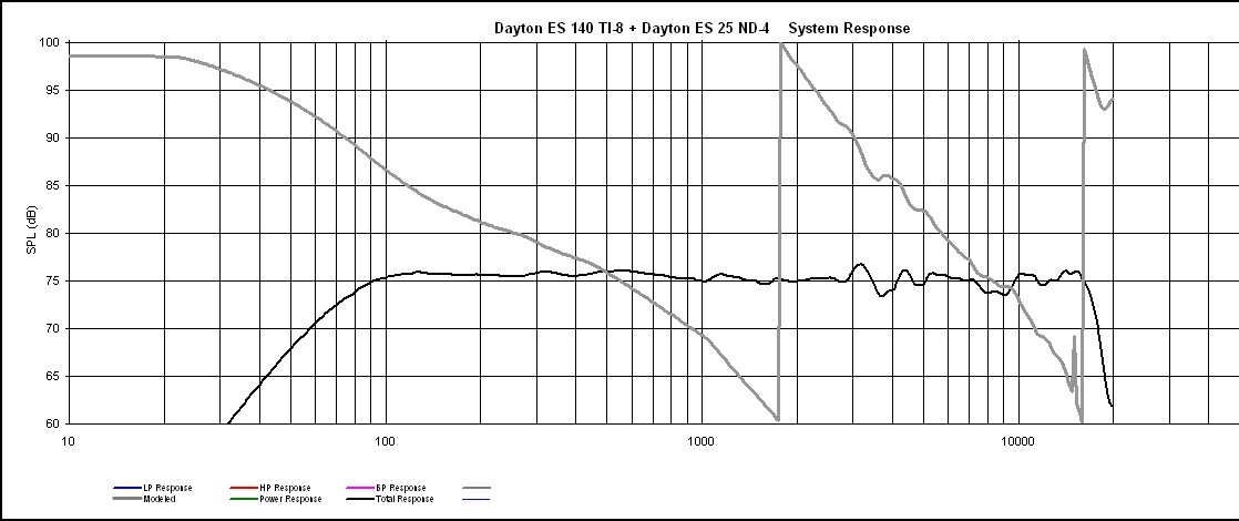

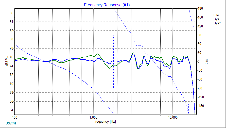

Ok, here's mine. Although Charlie made it clear that complexity wasn't an issue, for the sake of the exercise I tried to keep it as simple as possible, so it's your run of the mill cap - coil - L-pad on the tweeter and coil - resistor+cap - LC notch on the woofer. I used two 25R in parallel in the L-pad to be on the safe side re. power handling, but I guess a single 10W 12.5R would be fine too. My DCRs are: L1 - 0.43, L2 - 0.154, L3 - 0.27.
I've compared it to Lojzek's (last picture, green mine, blue his) and I'm with Tony that he's done a great job flattening it in the 1-2k region, as has 4thTry, and both of them without undue complexity. I've used 4thTry's topology before but, for some reason, it hadn't occured to me to put the trap before the coil and cap as Lojzek did. That goes in my toolbox!
Congratulations to the winners and many many thanks to Charlie, this was fun!
