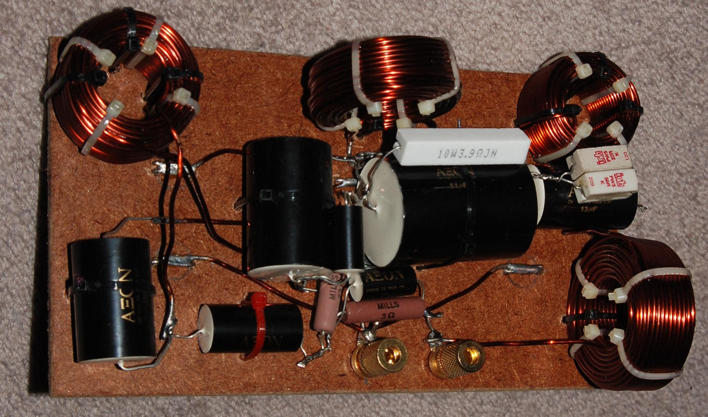

deccimal point placed wrong
I smell something fishy here.
I think the decimal point is placed wrong in the caps shown in the picks.
They look more like 0.47 and 0.33 to me judging by size.
Measure and confirm with a capacitance meter or compare with known caps of same value using X100 scale of a analog multimeter.
I have yet to see 33uF and 47uf caps in crossovers other than in subs and the Yamaha NS 10000.

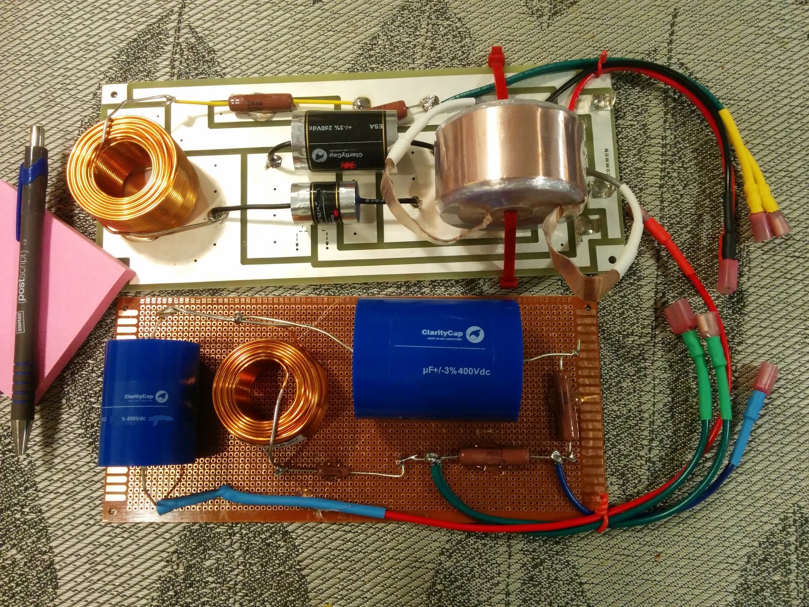

First one looks like a Visaton MKT. Terrible sound, both from the polyester and polypropylene series. Their leads also tend to break after a few desolder/soldering, same for their MOX resistors which also sound crap. I didn`t believe in capacitor sound until I tried the Visaton MKP which was horrible. I would second the recommendation for Clarity Cap, very nice capacitors ( have used only the PX range ). Jantzen Cross-caps are also a good option.
Clarity Caps are in fact very very good. 🙂 They are open and transparent without the Disney-like sheen of the high-end Mundorfs. They are rather high ESR, and I did benefit from bypassing a large one with Audyn True Copper caps. Had I had the forsight I would have bought smaller caps and put them in parallel.
Every now and then a person comes across a truly bad capacitor, but I think it is rare. Most are more similar than not. One that stood out was an MKT of similar size to this which I tried in both an amp and a speaker before just disposing of it. On the other hand some of the best I have are FK/MKP. This was more than a dielectric material issue.
I find the Clarity caps to be fairly neutral, which let's me move on to other things.
If you have high ESR bypass wont change a thing, more likely speed. I like clarity cap, if you want to improve the sound solder all leads: I see crimp connectors !
None of that aligns with my experience, I'm sorry.
XSim and my ears both agreed that bypassing the largest cap made an important difference. However, bypassing the small blue cap did nothing.
I heard the diff first, then examined the XSim model, by the way.
Yes, you see crimp connectors. Don't use them if you don't like them, I've only had problems when the crimps were bad.
By the way, that little black cap you see is a Duelund silver foil bypass cap.
