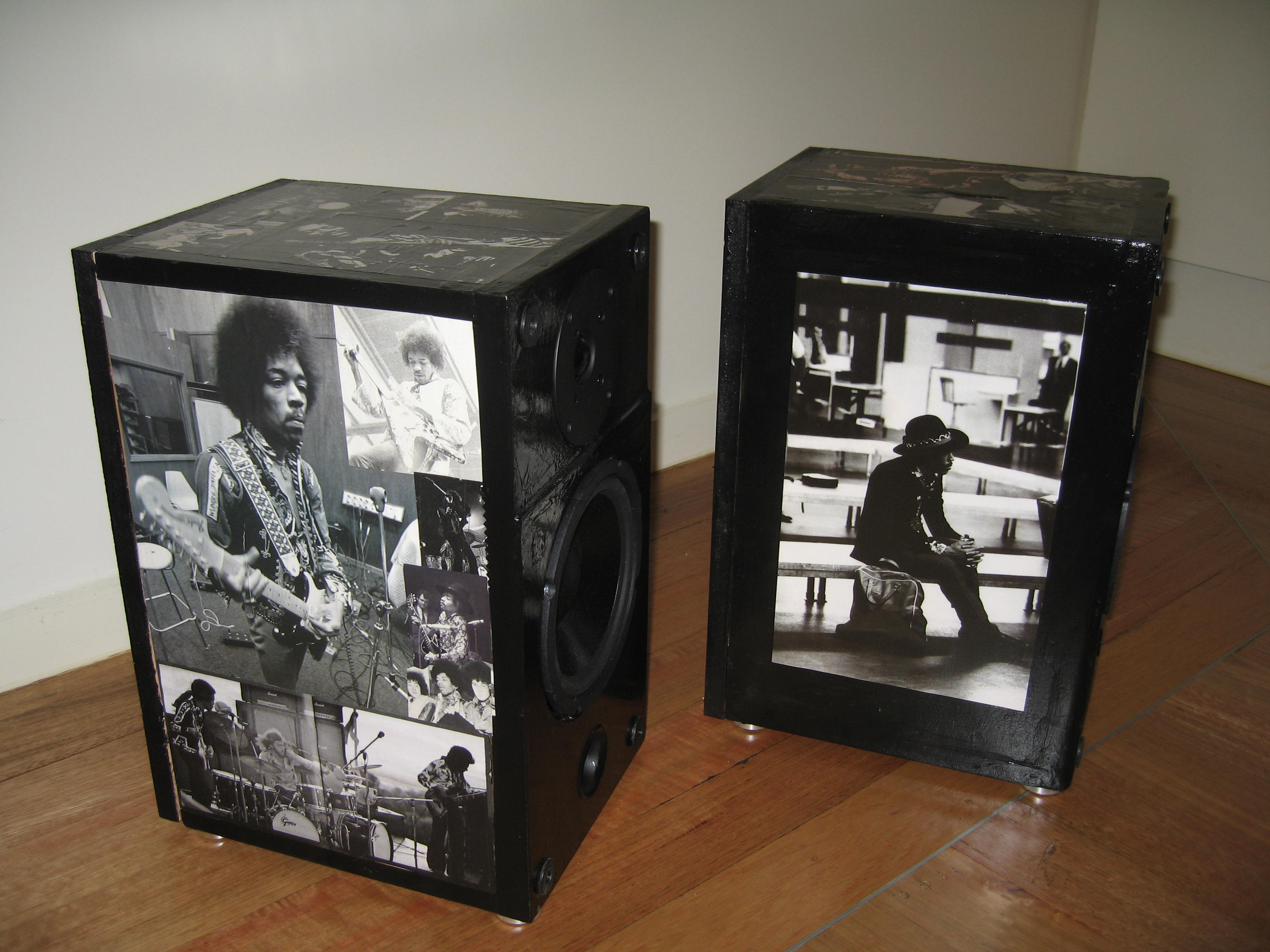

My Classix were my first go at cabinet making and look pretty awful (att), but it was fun and we enjoy them, which is the main thing. I used speaker grilles as the DC160s are a bit 'clunky' to look at. I think I have some photos of the crossover layout if you 'd find that useful. I strongly suggest using them on stands and don't place them too close to corners, or the bass may get a bit 'muddy'.
