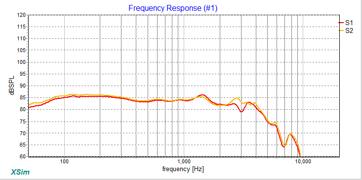

I would definitely trust your opinion since its obvious you have more experience than I. I was looking to build flatish-response speakers on a budget, but even the Classix II build lacks mids (based on his review and reviews). So If I can ditch these drivers(can sell the DC160s to a friend), would you recommend another proven kit that is close to having a flat-reponse? the only reason I choose the DC160s was that even as a 2-way it can go so low I wouldn't need a subwoofer, but wouldn't mind adding a subwoofer for the better overall sound.
I rarely give up on a speaker... but this one is a bit to the cheap and cheerful end. 😀
Question marks over the 6" woofer and cheapie 3/4" tweeter really.

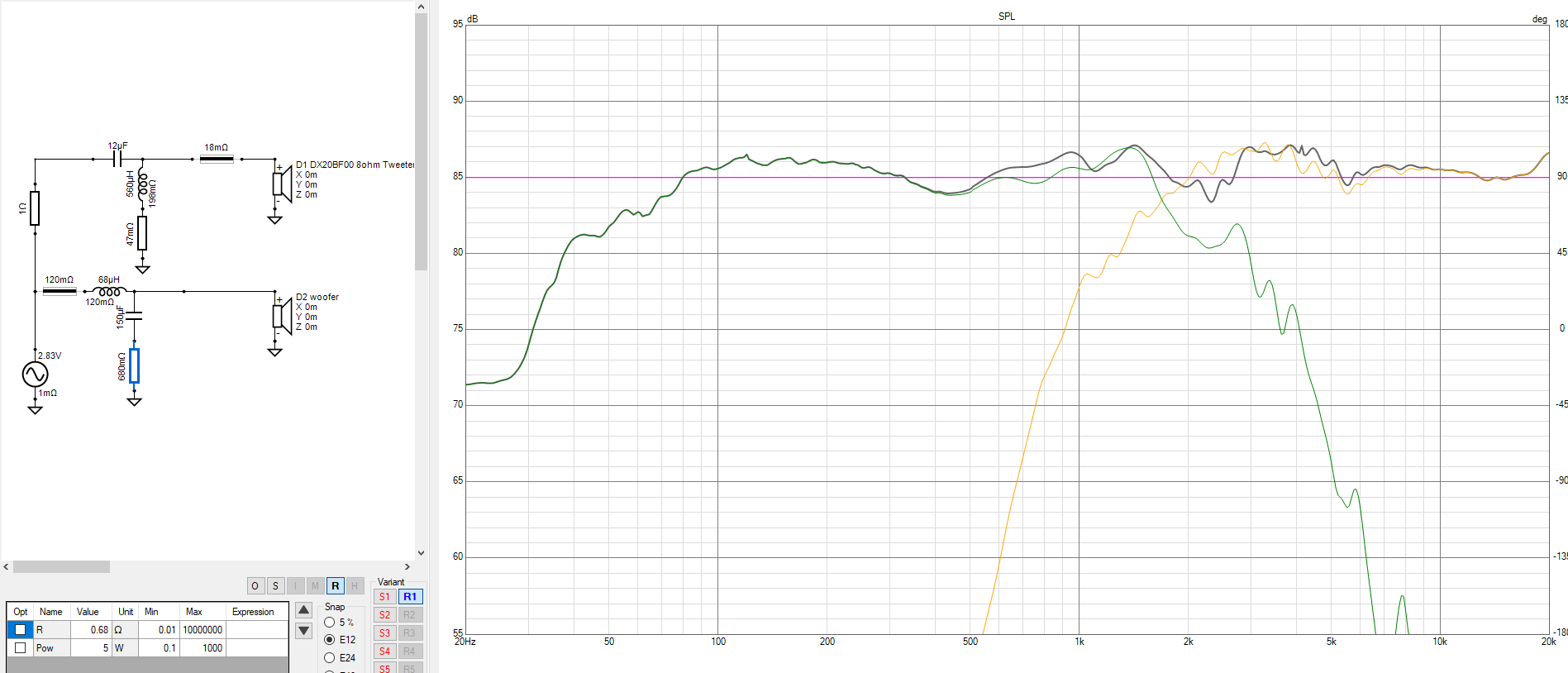

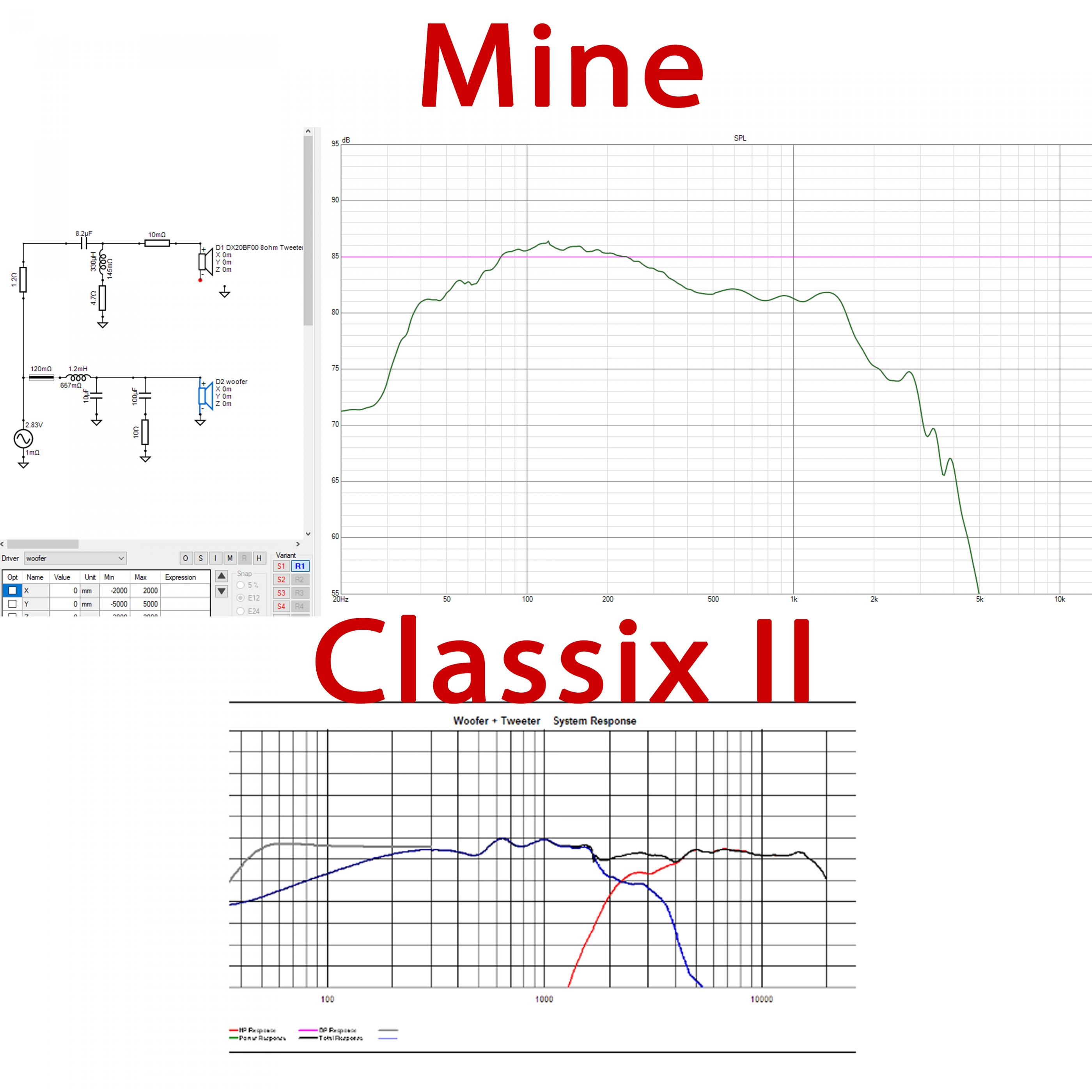

Paul Carmody has done a competent job here. 15L of reflex. 4" x 1.5" port. Quite typical. He uses the much louder Vifa 1" tweeter which can cross at 2.5kHz comfortably.
Crossover is, er, idiosyncratic. 🙄
I ran a rough sim with impedance equalisation. Bits marked in red are select on test. As is the impedance correction. All looks doable to me, but the more modern bigger coil and damped shunt does much the same thing, albeit with more bafflestep.
I would leave room for a better bigger 104mm tweeter when building. Could get you out of jail. And learn to use a sim properly. Bass loading, box size and acoustic offset are important to get right.
