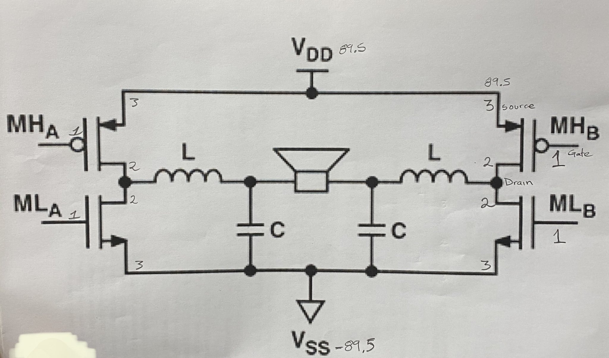

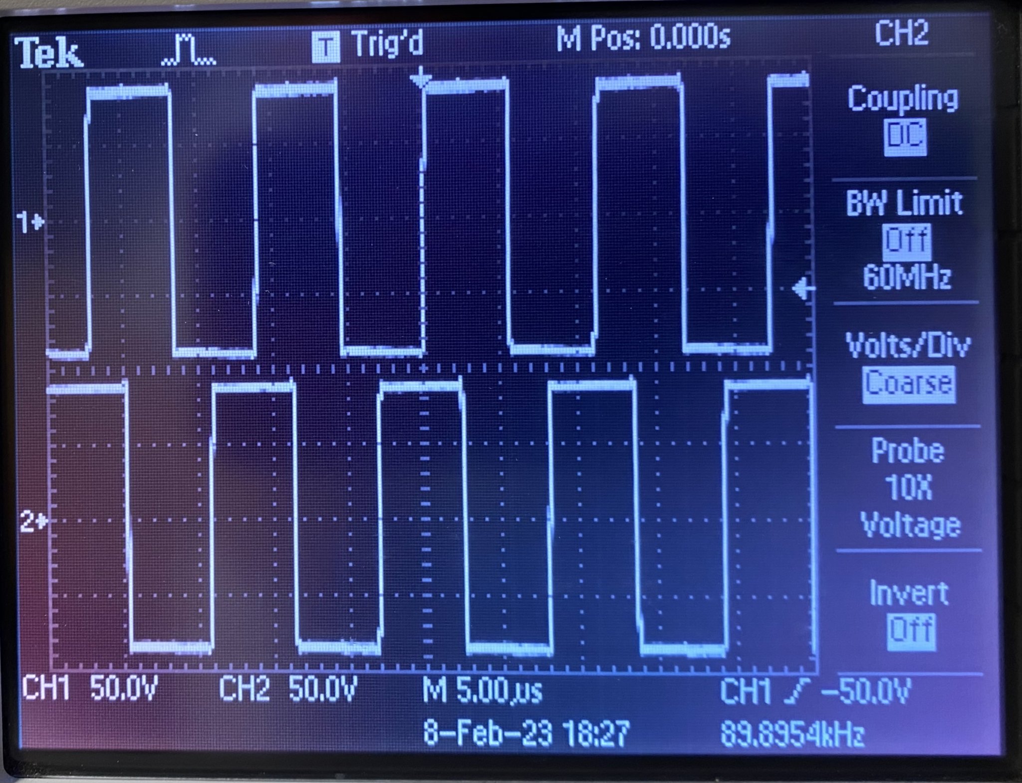

Is this normal, I wouldn’t think it would be since they are overlapping but I don’t have much experience with ClassD so don’t know if this is okay or if am missing something. Probes are on the Drains of each side of the amplifier. I have been looking at schematics and diagrams on how ClassD function so am getting a much better understanding.
The two sides of the amp are driven by two different driver boards which are not, as far as I know, synchronized. If that's true, the pulses won't be perfectly aligned.
Would that be an issue after the issue with the “no” output is resolved? Perhaps with all the filtering going on, it won’t matter but then again am new to this classD.

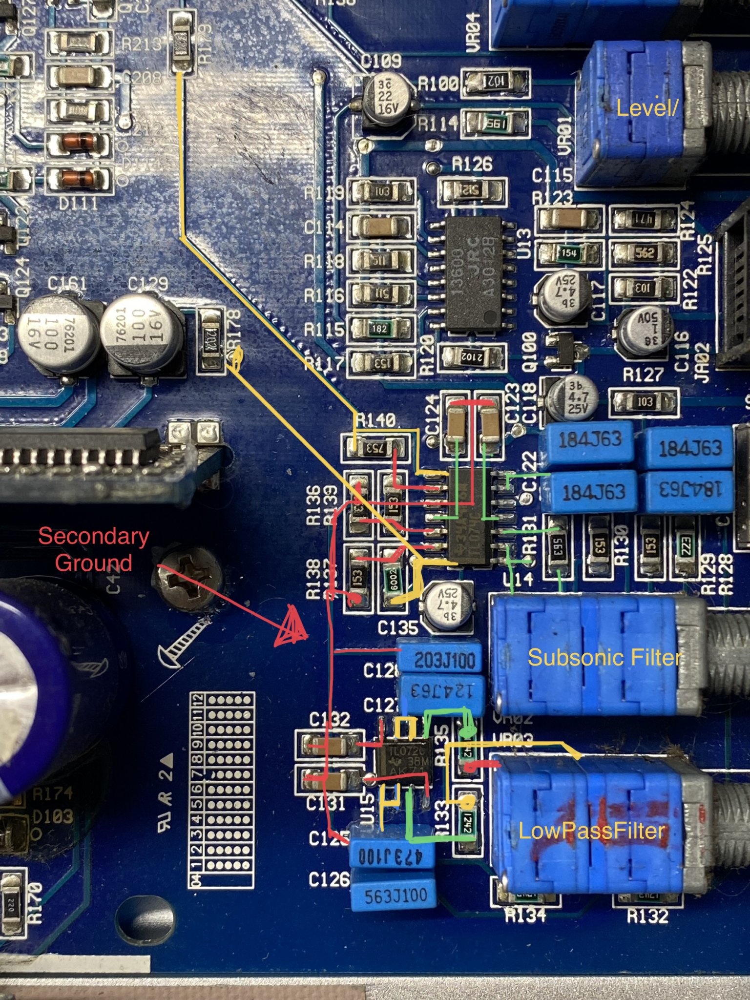

Okay looks like we are getting somewhere, I tracked the signal from the input all the way to the subsonic filter and low pass filter op amps. Then what appears to be a dual op amp that has fresh solder and a mylar capacitor that is easy to point out is not normal (all others are 100v this one is 63v). So appears to have been service at one point and this 072 goes to one side of a 074 inputs and it’s output goes to a resistor and capacitor in series before going to the driver boards as “IN”. By then the signal is 100mv and fuzzy compared to other filters.
For the op-amps in the audio signal path, is there one where you lose signal at its output compared to the output of the previous op-amp in the chain?
The 8-pin op-amp is a buffer. The signal in from the pot (crossover pot?) should be the same as the output of the op-amp.
Are any pins in the telco jack shorted together?
Are any pins in the telco jack shorted together? No.
All measurements are in mv. Input signal is 500mv 60hz sine wave.
U11 (First op amp after RCA’s)
1) 460
2) 245
3) 240
5) 240
6) 245
7) 465
8) 51. (This don’t look right to me along with 9 and 10)
9) 51
10) 50
12) 440
13) 440
14) 441
U16 (line out filter?)
1) 346
2) 63
3) 68
5) 50
6) 50
7) 300
8) 460
9) 460
10) 460
12) 40
13) 40
14) 234
U17 (line out filter?)
1) 374
2) 87
3) 87
5) 48
6) 47
7) 290
8) 465
9) 465
10) 465
12) 50
13) 50
14) 255
U14 (subsonic filter?)
1) 200
2) 200
3) 200
5)185
6) 190
7) 200
8) 100 (goes to 2K resistor then 100uf 16v capacitor before going to driver “IN” pin of one card)
9) 50
10) 50
12) 50
13) 48
14) 85 (Goes to a 2k resistor then a 100uf 16v capacitor before going to driver “IN” pin of other card)

Perhaps this amp works phase shifting both outputs in place of modulating the PWM signal. I read an old article from TI about a SMPS with 98%efficiency at 200KHz that maintain 50% duty cycle at both outputs (In such a case driving a transformer) but shifting tbe phase of both outputs with the error signal. Let me see if I can find it.
Edith: Found: slua287

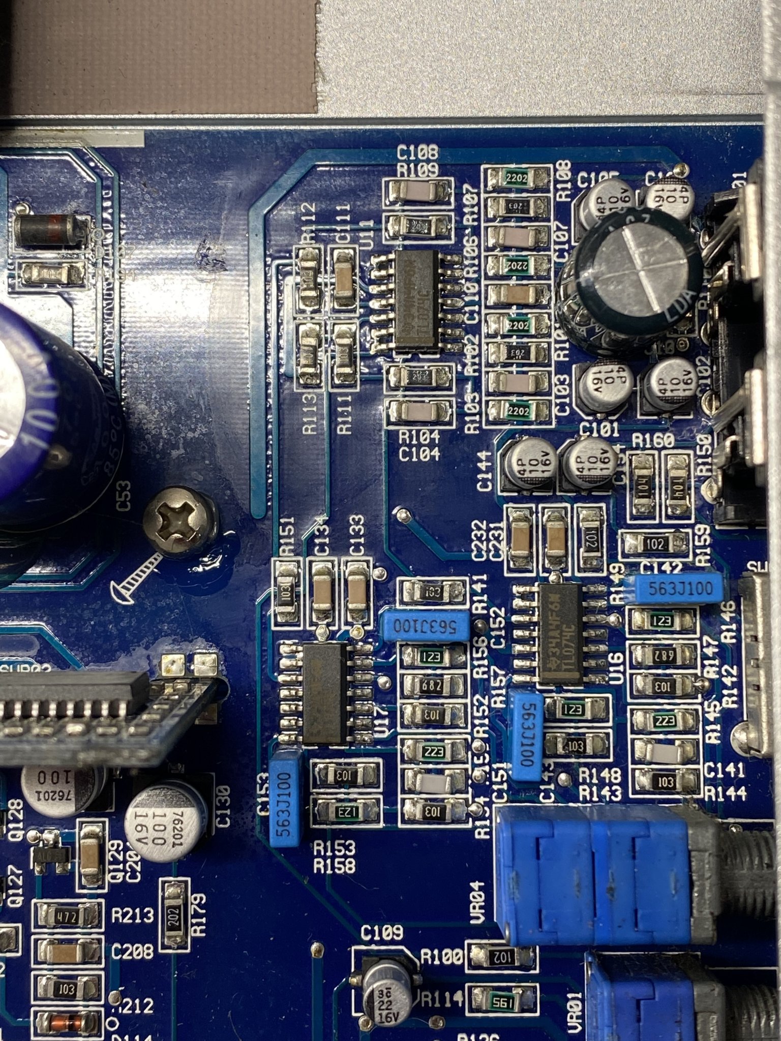

This may not be relevant, but in post #32, is that a solder bridge/ball between pins 8 and 9 of U17?
U17 and U16 have are identical, pin 8 and 9 and tied. Seems like if I put 500mv signal I get out about 750mv-1vAC on the output. I’ll check the R115 and report back today.
It seems to me to be a via under the IC pins.This may not be relevant, but in post #32, is that a solder bridge/ball between pins 8 and 9 of U17?
