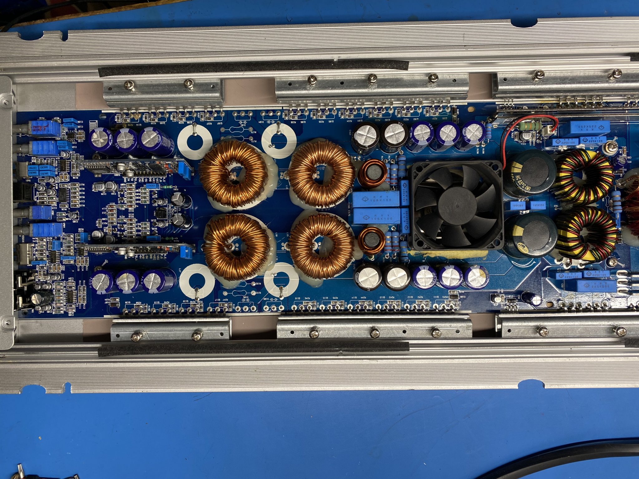

Crossfire VR4000D no output, 5a 13.6v idle, +/-179vdc rails….

Don’t know but both pin 1 and 3 of U11 are 0.9m. I am removing the board from sink and will replace the smd caps and check the large capacitors. Seems like the issue is in the preamp section, hopefully I can track it down. I really appreciate you pointing me in the right direction Perry.

Checking C109 it doesn’t read any capacitance. C109 read 460nf and has esr of 600ohm, safe to assume this may be part of the issue (hopefully the whole problem, fingers crossed)🙄

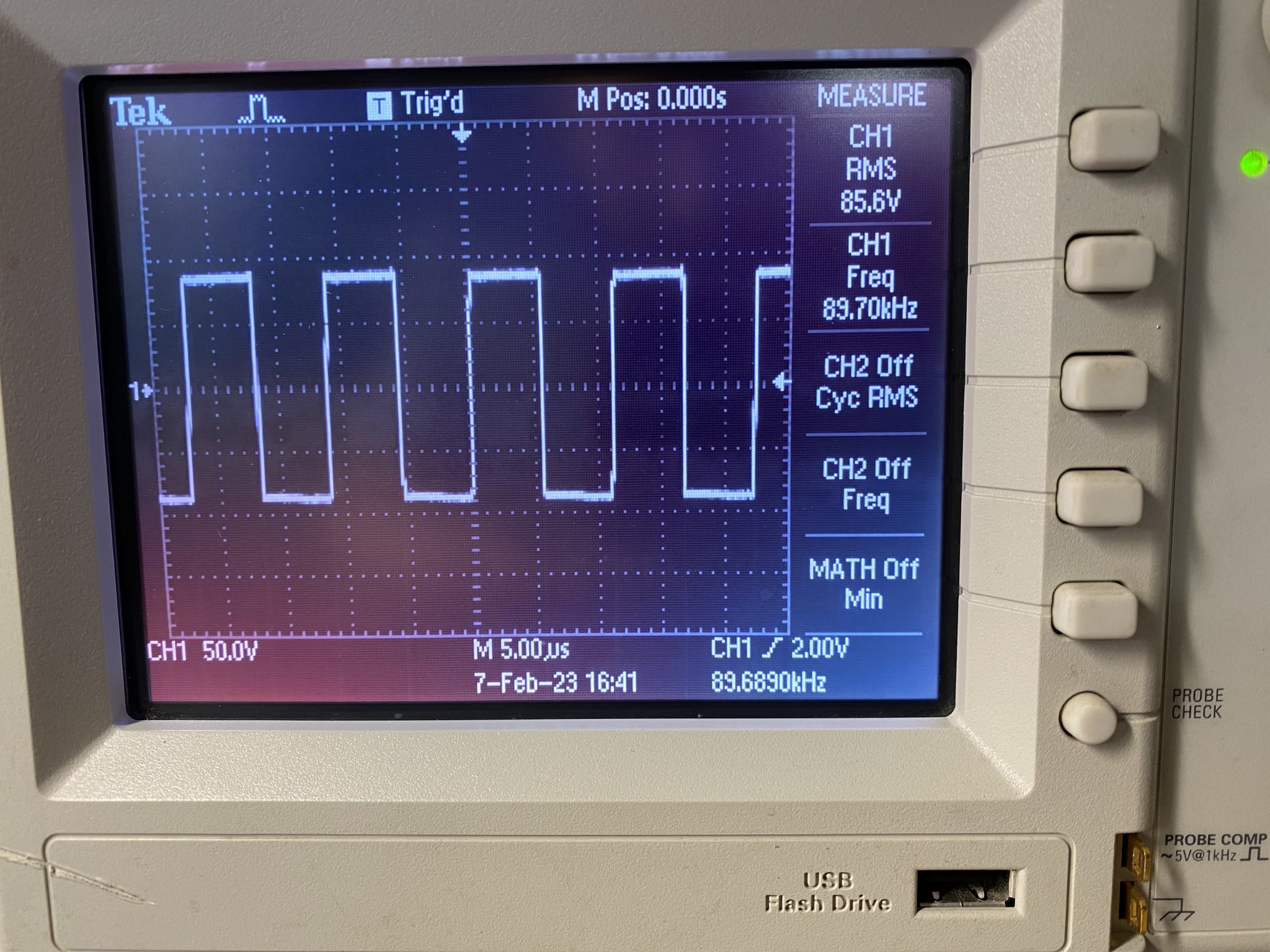

Well I pulled 5 SMD caps that were in the preamp/crossover/Remote section that read bad on my LCR meter, I also pulled a couple of the leaded large filter caps and the non-polar to test (which tested good). I used leaded for just testing purposes and powered up. YIKES I forgot the gain was set fully CW and was getting a weird buzzing noise in the output filter section, lol, measured the output and had around 170vAC (Yes severely clipping). Adjusted the gain to get around 110vAC prior to clipping without load.
I would like to thank Perry and goviboo (helped me as well and pointed out the bad caps on these amps).
