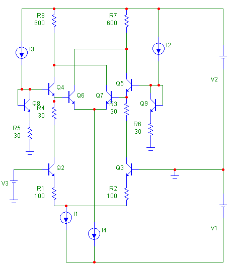

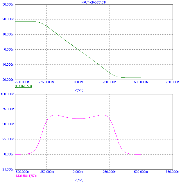

The main utility of these enhancements would be in situations where you cannot have high global loop gain
in audio amplifiers it is quite possible to keep the differential input V << 1mV with high loop gain - then the ordinary diff pair is linear enough to not be the limmiting factor
Gilbert curcuit
I1/2=I2=I3=1ma, I4=20mA
Quinn added series cascode after this

Thanks for all of your inputs! Let me ask, supose I were to make the cascomp in my input stage. I would make the regular differential pair with about 5mA of tail current and an active load to the VAS stage. For the inner differential pair (the cascomp circuit itself), is there any rule of thumb as to what its tail current should be?

They seem to be the same, at least for the case 1:n and n:1 cross-connected.
