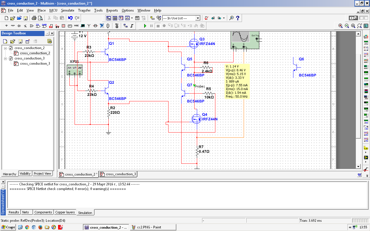

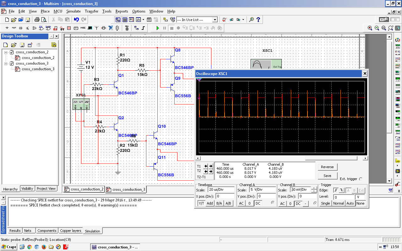

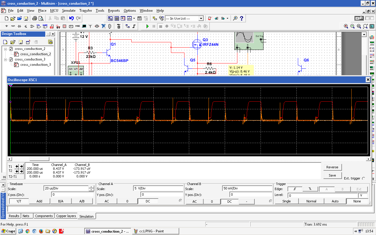

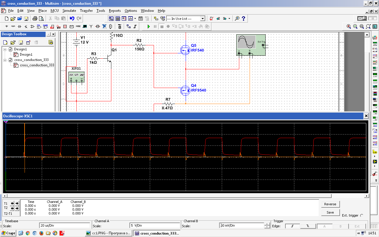

HI there, what do u think about this idea, is it worth ? 😛
3rd and 4th pictures are for comparing with totem pole and complementary pair.
another question: is little rounding @ the square equal to better quality signal ?
this is possible with higher value of gate stopper.
I know its more heat but if is connected to quality ;d
will become class BD or AD because here are no crossover distort ;d

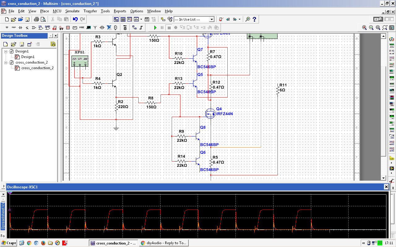

P.S. Anotherr question -> is this peak at 4th picture dangerous ? its only in the beginning and its short but.. dont know actually im afraid and concerned. I like the idea how both gate capacitanes kills each other. Charging, discharging itselfs.

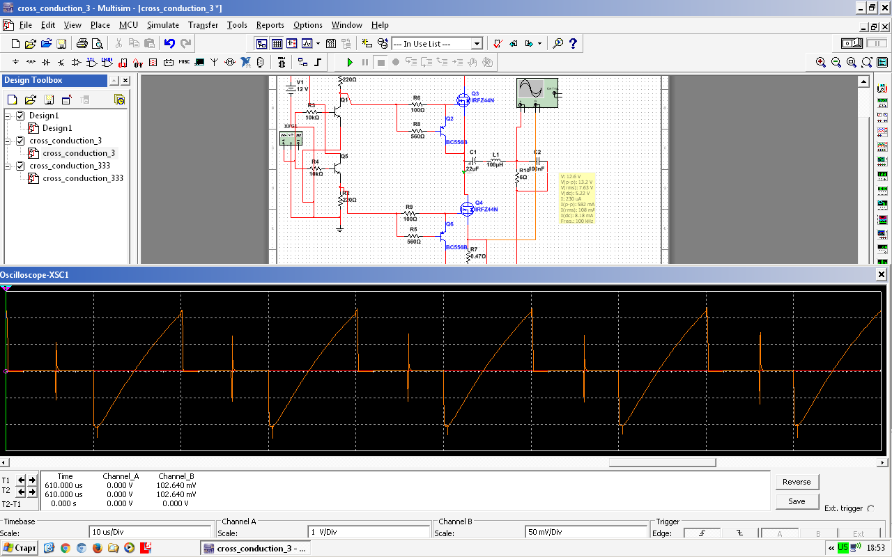

i have new idea like the protection in normal amplifiers.
note that the down side is disconnected. its because it works better without it.
P.S. i have made a mistake in down side, thats why it works worse
my only concern is that the amplitude is not 12v but 7.6v
P.S. 2 -> Corrected the error and works but its the better with one side only because its same

Nobody answers, because your approach basically dont reflect any practical reason, and your sentences are hard to understand, and your simulation results dont show details.
The current state of art reached about 1 ns of effective dead time at 50-100V and 10A, while your new idea shows about 1 us. If your goal is to actually build some good amp, then use integrated solutions, or other proven concept.
If you want to understand how different parameters affect sound quality, then you can simulate ideal circuits with controlled nonidealities. For example ideal switches paralleled by diodes with dead time introduced in the control signal. To see what it really cause you have to simulate more than 1 period of audio signal (for example 3 ms for 500 Hz), with significant time resolution (for example 10 ns if you want to see the effect of 100 ns of dead time).
When you know what dead time causes and understand how, then you can start optimising switching process, by more deeply analysing the switching waveforms and experimenting with different gate drives, etc...
Thanks for the answer, my idea is to stop cross conduction without deadtime use, i know its possible 🙂 Greetings.
i already made class d amp and it sounds very good but im using ir2111 with big dead time, i dont want to use any. (even with the big deadtime my sch sounds like class A :O )
you said the 4th is good but is this peak at the current in the beginning bad ?

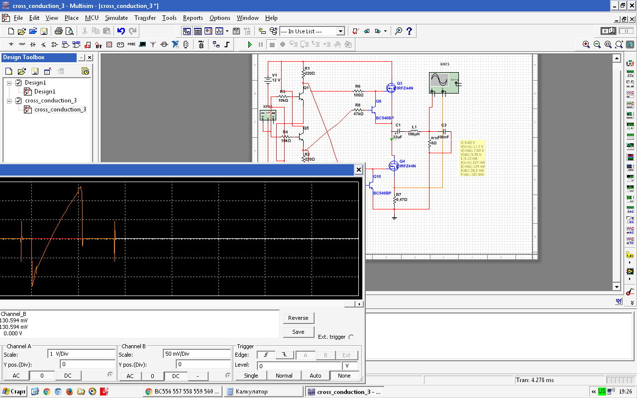

my logic is to discharge the gate capacitance when there is a current flow at the output (sensed via 0.22 resistors) and when both gates are 1.
now im thinking that theres no need of current sensing, only two transistors for discharging controlled by the gates.
this works, 100mv max / 0.47 ohm = 200ma MAX throught both fets
WITH NO DEAD TIME !
P.S. added 2nd picture, BETTER one, same but need less base current and less collector current for the dischargers 🙂

...there is again the topic how to define dead time..
The time while both gate drive outputs of a half bridge driver are low?
Or the time while both Vgs are below their gate plateau voltage?
Obviously the first does not apply here, because there is no such half bridge driver IC.
If you apply the second definition and start looking into short dead times or overlap situations, you will notice that the wording of dead time is misleading.
In fact both switches are performing an analog transition between low impedance and high impedance. When going to short dead times this transition is likely to become longer than the adjusted 'dead time'. At this point or when going for controlled overlap, the wording of dead time really does not make sense any more. Instead one has to examine the change of impedances and resulting currents & voltages during the few nanoseconds of transition. Besides the resistive change of impedance you will also have to take into account the heavily non linear capacitive impedances of the switches, including Qrr behavior and the inductor current.
Overall you will find a dilemma between achiving ZVS during idle, which is asking for a certain 'dead time' and on the other hand going for zero 'dead time' or even overlap which is helpful for low distortion (and reducing Qrr issues at high loads if your MosFets provide low enough Rdson).
In order to get a valid picture of your switching method you always should examine both transitions (Hi2Low & Low2Hi) at idle, at most positive and at most negative current.
In any case the MosFets do not care how you generate your gate drive timings. They just act according to the timings and drive impedances with which you feed them. So you are of course free to consider an event driven BJT timing machine instead of ns counters or delay gates or half bridge drivers or any other method.
Well, as Pafi already mentioned: In the last shown solution the upper MosFet is not fully switched on, but more operated as a source follower. When high positive load currents have to be delivered Vds will not get close to zero and the device will show undesired conduction losses. Furtheron the output voltage of the half bridge during Hi-state will strongly depend on the load current and this translates into distortion. So you really should spend a gate drive, which can lift the gate higher than the drain.
P.S:
Don't forget that component parameters will vary with temperature, which becomes of specific importance when your circuit relies on the storage times of BJTs which are driven with high impedances.
I tried this real life (mentioned in post #6) and it works better than ir2111, square wave is not rounded at all, and the sound is awsome.
with ir2111 square is little rounded,
with irf530+9530 the result is not very good. (not beautyful squarewave)
only problem i cant figure out is that my amp is very quiet.
im running it with single supply 12v, but this is not the problem since its quiter than a tda2003.
the duty cycle goes min and max very good, this is not the problem.
the mosfets gates are 0-12V -> good low Rds
Is it possible to be the filter?
Iam seening 100khz at the out and its larger than the signal.
I am using 1uF decoupling, 100uH and 47n to ground because i have only these values.
I have another inductor but dont know its value.

Yes!
I solved the problem !
Everything works fine now.
It was the 1uf decoupling cap.
It was before the LPF.
I removed it and added 2200uF instead.(this time after the filter).
Doesn't make sense to me but it didn't worked with it before the LPF ??
There is 100khz PWM and the 1uF corner freq is 27kHz. 😕
Its great its working not quiet. Im very glad. 🙄
