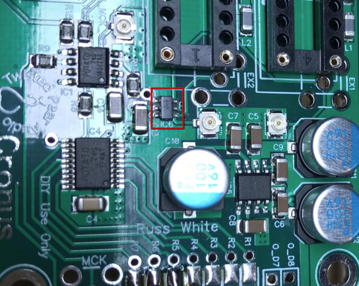

I am troubleshooting an issue I have with a Cronus and am a little confused. I measure 1.5v on the clocks supply instead of 3.3v, which I was able to trace back to ic5. I isolated pin 2 and confirmed it’s putting out the wrong voltage. This is an ADM7151-04 reg and according to its datasheet it’s output is set via 2 resistors across pins 5,6 and gnd. But I don’t see any such resistors on the Cronus. Without any resistors it will output 1.5v according to the datasheet.
Only explanation I can think of is that the wrong part is installed. Anyone else seen this? Anyone have the same reg in their Cronus and is it working for you?
Hi, could you check the orientation of IC6? I've attached the picture of my Cronus which had the same issue, unitl I've flipped this IC the other way around.
The IC shown in the picture is in the WRONG orientation.
