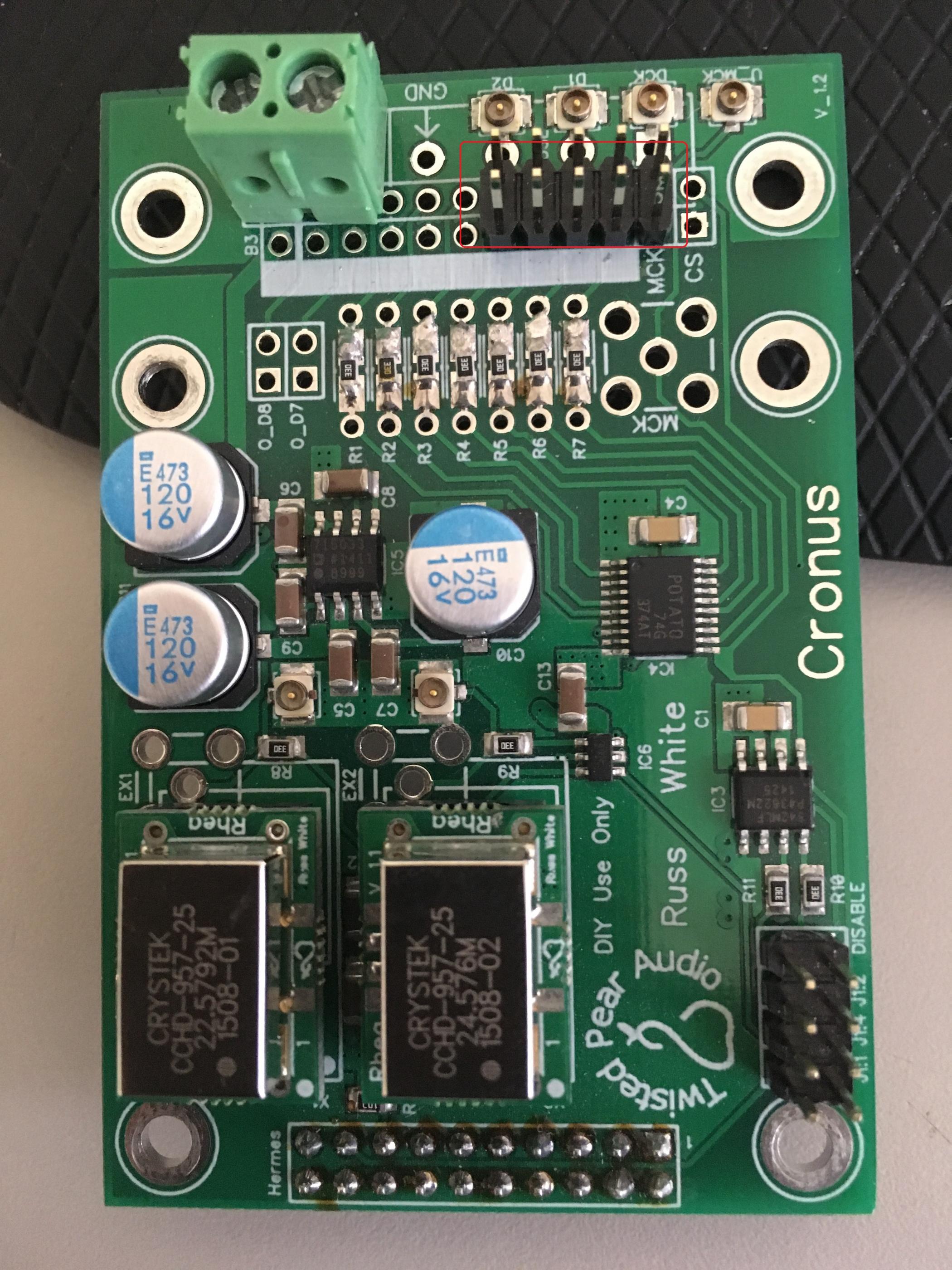

I am trying to find documentation on the various pinouts on the Cronus. Can someone point to the location if one exists. If not can someone help identify the pins for me to pull DSD with mute from the following images, especially if it is possible for pulling it from the jumper pins.
The pin out is indicated on the very first page - Can you explain what you are trying to do? DSD and Mute? From what? Those are likely not even signals you would ever want reclocked :)
If you are referring to Hermes Amanero - it does not transport those signals as data because our DACs don't need them (they autodetect DSD) or they are used for other purposes - like clock selection (mute is clock select).

The DAC in question is DSC 2.5 and 2.5.2
I am planning to use BBB+Hermes+Cronus --> DSC 2.5/2.52 using Botic driver.
If I use the Amanero that I purchased via TPA the pinout are:
3 - DSD1
4 - DSD CLK
5 - DSD2
6 - MCLK
7 - DSD on
11 - Mute
In the first post I see the pin outs for Hermes and B3 but confused about Cronus. The signal that I want to pull off Cronus are DSD1 (D1), DSD CLK (DCK), DSD2 (D2), MCLK, DSD On and Mute but I cannot seem to identify the pins in question on Cronus.
Cronus is agnostic to such signals... Hermes Amanero (which was designed really for ESS DACs) uses the mute signal for clock select (48khz or 44.1khz family) and DSD select signal is not used at all - so you would need to change the amanero firmware and/or pull those signals from the amanero itself. You could of course use cronus without the hermes - in which case you could map any of the data inputs to the signal you want and it will be present of the output - just not isolated.
