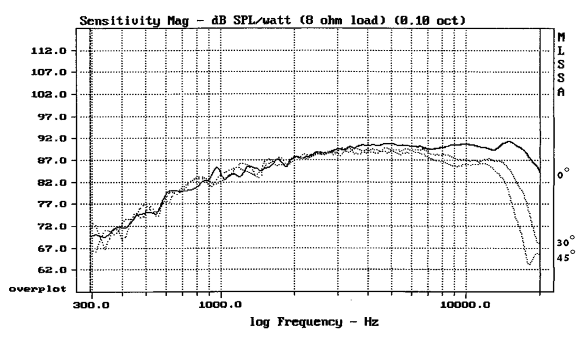

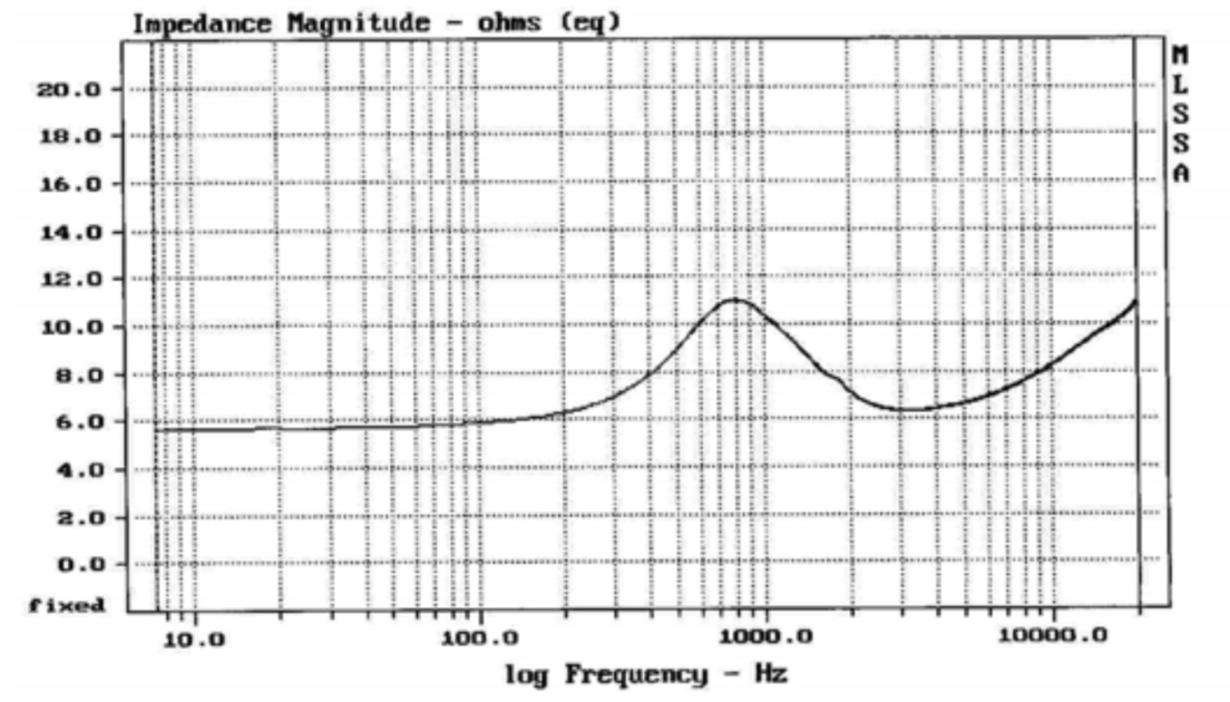

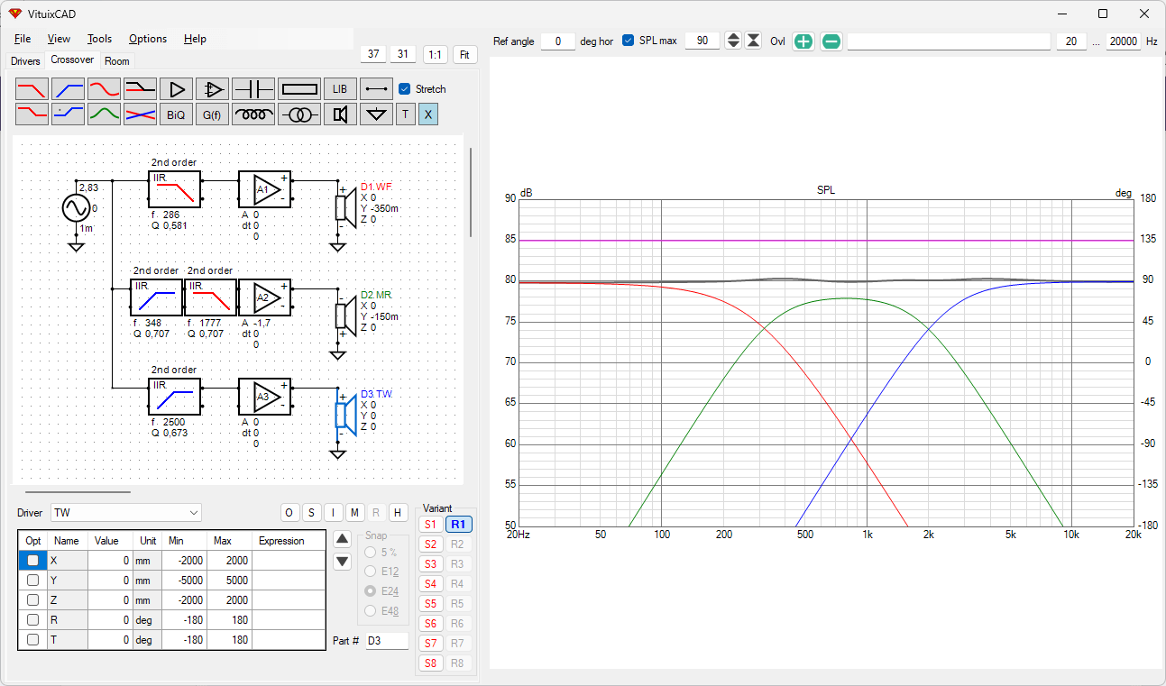

The one on the upper left side. The origin of the coordinates is the TW axis.What icon generates the source for this software?
Below you see an example of an active 3-way: if you click on the "LIB" button and check "active" you will find more examples.

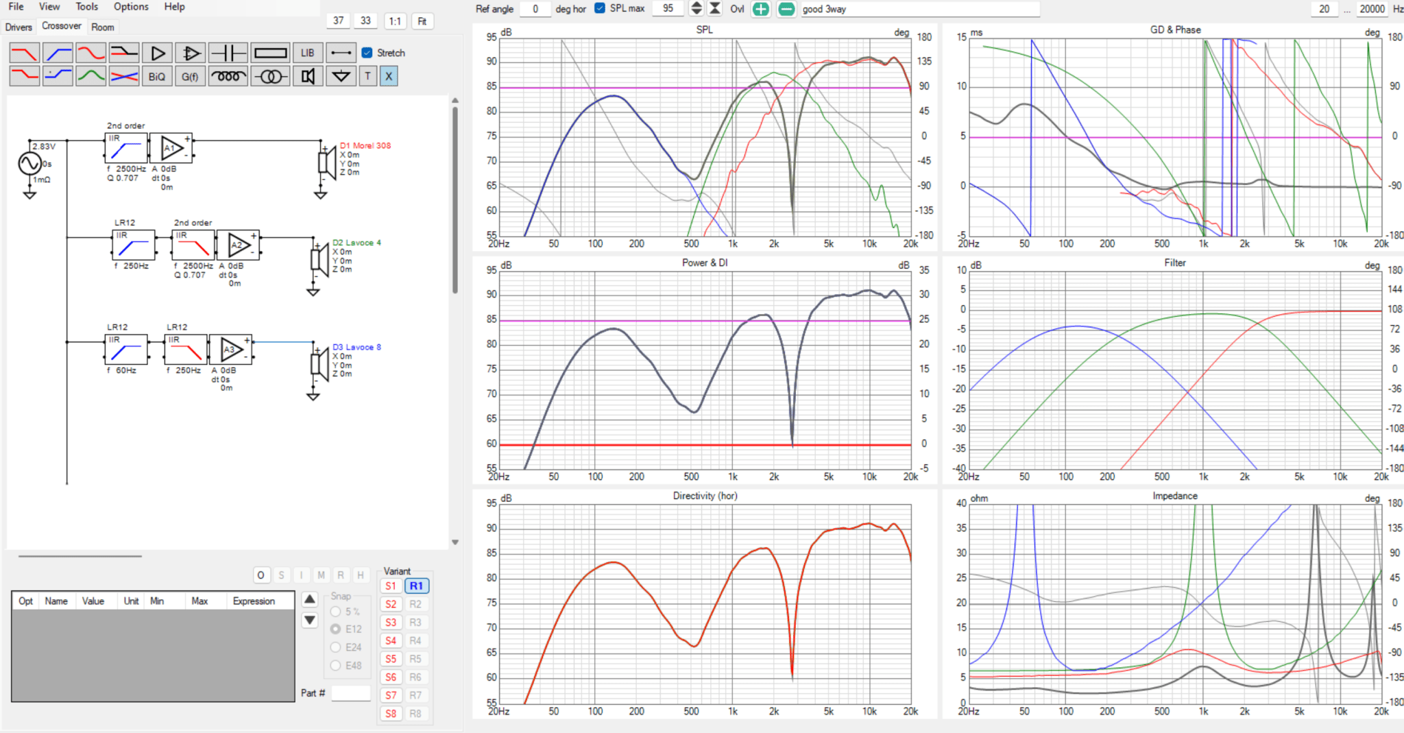

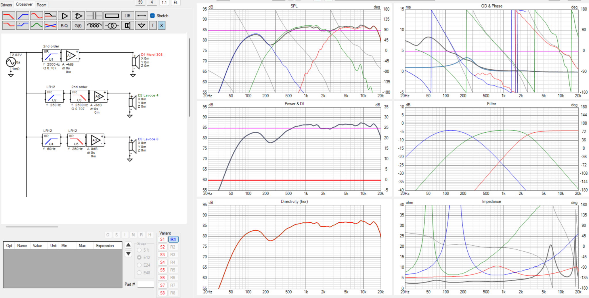

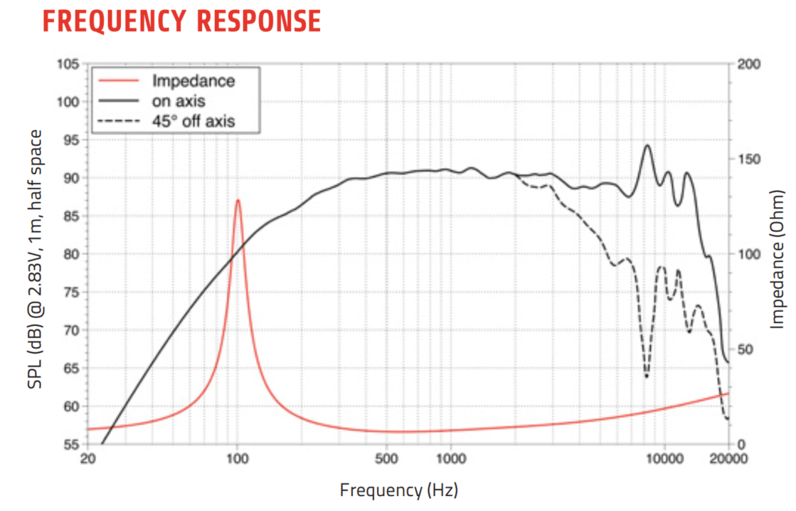

Morel 308 tweeter
Lavocce 4 mid
Lavoce 8 woofer
Lavocce 4 mid
Lavoce 8 woofer
Am i correct that either the mid and/or woofer need be replaced to have a better range given the dip at 300?

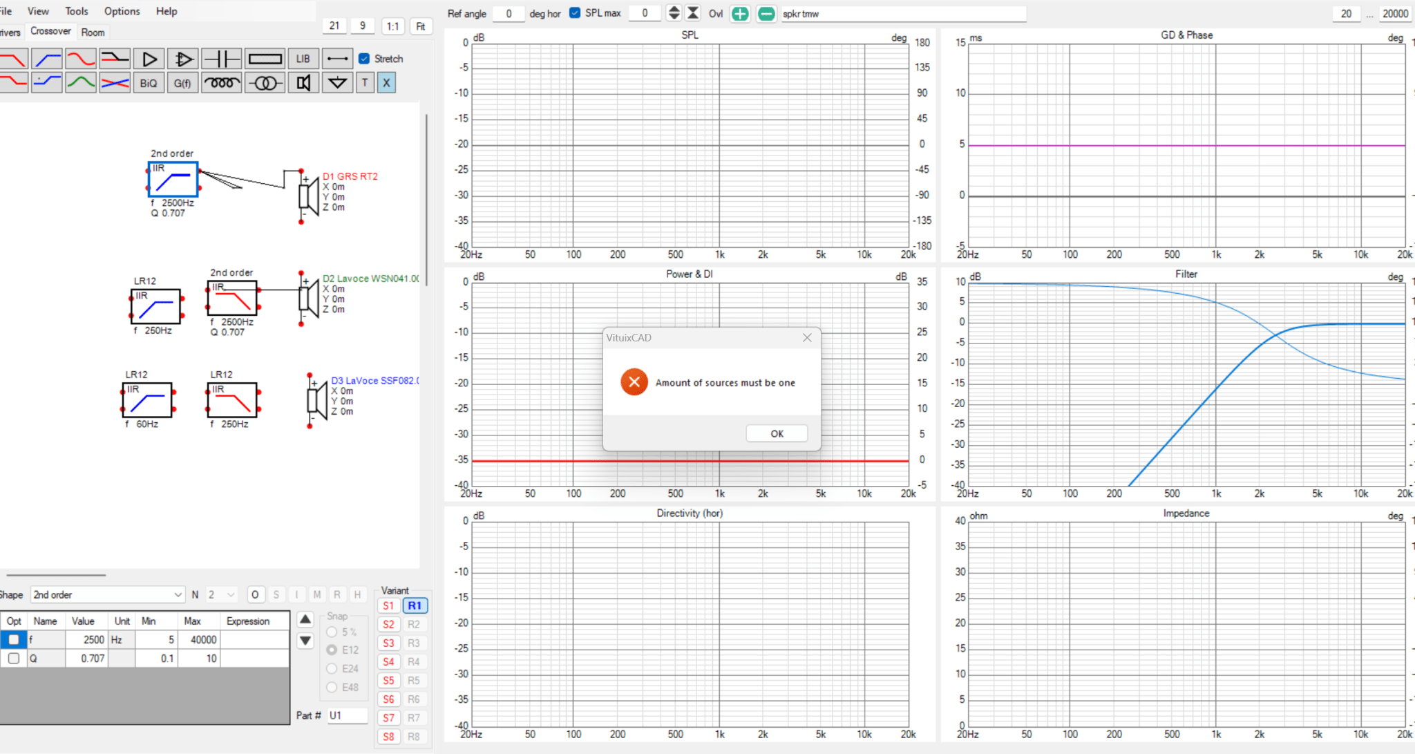

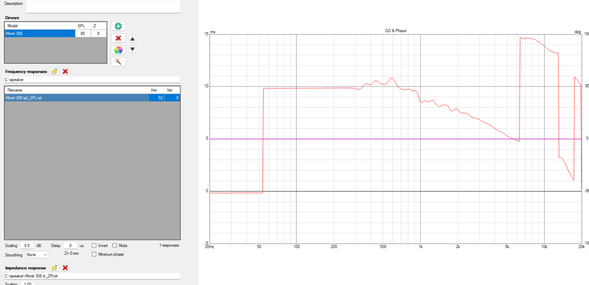

First you will need to design a baffle shape and an enclosure volume for each driver (besides the tweeter, if it isn‘t open back). This can be done in Tools -> Enclosure in the menu. You will need to ensure the correct T/S parameters for each driver are accounted for. Then you will have to merge the enclosure responses with the frequency responses. Then you need to simulate a baffle, like how I explained here.
https://www.audiosciencereview.com/...th-coax-and-woofers.49055/page-2#post-1762431
The woofer may be fine in the correct enclosure on the correct baffle. This is the work you will need to do.
