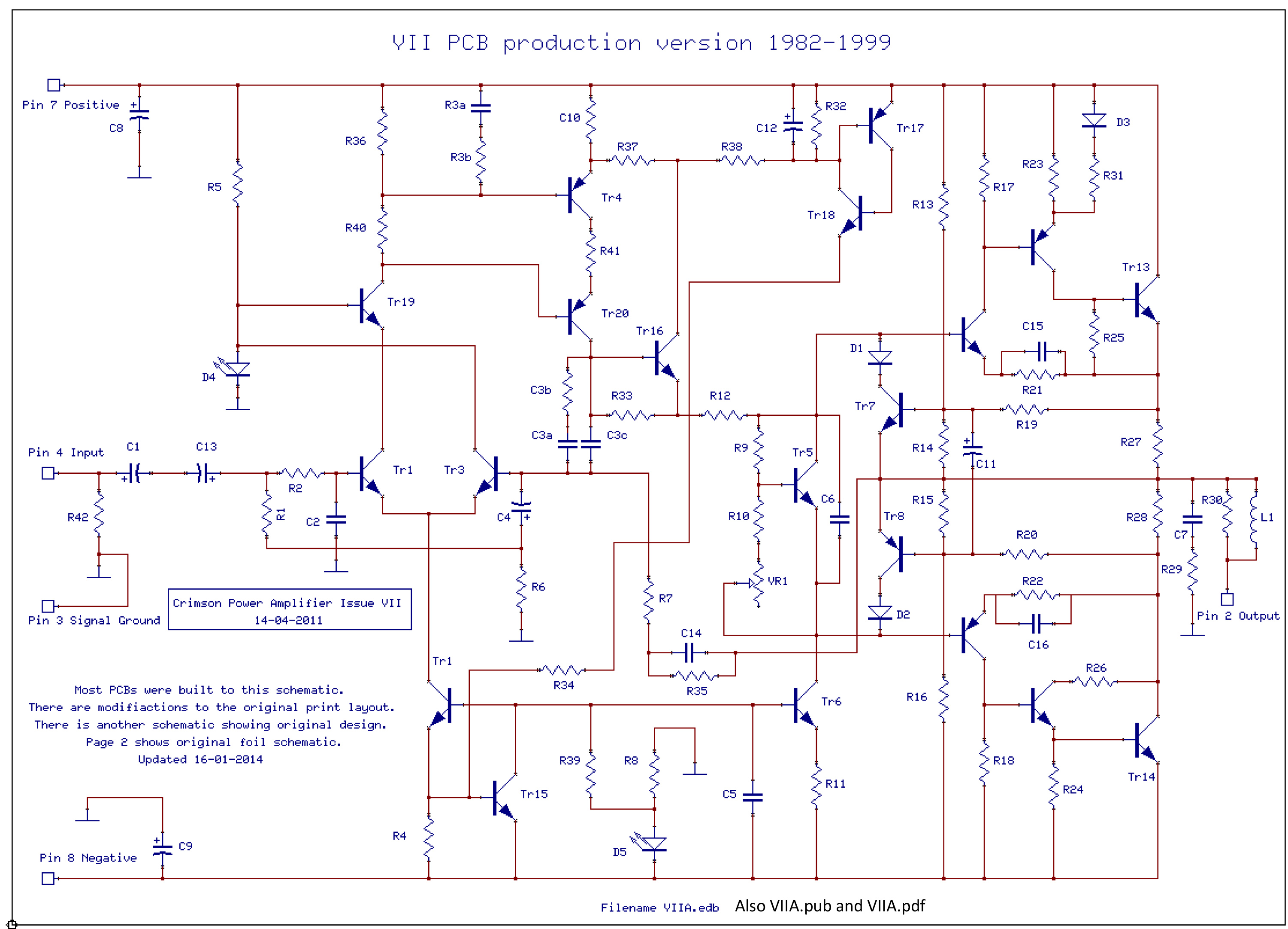

I have created a website with most of the important Crimson Elektrik schematics and info. Let me know if anything is absent and I shall add it into the site.
See https://brianpowellaudio.co.uk/

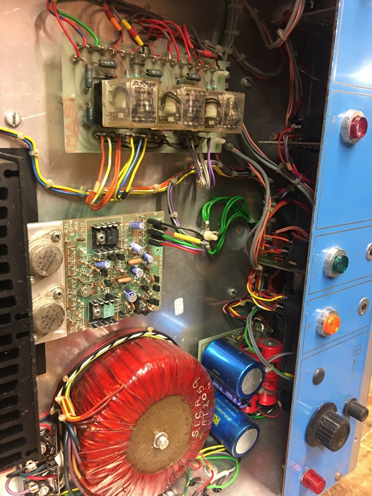

I just bought another westrex cinema amplifier but this time with a issue 3 module. With all the other boards inside it's tempting to build a stereo preamplifier from them. They come with HY60 modules too, for the booth. All the power supply caps are suspect after all this time. The previous, issue 5 module works perfectly straight out the box so I'm hopeful for this one.
I am often surprised how many 80's amplifiers come back to me and the reservoir caps are still 100%. Generally they test good on correct capacitance, ESR and leakage. Most owners do want them renewed however, 40 years is pushing your luck with aluminium electrolytics. Reset the the bias and renew all the electrolytics on the PCB. Don't up the small rail decoupler values just replace with preferably 100V ones. I have issue 5 PCB in my spares. Issue 3 can be converted to issue 4. The XO distortion is better on issue 4.

The CE module data is on my website (search Brian Powell Audio). Please contact me if you have a specific query.
