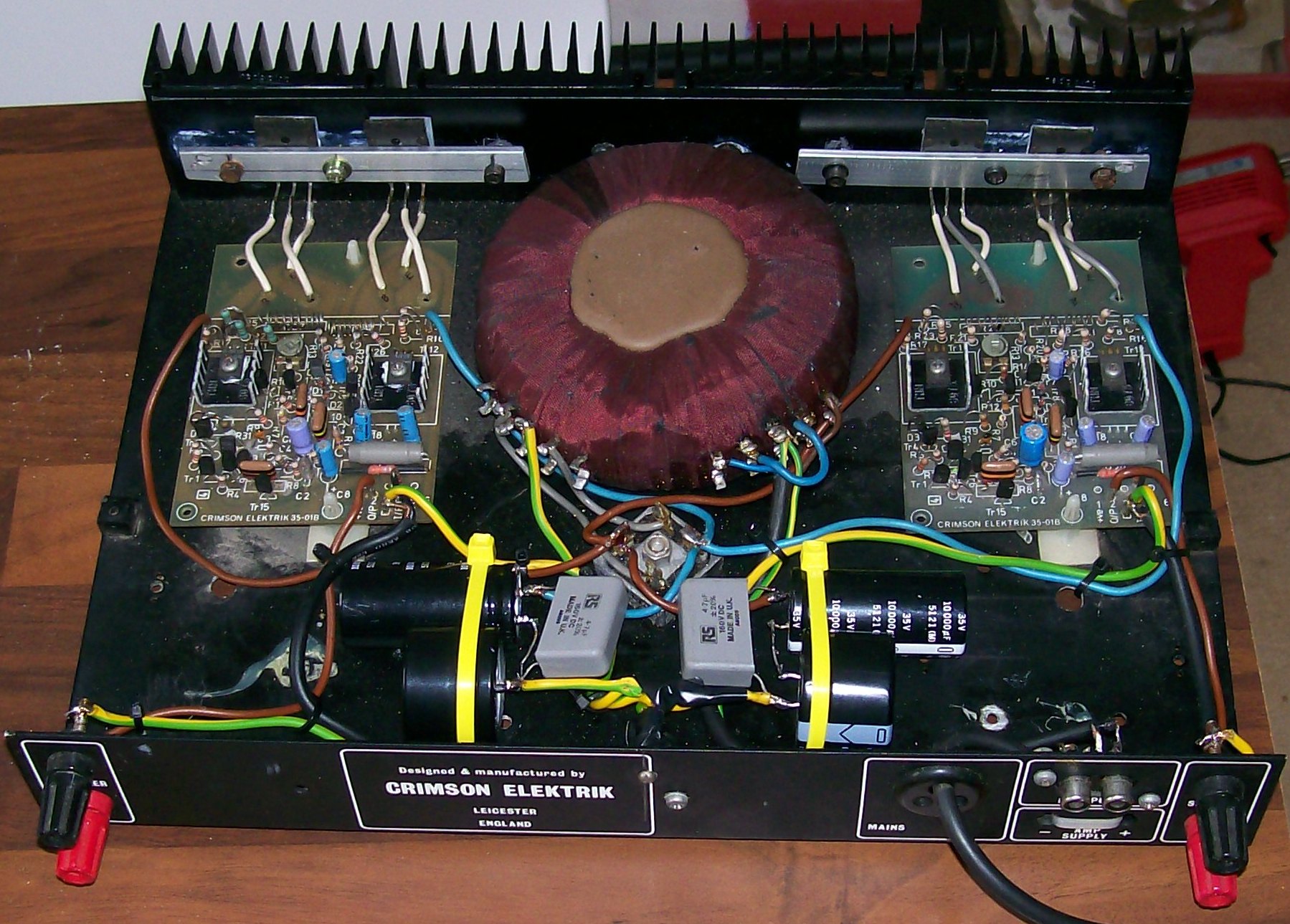

Which model is to see in the attached jpg files?
On the PCB is to read the number 35-018.
Doesn't look anything like my CK1100 with 1704 modules which have TO3 case 2N3773's on the PCB on a thick aluminium right angle mini heatsink which bolts to the main outside-world heatsink.
crimson elektrik 35-01b

The Crimson 35-01 PCB had several different variants (issues) you can identify this from the number in a small square box on the PCB printing. Most were issue 5. I have an old copy of issue 6 which I have scanned and I'll upload it to my webspace in the next couple of days and repost with a link.
Most repairs can be done with a multimeter on the junction range and by spotting burnt components. Driver transistors need to be low capacitance high Ft types and a scope is needed to check there is no oscillation. Often the zobel resisitor usually R29, value 8R2 is open circuit. The wirewound resisitors in the output are 0R18 but should only be replaced if unusable as they are inductive and help with output stage stability. Diodes in the collectors of the protection transisitors were usually OA47 and can be replaced with BAT85. If the power devices are removed make sure that the sleeved bolts go back into the same holes as shorts to the heatsink bracket can occur. A current limited PSU is esential for testing.
If all else fails I do PCB repairs and updates and they are very easy to pack and post.

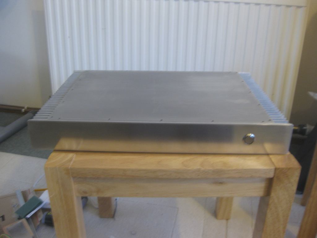

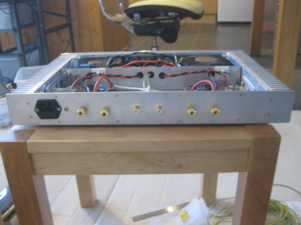

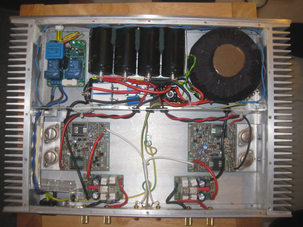

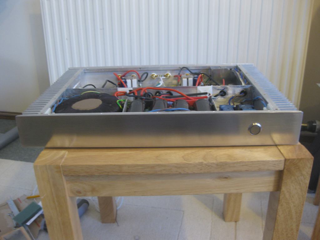

I have just managed to screw up one of my power amp modules. It's a version 3. I had completed moving them to a new case but I forgot to put one of the earth leads on. Had obviously powered it up before I noticed and didn't discharge the capacitor before I tried to fit it. When I was fitting it the lead went under the board at the front left and earthed one of the components which I heard through the speaker. Now the sound through the right speaker is about half the level of the left. I presume i have shorted on of the transistors around Tr15. Anyone have any idea what to replace. Pictures of the new case should be attached.
Hi
Crimson amp rebuild
Decided to do some checks last night. Swoped the speakers leads round and realised that there was nothing wrong with the amp and that the right speaker was the problem. Checked the resistance and one of the speakers was reading 1.5 ohm's. It looks as if one of the speakers units has gone. They have a 5 year gaurantee so hopefully it will be replaced.
