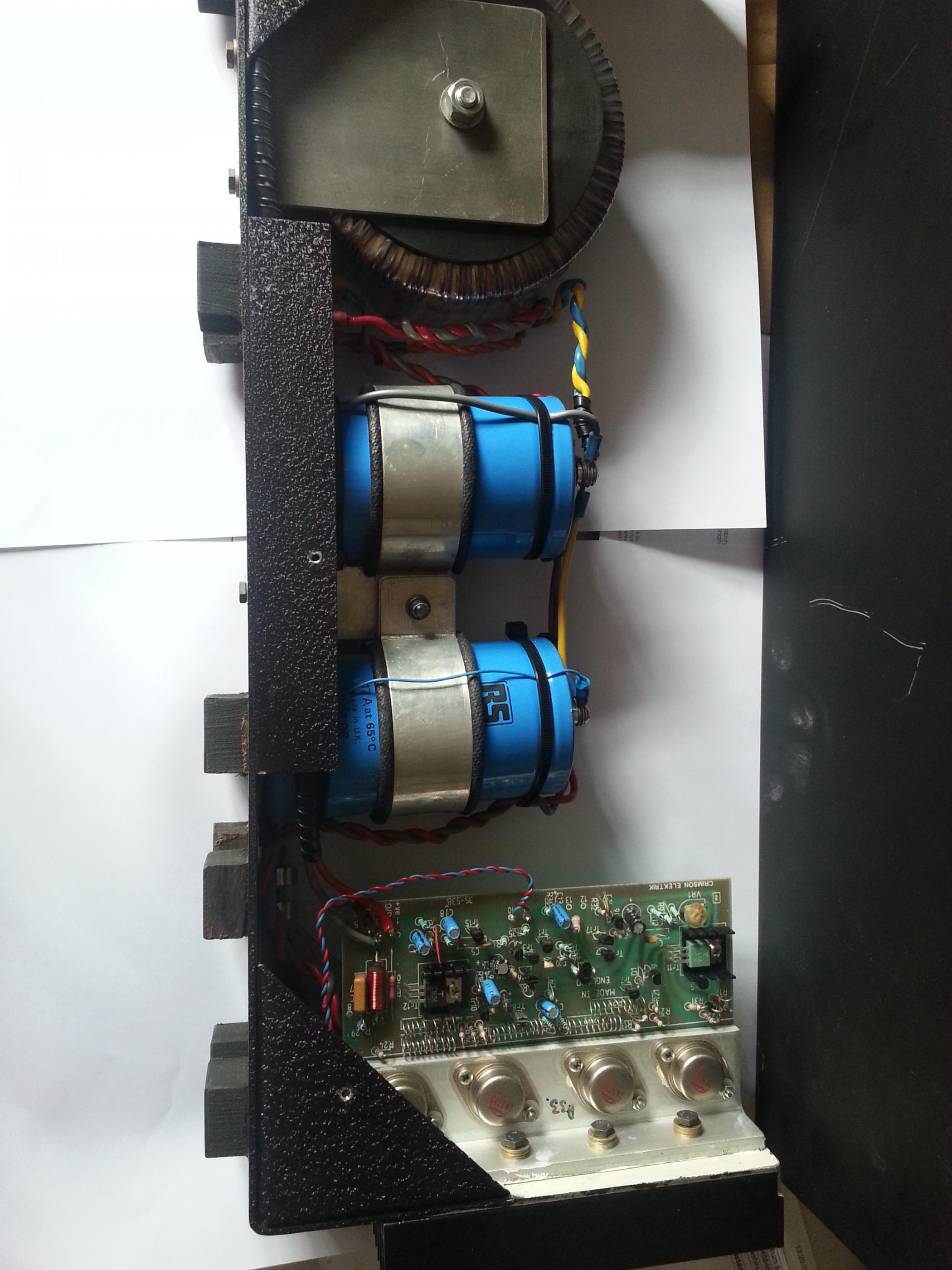

I have just re-discovered my old Crimson set up. This consists of a 510 preamp and 2 x power amps. I built the power amps in 1978-79 and I have no idea what power they supply.

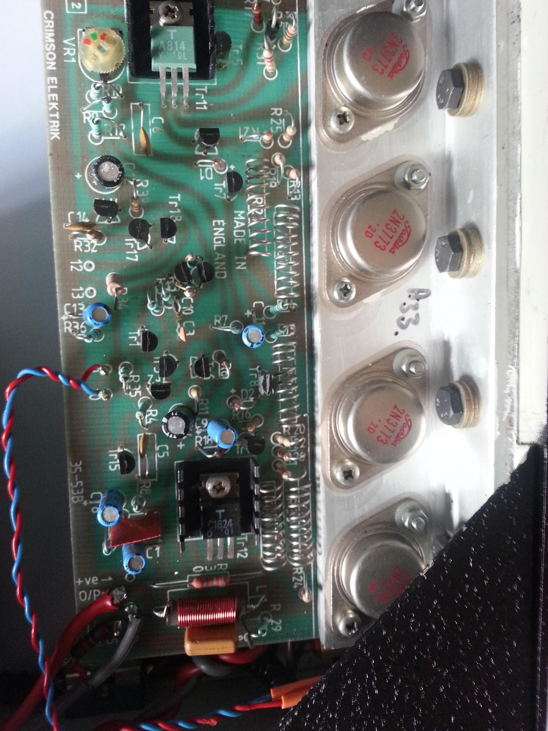

The PCB's have markings on them but I cannot trace any info' regarding output and resistance. The markings all start with 35-53. On the back of the PCB there are 2 x marks, one is 35-350 or 35-35"O" and the other is 35-53A. On the component side the marking is 35-53B. Does anyone recognise these and could you supply the output details.
My wife has just purchased 2 x Linn Isobarik DMS speakers for me, I have had to wait over 25 years for these, and I would love to play my music through the Crimson system. Are these compatible with the Crimson??
Lastly. I have become lazy in my dotage and most of my music is in MP3 format on my PC's. These are powerful machines with good audio output. Would it be feasible to play the MP3 through the Crimson and the "Bricks"???
Any help will be GREATLY appreciated.

Can you put up a decent picture of the board? Peter Powell of Crimson is still about and may see your post.
I'm not sure the board markings will definitely identify the actual amp module as a I suspect the '35-53' is just a pcb number and the same pcb was probably used for most of the different amp modules, with some different component values. The size of the transformer and the output voltage taps being used may be more useful to work out the output power.

If they are the boards from late 70's/early 80's then they are probably 100w in to 4ohm (I had a pair from that era. Wish I still had them. A recap and new PS and they would be fantastic) Should be powerful enough for the 'bricks.

I found here http://www.mickandviv.com/pfm/DMSHiFiforPleasureReview.pdf that the Linn Isobarik DMS is rather low impedance - 4 Ohms or less. You can hook up the Crimson's and you'll get sound out of them and it shouldn't cause any damage as the Crimsons are load line limited. Really you need the 4 ohm modules to drive those speaker, CE1004 or CE1704.

The second pic is attached.
In reply to the knocker. I do have all my original music on CD but as my family grew, 5 kids, I had less and less room for my music gear. However I could play them through my headcans, PC speakers and mobile phone. This meant transferring them all to MP3. I used the highest rating I could and, to my untrained ear, they didn't loose any of their appeal.
Hope the pcs help you guys to solve my dilemma.

2pr 2n3773 as the output stage !
I wonder if these are CE3004 PCBs?

I think AndrewT is right. 4x2N3773 makes sense for CE3004, the CE1708 only has 2x2N3773. If any Crimson amp can drive the Linn Isobarik's then it's the CE3004.
Are you sure you built them in late 70's? I thought the CE3004 was rather later, certainly they are not listed in Crimson's 1979 price list.

At the time I was employed at British Aerospace, hence the great PSU components, and I finished there in 1982. The PSB's were purchased prior to 1981. Can't be more exact than that I am afraid.
The PCB is a Crimson CE3004. It can drive loads down to 2.7 Ohms so can drive pretty well any speaker. Intended for +/- 60 V it can deliver up to 250W into 4 Ohms depending on the PSU. The sensitivity is 775mV. This PCB has a date code of week 33 of 1983 and would benefit from new electrolytic caps. I do service work on theses PCBs if required.
I am attaching a link to the schematic:- http://homepage.ntlworld.com/bepowell/schematics/3004.pdf

Thanks for the information, I know what I have now. I do remember being told that these PCB's would drive inefficient speakers, and that seemed to be important at the time.
At this stage of my life I will not be attempting any repairs myself. Back in the 80's I built these as I was doing an electronics course for a specific need at BAE. I have read other threads and all the discussions regarding Caps, Sensitivity, etc., are over my head I am afraid. My Audio/Electrical knowledge was meagre in the 80's and now it is none existent.
Would you advise renovation prior to connecting these to my bricks? I am an impatient man and can't wait to hear the music through a proper medium.

These are Crimson CE3004 PCBs. They have a load line at 2.7 Ohms plus any value of series reactance so will drive anything I know of. The schematic is here http://homepage.ntlworld.com/bepowell/schematics/ Do make sure that there is no DC at the terminals before connecting speakers!

This is the close up of the PCB.
