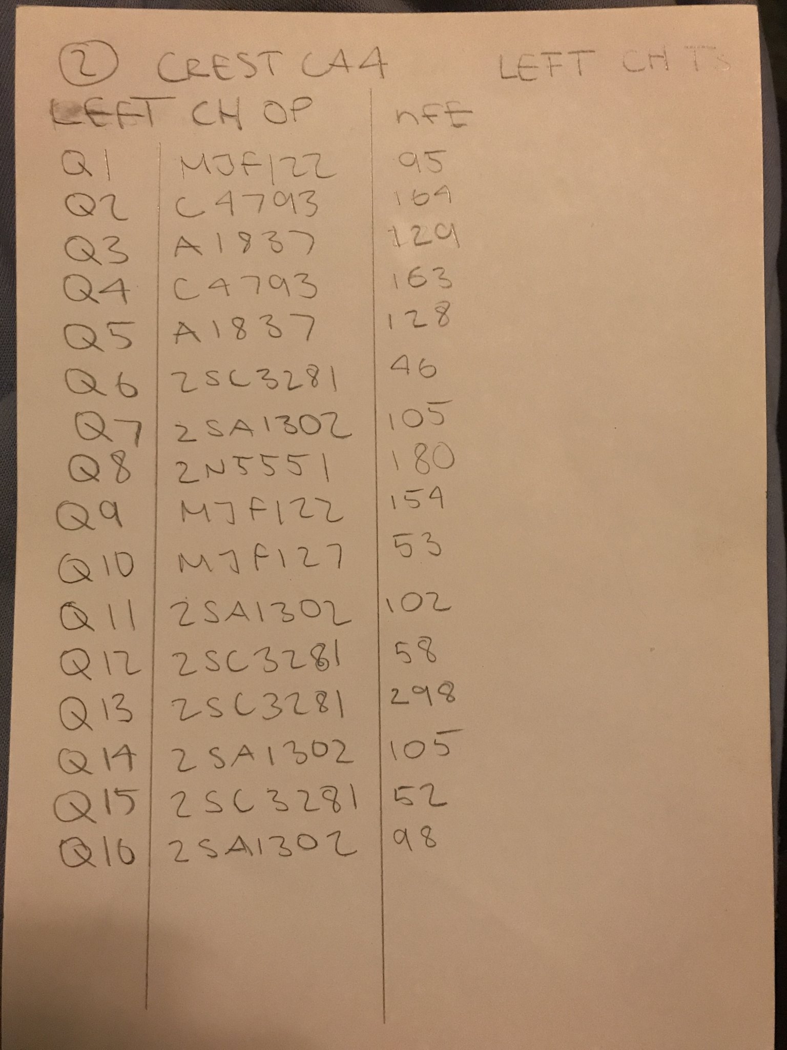

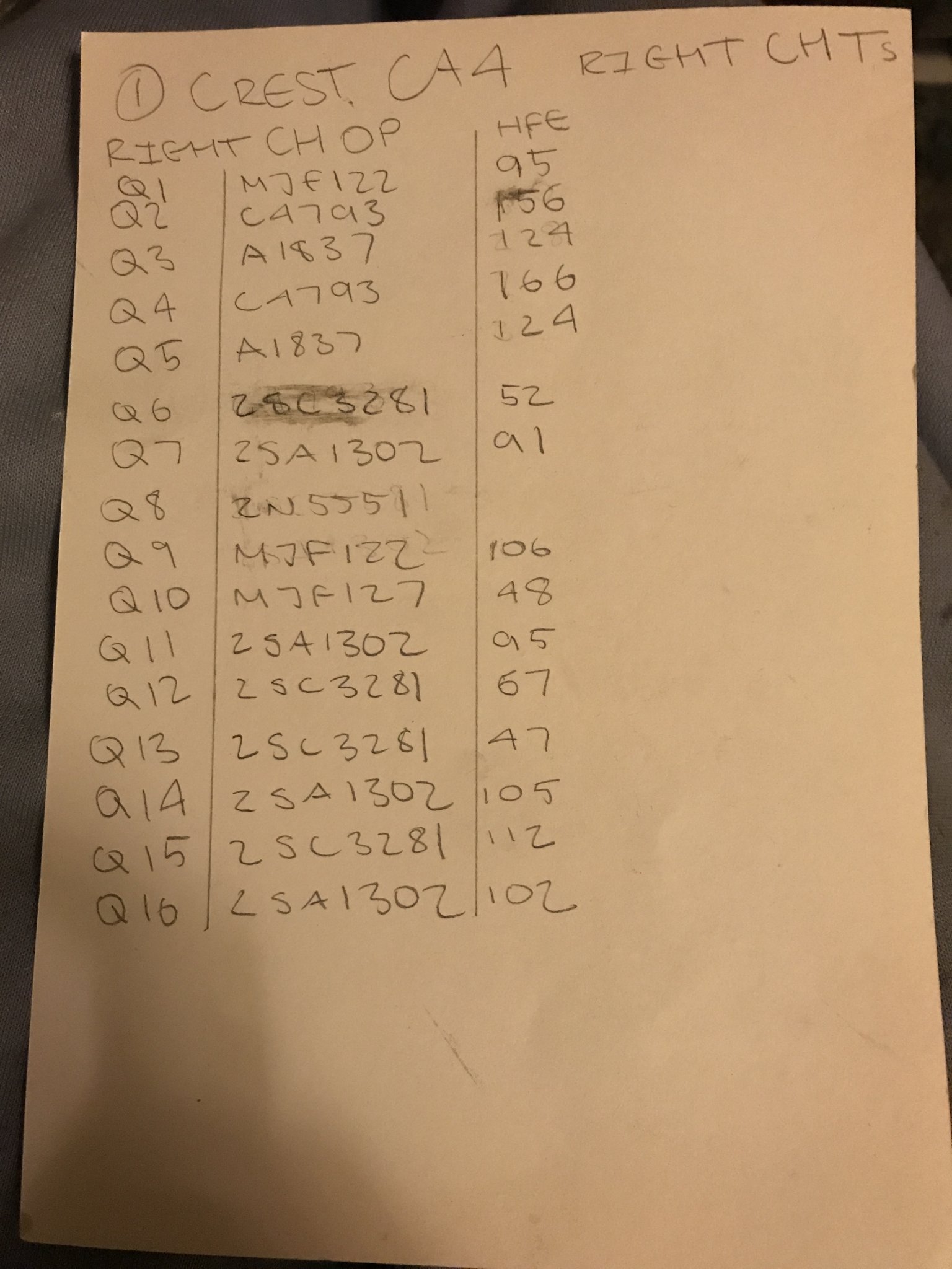

Update.
Took the boards ,heat sinks apart and cleaned off all the old grease. I put them all back on ,dry ,in the same place. So I don’t change anything.
I’ve got some replacements coming for any that are out of range or bad.
I managed to get some originals.😊
It’s gonna be one amp at a time ,one channel at a time.
A capacitor in my multimeter burned up when I changed the battery ,so I’m using an analog one now. A TMK MODEL 500.
The results from testing all the Transistors on the output boards.
With an MK-328. The negative side seems to have been affected by something as they’re mostly low readings. One is very high. Even the MJF127’s are low.
Shame I don’t have a curve tracer ,I could have this singing like a Bird. 🎵🐤
