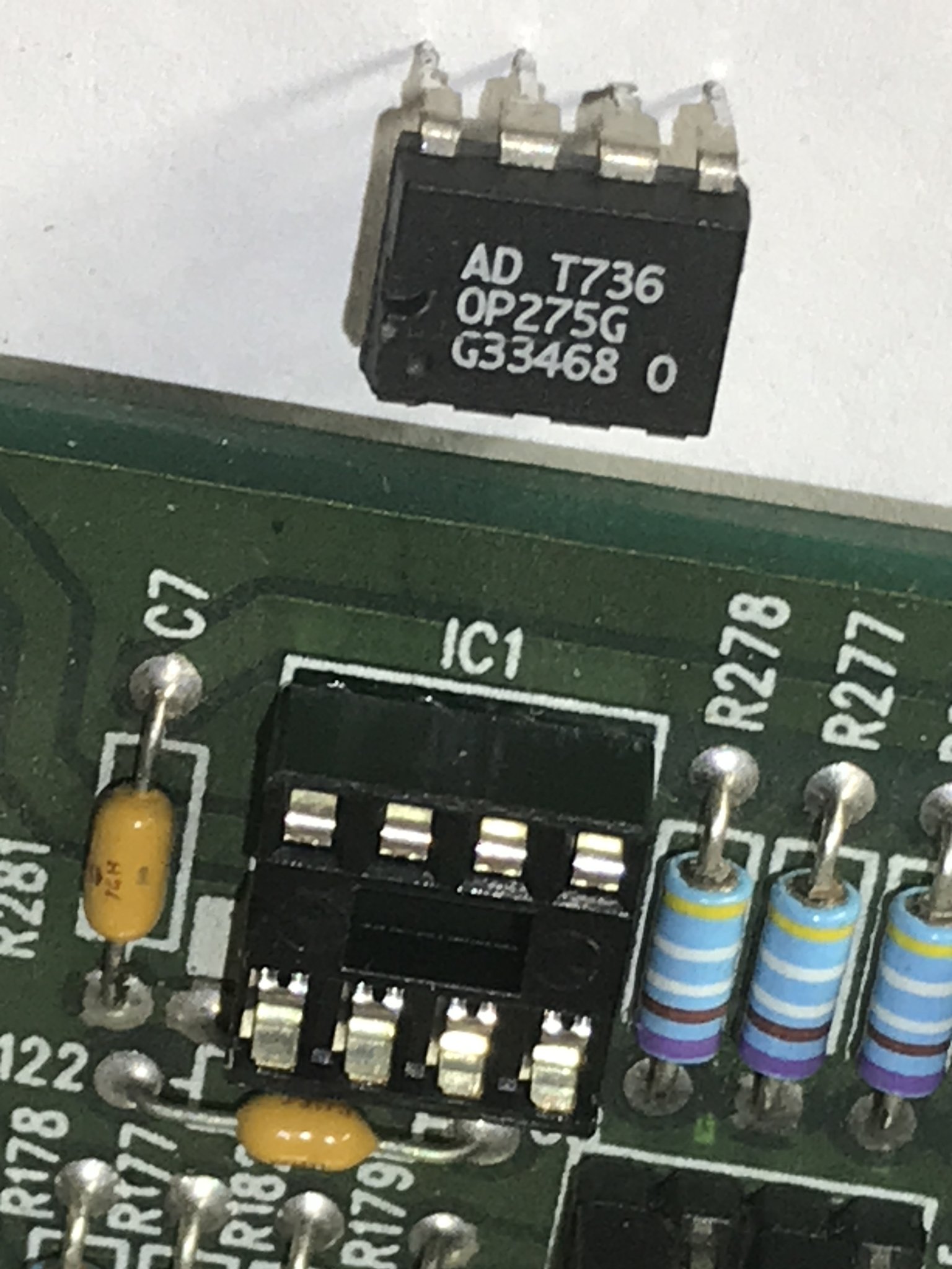

What opamp would you go for.?
I've got NE5532 - LM4562. Ive got some old JRC 4558's aswell.
I might put an IC socket there. Try some out.

I suggest removing IC1 as a first step. That will make several issues clearer: do the +/- opamp supply rails become sensible? What supply voltages are presented? That will help guide opamp selection. Do the volume pots then show 0V with suspect opamps absent?
A socket seems like a good idea.

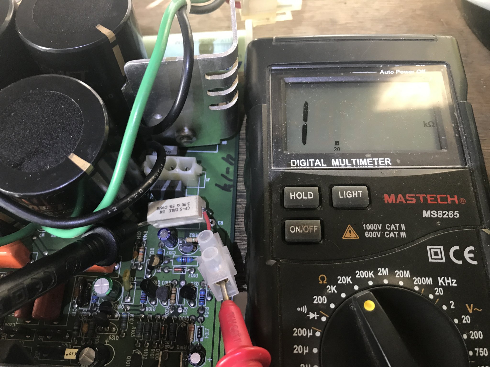

Did you see the main cap that shorted. Something either got under the cap or it leaked. There was a big moisture stain on the insulation board underneath. I tested them and that one was at 4200uf. The lowest one. Others were mid 5s. That’s what blew that resistor I think. I can take them out and test them aswell. Or lift a leg.

It's possible the 3.9k resistors are OK. If they were shorted from 85V to ground, the dissipation is about 1.9W, so a 5W resistor is a conservative size.
Try an ohmmeter check directly on the resistor leads for resistance confirmation. This helps to reveal trace integrity problems. Another tip is to test resistance with both meter polarities. If the readings differ, there's a semiconductor in parallel or stored charge in a cap.

On the other hand, maybe choosing OPA275 was a ticking bomb. But why would failure of the opamp precipitate failure of a 3.9k, 5W resistor? As noted above, if the resistor were shorted to ground, dissipation would be only 1.9W, only 37% of the 5W power rating. It would be nice to be confident of an enduring repair.

I took the good 3.9k resistor out of the other Amp and put it in this one. I had to.
All the problems are gone. Can you believe it.😀🙌

Curiosity compels me--- what opamp are you using? Did the original OP725 opamp survive? What supply voltages do you see?

Yea. It’s great. I tested the Volume wires ,no +10v and the IC1 opamp is getting the -20v now. There’s 0v on Pin 1 aswell. It’s the same one I put back in.

I’m going to try out a few different opamps in the IC1 spot. When I get the chance. That chip might not be what it once was. The amp has a lot of power ,you can tell ,but I’m finding it a bit on the harsh side. Sounds really good when at a moderate low level. I’m running straight from a MacBook Pro headphone plug at the moment.

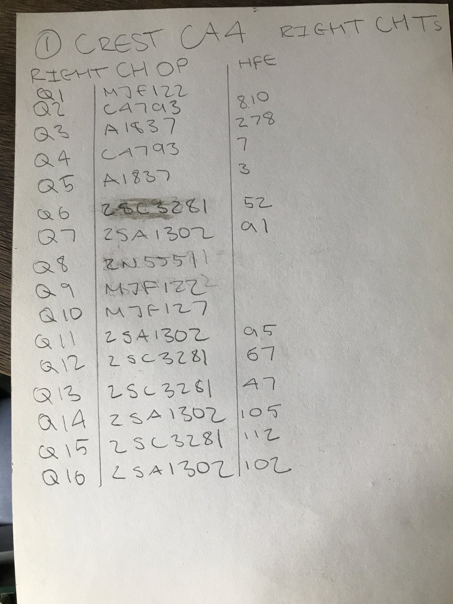

I’ve taken the right channel board out and lifted all the resistors I needed to and I’ve tested the resistors and transistors….
So far I’ve found 3 bad drivers and 3 bad transistors.
1 transistors beta is 51. Another is 47. Another 67.( 100 is the target.)
One driver has a beta of 3. Its partner is 7.(high V side) One has a beta of 800. The (good?) one is 276.

Testing at low current can give erroneous readings for beta. Well, not really. On early types the beta WAS much lower in the hundred uA to a mA or two range. Readings in the 40’s-50’s on NPN power types are very plausible. PNPs are usually tighter, even among vintage types. Matching of NPN to PNP over a wide range of current is better among the modern OnSemi MJL versions or Toshiba’s latest 2SC5200 and complement. If your transistors were made in the 90’s your readings are par for the course. Higher end manufacturers used to hand match them. Still do, it’s just easier now.
Readings that far off on typical driver types, however, indicate bad or potentially fake parts. Single digits and readings of 800 are bad either way. They shouldn’t be outside the 100 to 300 range, period - even at “transistor hFE test” levels on a DMM.
