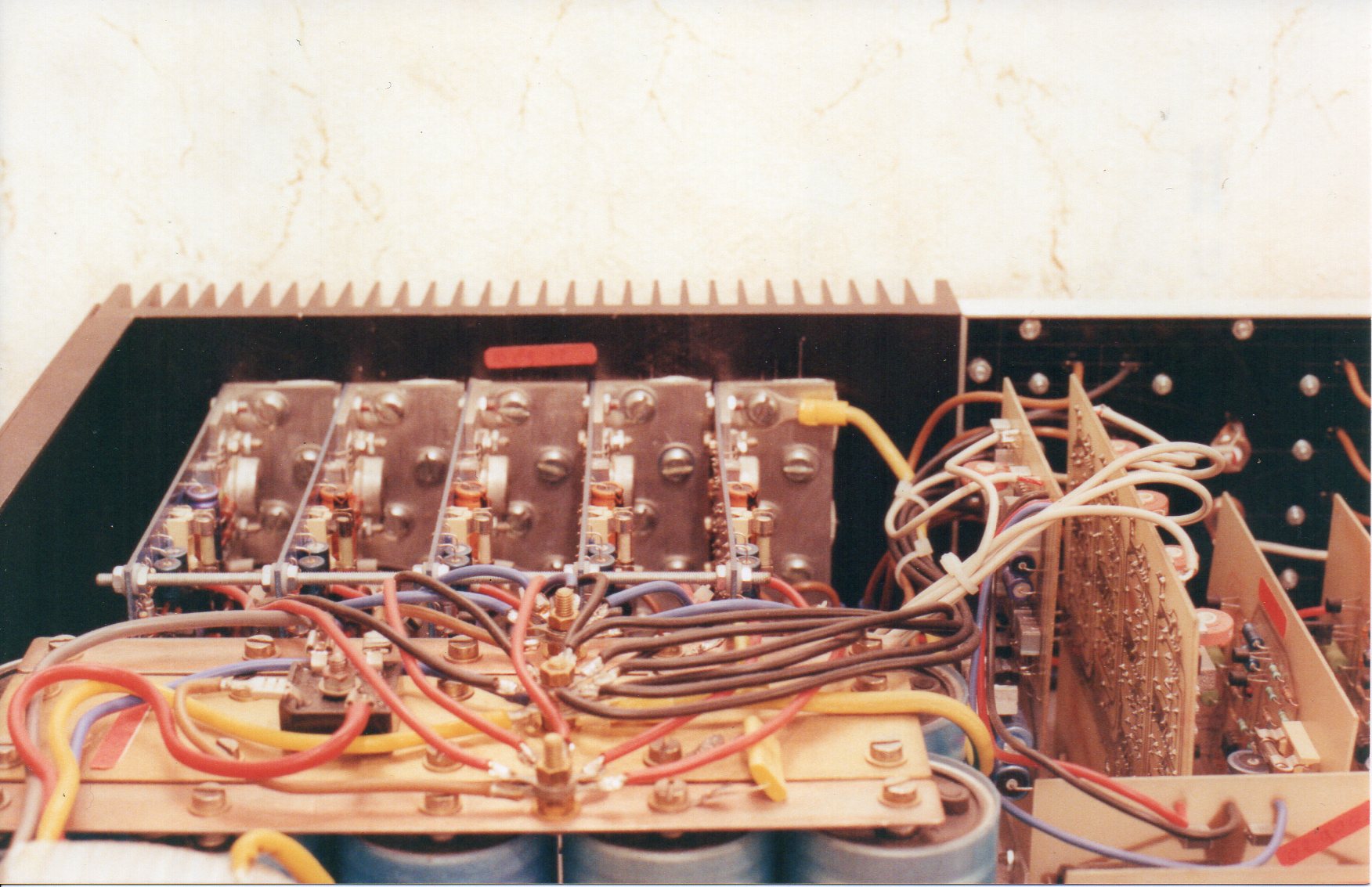

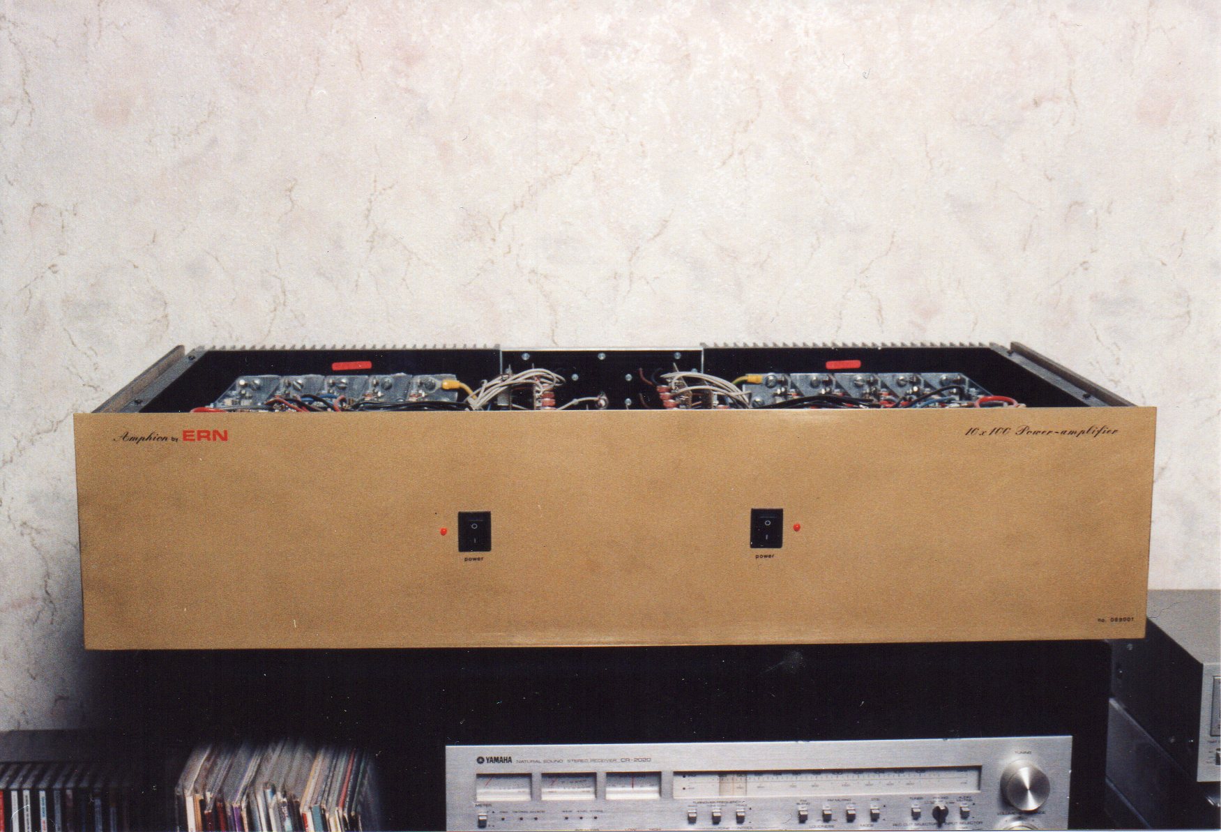

Below an amplifier I build around 1985 using 10 (ten) mini Crescendo's, 14 (fourteen) 4e order active Bessel filters, DC protection, soft start, and mains filters. Also a picture of one of the speakers I used to drive with it. I named them Amphion, a name later nicked by a Finnish manufacturer of inferior equipment.

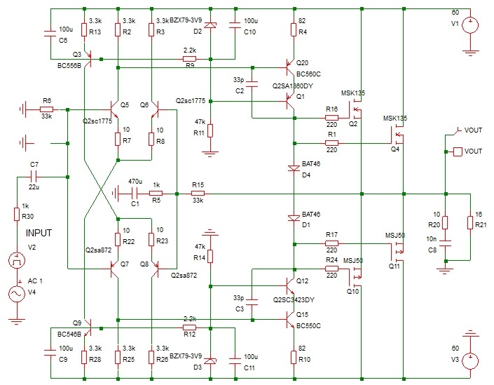

To remove any trouble two 33pF capacitors should be connected from the VAS output to its inputs to implement
a proper miller compensation, natively they did rely on the fets input capacitance to get a random shunt compensation
that doesnt work well if at all, hence why some people increase the VAS capacitive loading by connecting capacitors
from gates to source, wich is a dubbious solution.
If one use high supply voltages then best is to use 2SA992/2SC1845 wich are 120V but have also different pinout,
so beware if you do such a modification.
Also using 10k resistances to feed the cascode zeners require 0.5W resistances if not more, better use 33k or even 47k ones.
This way, a TMC compensation can also be implemented wich should yield a little better THD numbers,
but the implementation in the pic below is straightfoward and should tame any oscillations,
just make sure that the capacitors have at least 200V capability, if you cant find such high voltage caps
you can use two 100V 68pF capacitors in serial for each branch.

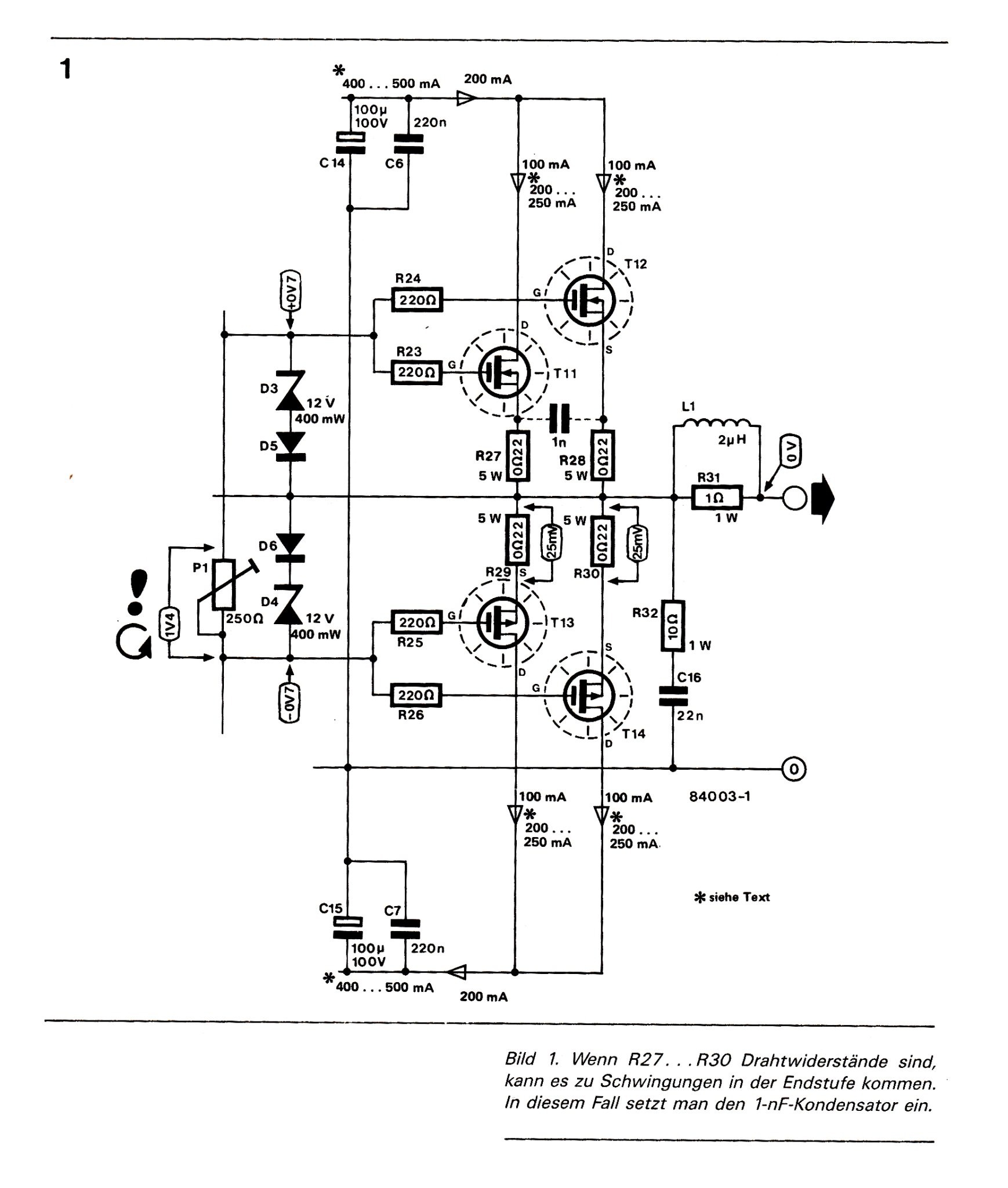

I remembered that wrong. The Mod only is helpful if you are using wire resistances at the output. Then, to avoid oscilations, one 1nf capacitor should be used.
See picture
See picture
Yes, that's the modification ELEKTOR suggested in the »Nachlese« (= aftermath) some months later.

Since the bases of the differentials transistors are tied to ground DC wise the emitters will be at about 0V as well,
so they have to sustain only a rail max voltage, so 120V is enough and much better than the original 65V Vce BC546/556.
In the schematic i posted these are 2SA872/2SC1775 wich are only 90V but in my builds of such symmetrical
differentials i used 2SA872A/2SC1775A wich are also 120V but have only 0.3W TDP capability.
FWIW i used such a symmetrical differential with those transistors for the differentials but also for the VAS with
a 2.5mA current and driving 3 pairs of 2SJ48/2SK133, wich are the 120V version of those old laterals, the amp was used
for PA purpose with a 2 x 43V toroid for roughly 15 years and it proved very reliable despite 4R loading and no forced cooling.
