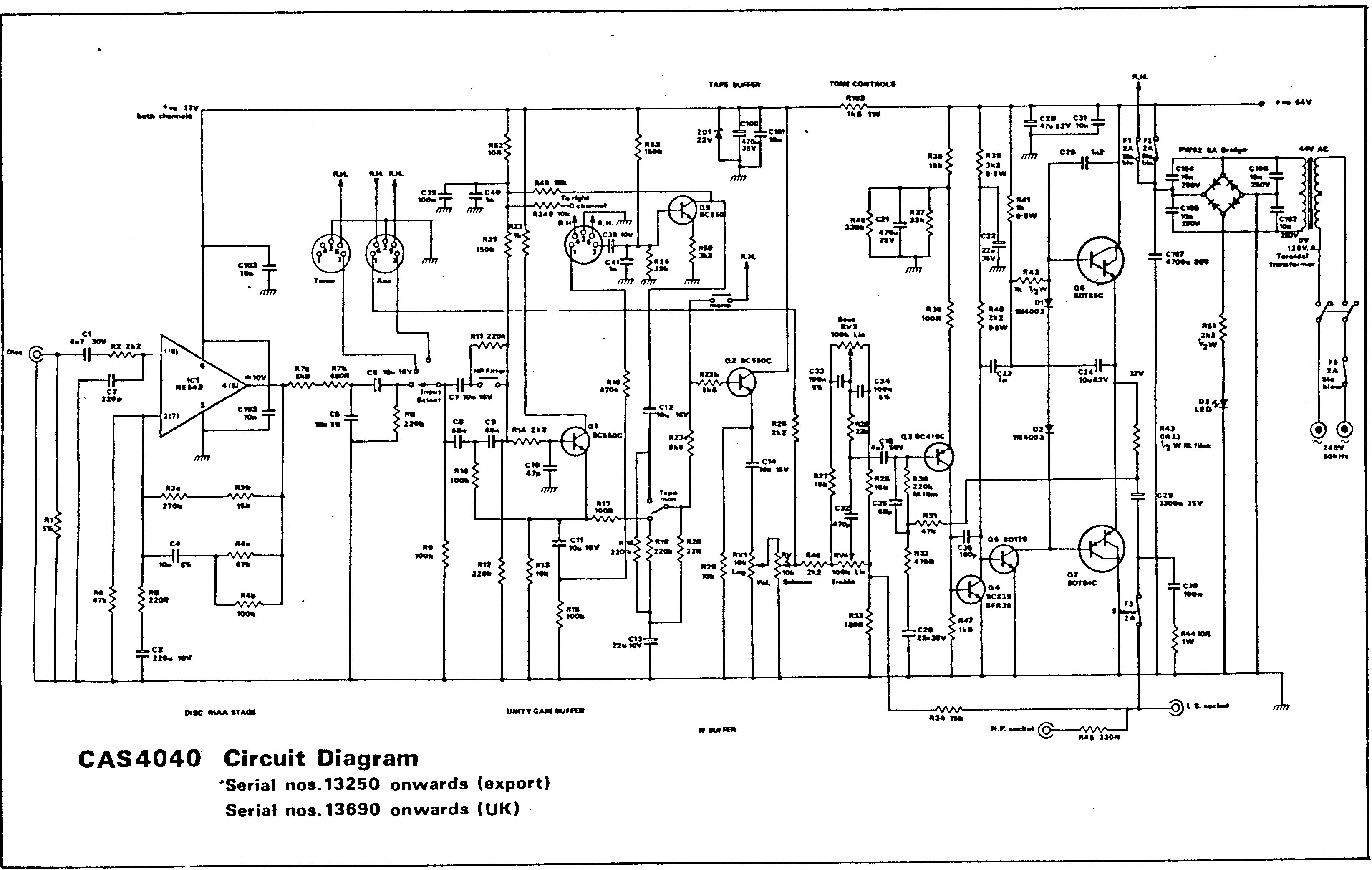

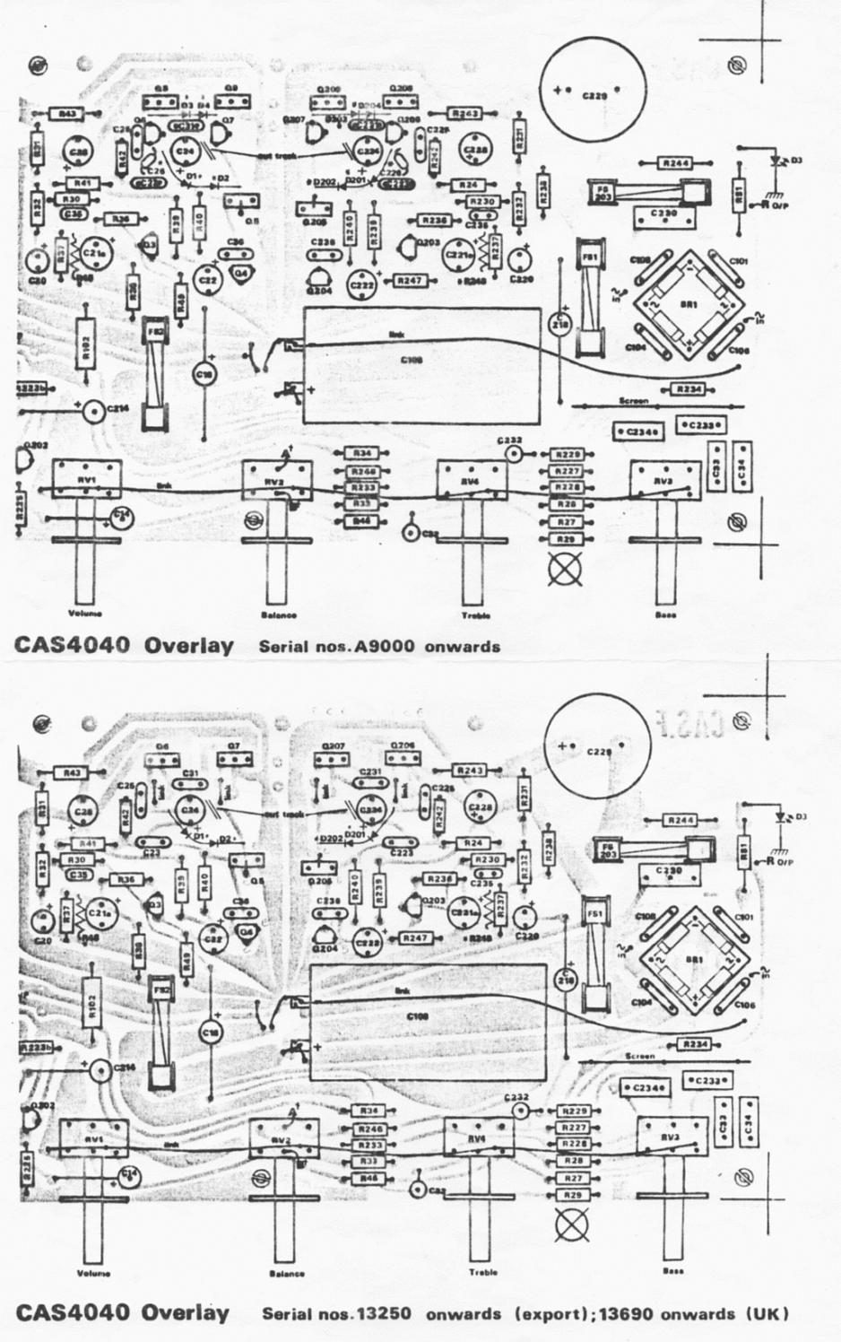

All I have are copies from copies from the eighties - a little awkward to read indeed. Sorry for that. I try to scan my data again for you. Please contact me via mail.
- the files are a bit too large to post them here.
ok, here are the uploads - they have been shrinked, but I hope you can read it. Please ask me for any further details. I also still have spares 🙂
If the output transistors are blown, it is quite likely the the drivers (if non darlington) and the class A stage is possibly blown also. Please check carefully.

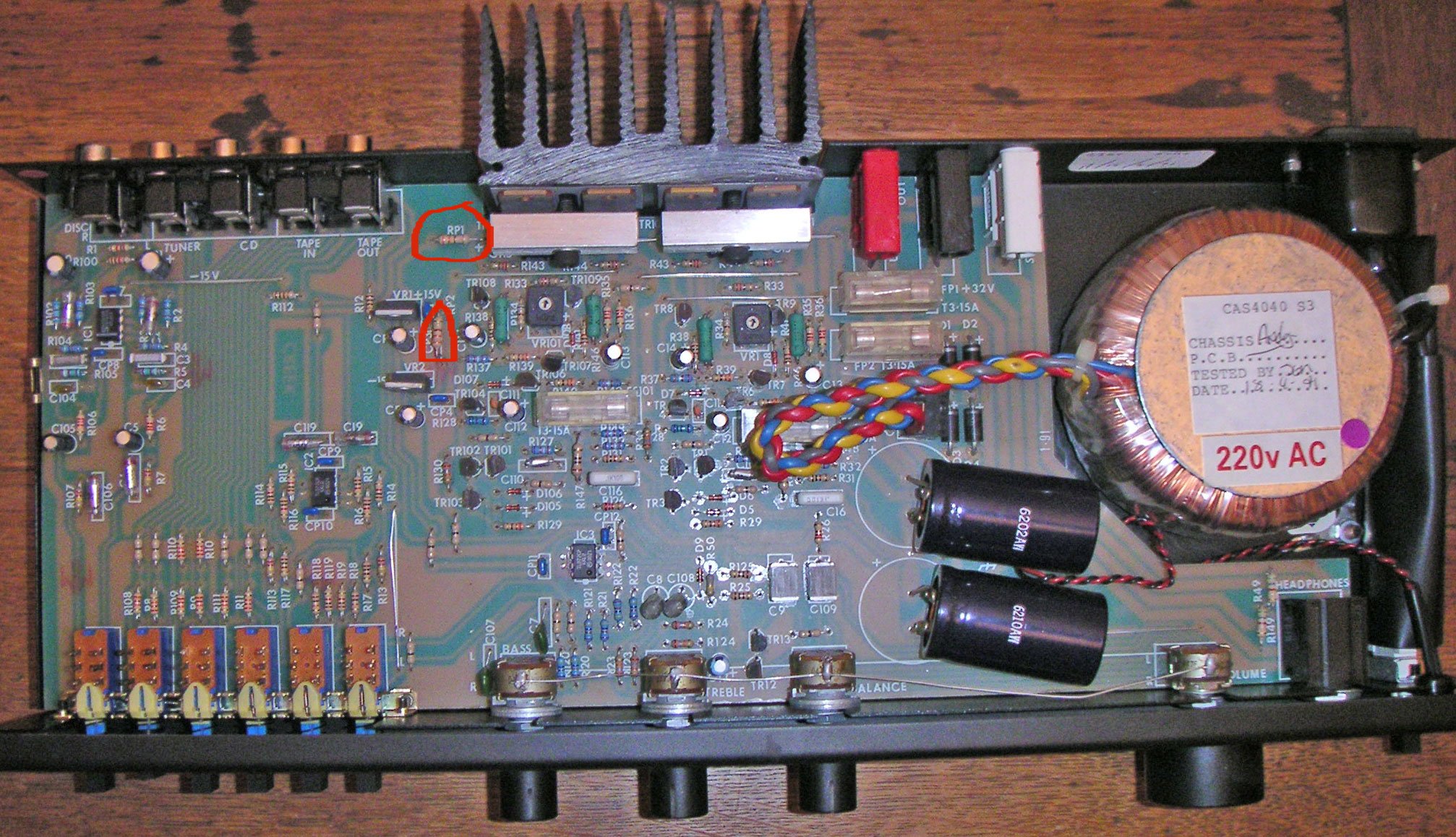

If you have these ones too, thanks in advance. Specially, the s1 model witch is the one in trouble. I have big "ploc" at startup and when powered off.

Would need to see the circuit to tell you that...
I see the transformer says "220Vac". Mains in the UK can reach as high as around 256 on a good day 🙂 I don't know why it would say that but for a UK product that is wrong and taken at face value means the DC rails in the amp could be somewhat higher than expected with possible problems due to over running parts/caps and consequent increased power dissipation.
