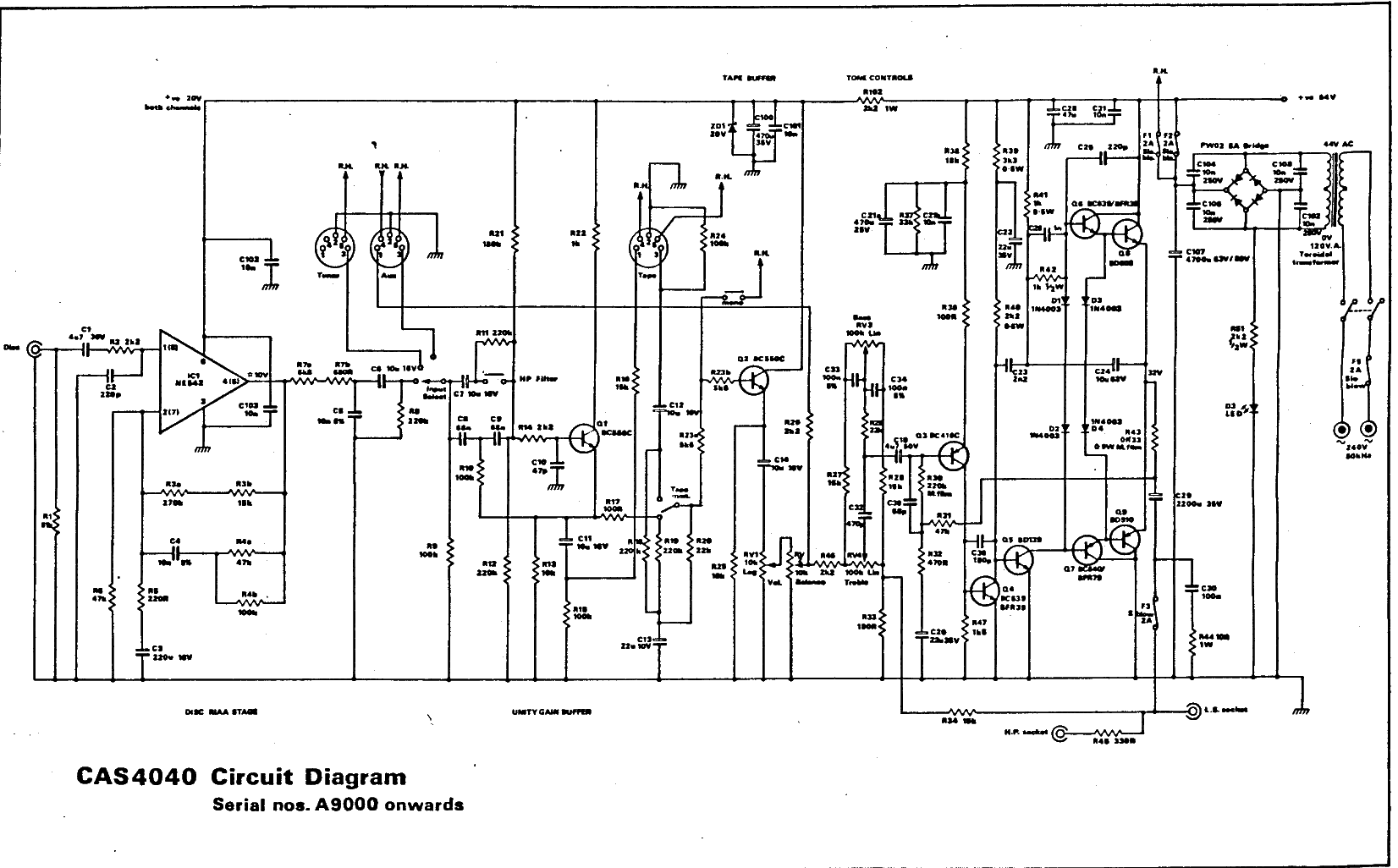

All I have are copies from copies from the eighties - a little awkward to read indeed. Sorry for that. I try to scan my data again for you. Please contact me via mail.

ok, here are the uploads - they have been shrinked, but I hope you can read it. Please ask me for any further details. I also still have spares 🙂
If the output transistors are blown, it is quite likely the the drivers (if non darlington) and the class A stage is possibly blown also. Please check carefully.

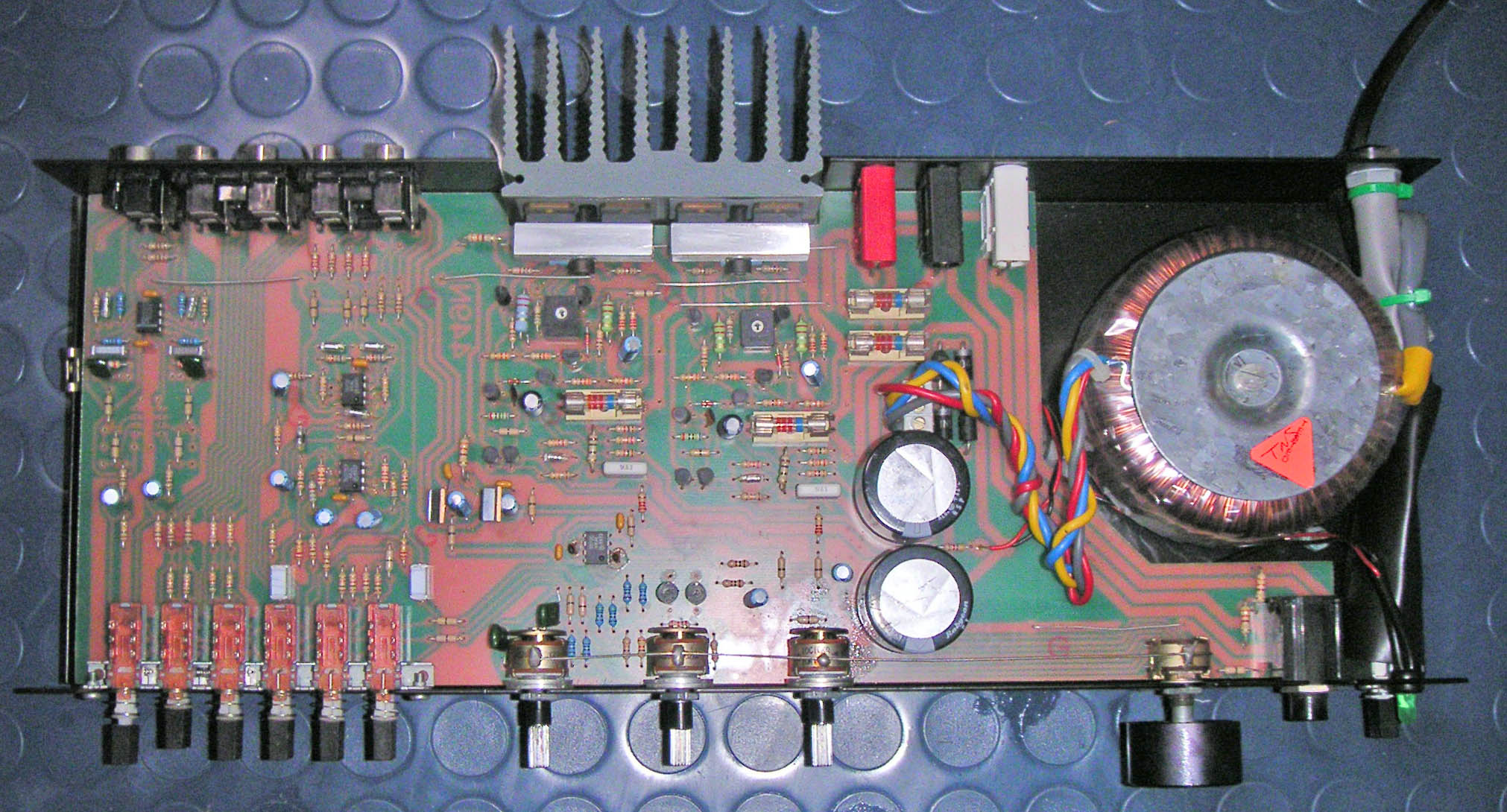

Would anyone happen to have a 4330 schematic? I guess I should not be surprised that the photo looks deceivingly simple. Second guess is it is a class AB single output design.

I found out that the output transistors are very expensive. So indeed, i have to find out first if the other transistors are ok. Thanks for the prints anyway.

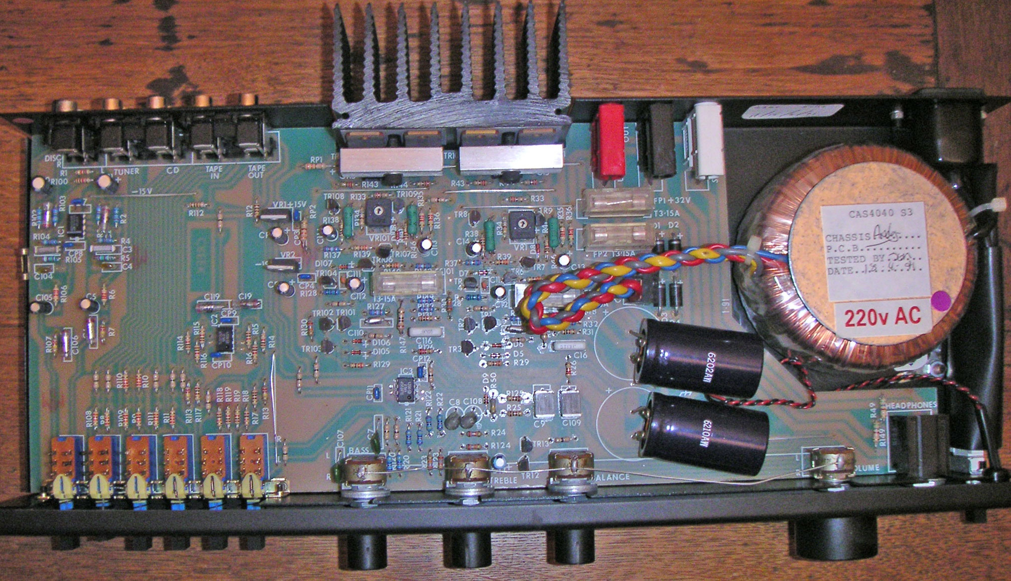

I see the transformer says "220Vac". Mains in the UK can reach as high as around 256 on a good day 🙂 I don't know why it would say that but for a UK product that is wrong and taken at face value means the DC rails in the amp could be somewhat higher than expected with possible problems due to over running parts/caps and consequent increased power dissipation.
RP1 and RP2 probably are the resistors for the power regulators for the input stages. If you have a too high voltages (because of highish mains supply) they have to work hard and get very hot.

I need schematic for Creek CAS4040 S3b version. Serial No: A 026975
It has BDW93C and BDW94C in output, three 1N4148 between BASE. BD139 and BC639 before them. No potentiometer for idle current.

- Creek CAS 4040 amp schematic
