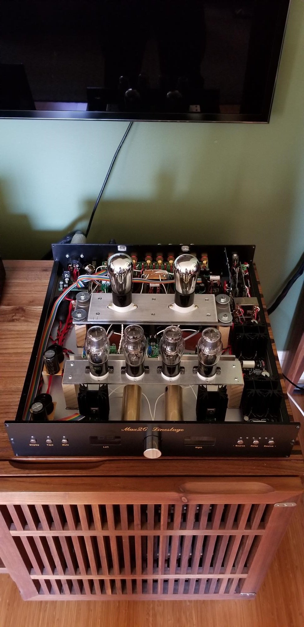

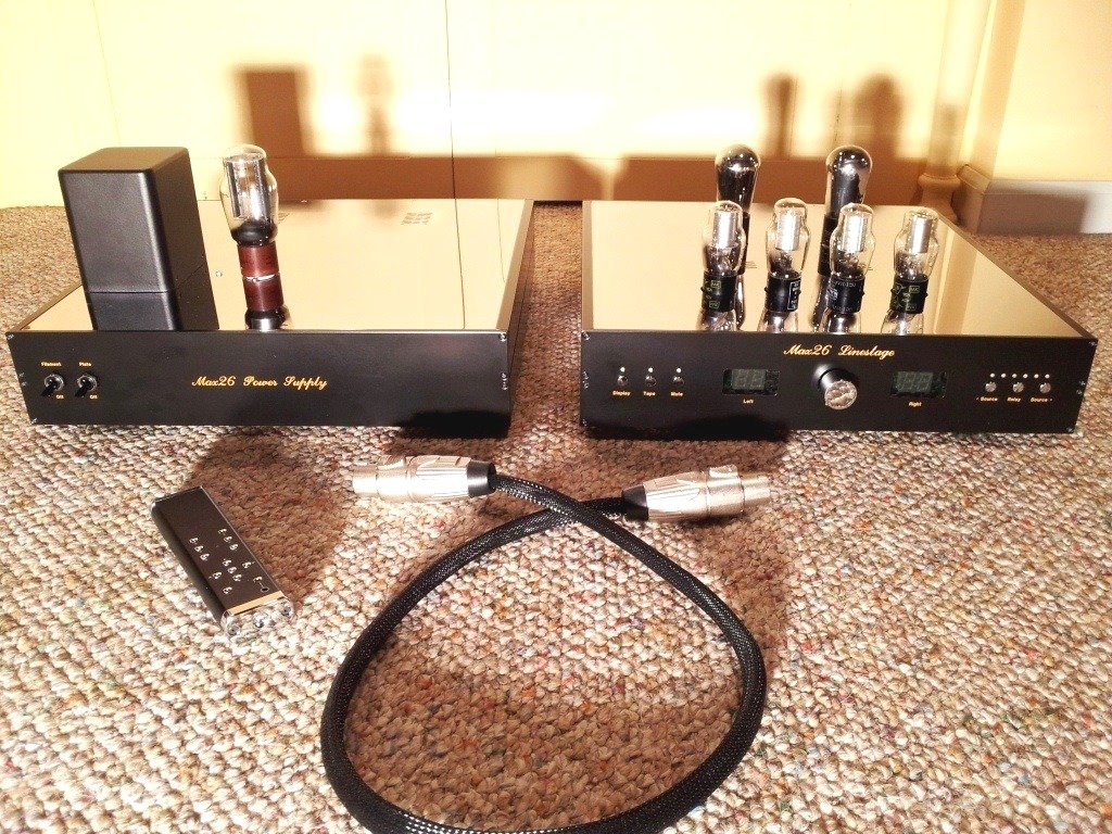

Lots of folks use glow tubes. For example, I have built a 01A DHT preamp/tube output DAC using one 0A3 and one 0D3 per channel for regulation, each channel fed by a CCS. Photos attached:
