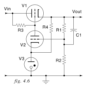

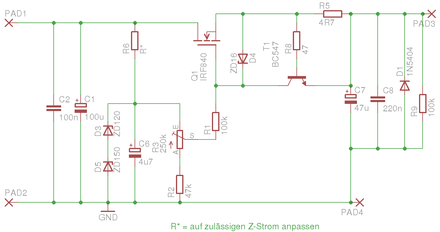

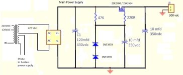

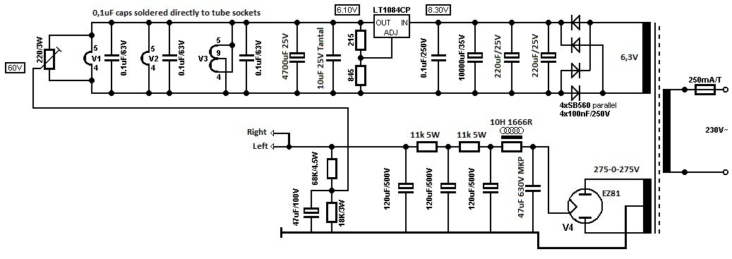

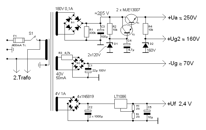

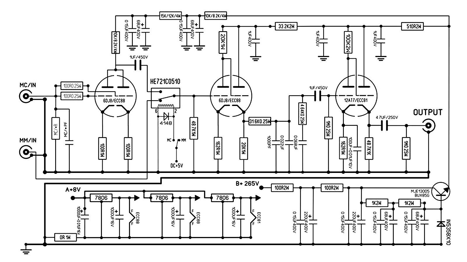

Some developers of tube amps claim, that for HV power supplies (for anode voltage) only passive filtering (maybe with zeners for slightly shunt regulation) are ensures the best possible sound quality resp best sonic performance. I. e. only one or two inductors and a chain consist of several RC filters. From my experience this is right, as long only top quality elcaps are in use and in the last RC filter additional a MKP version with 50-100uF.
An example are several pre-amp devices from Klimo.

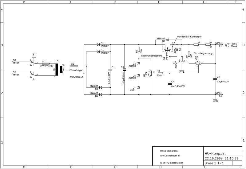

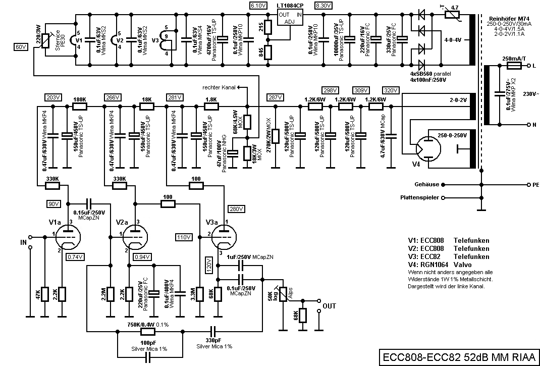

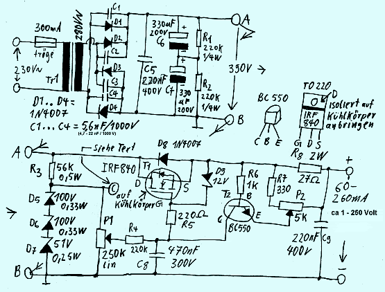

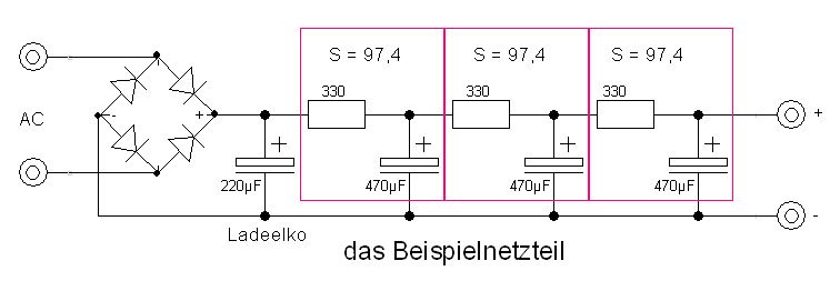

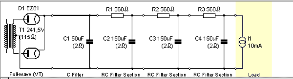

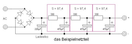

Schematics of first five attached images show such passive versions - i. e. without serial or parallel voltage regulation (except one version in inage 2 with the zeners).

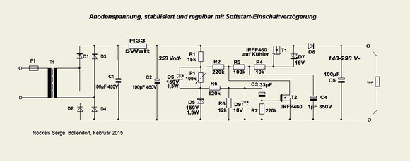

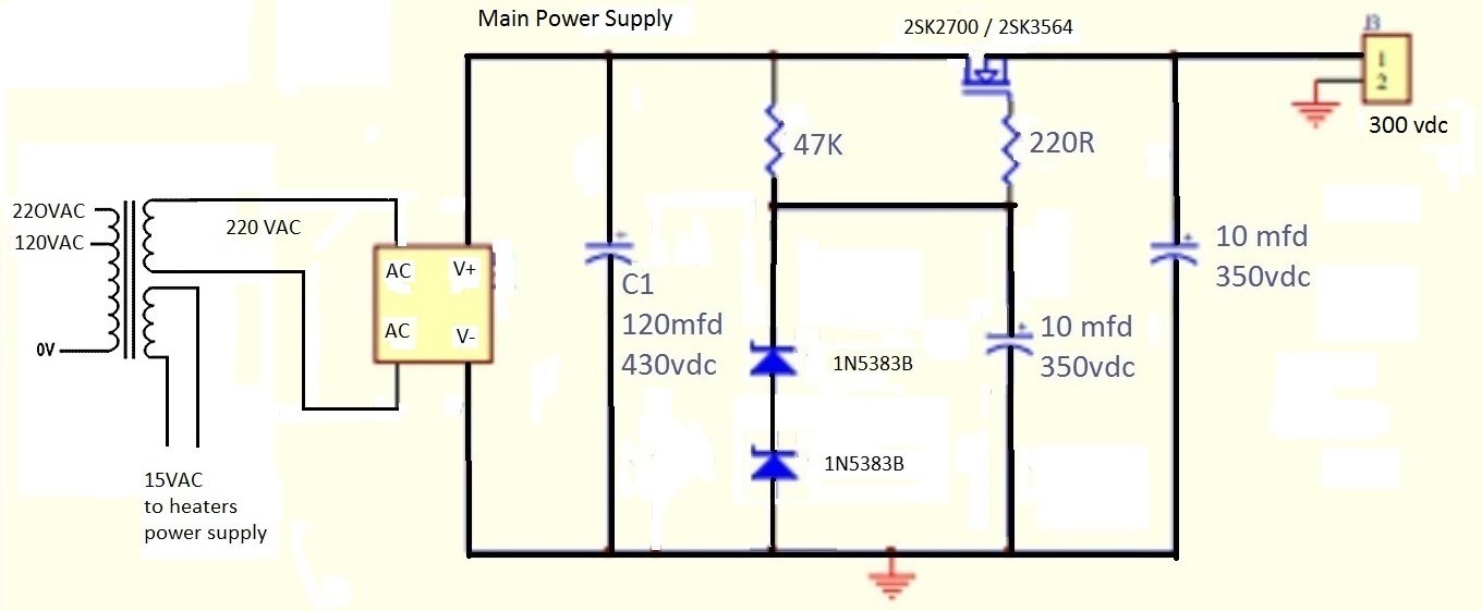

The later attachments show schematics of serial regulators in several variations.
At first glance the benefit of serial and parallel regulators are a very stable voltage, that is additional adjustable in a wide range.
But is it in real live really a fact, that a stable anode voltage provide a better audio than a passive filtered voltage ?
In general I don't think so.
Thank you for comments.

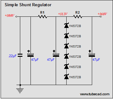

Very low parts count shunt regulator

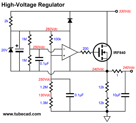

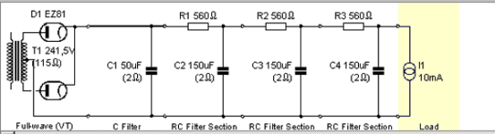

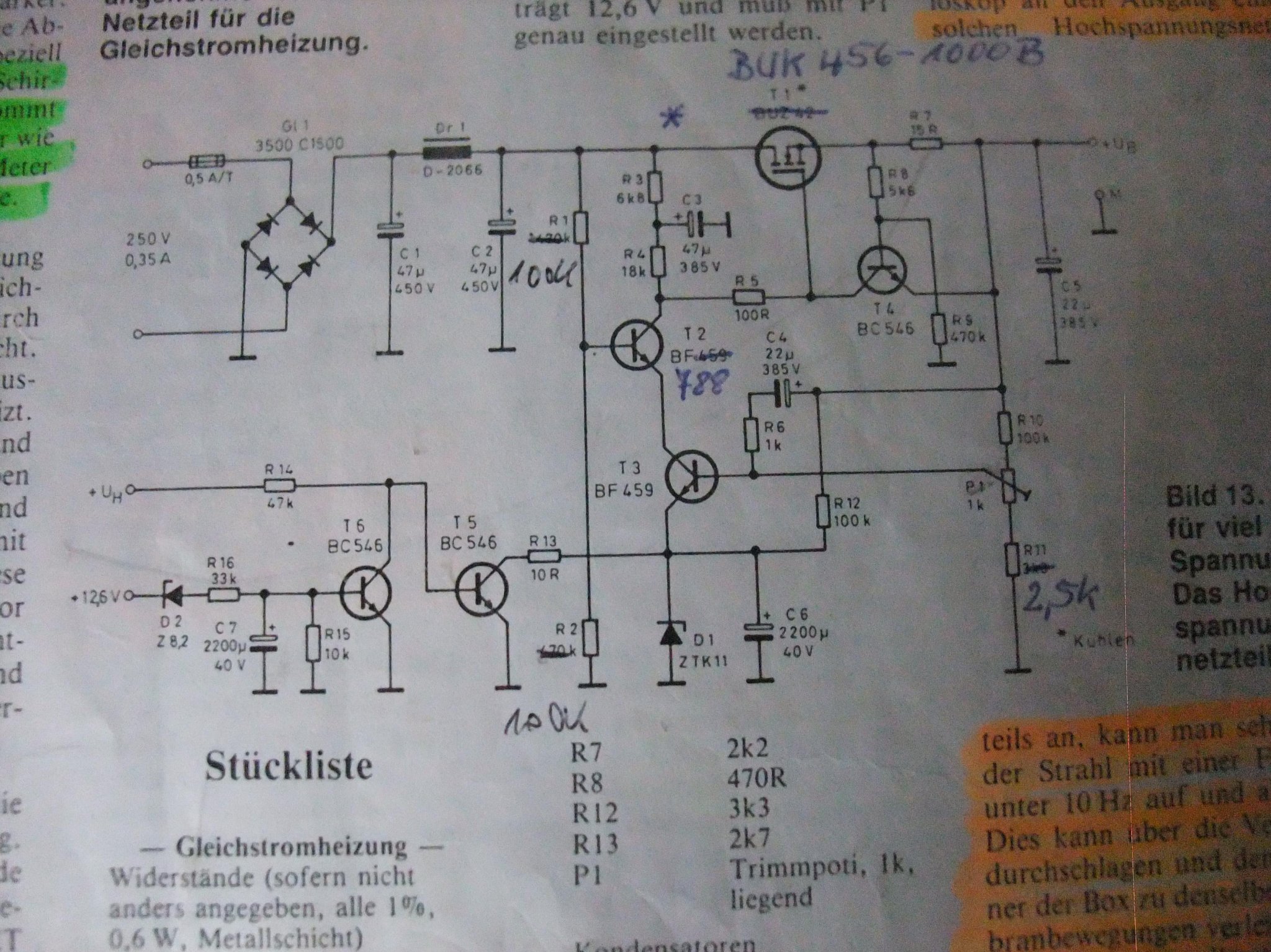

HV 265VDC MJE13005 serial regulator for klimo-phono.jpg172.9 KB · Views: 143

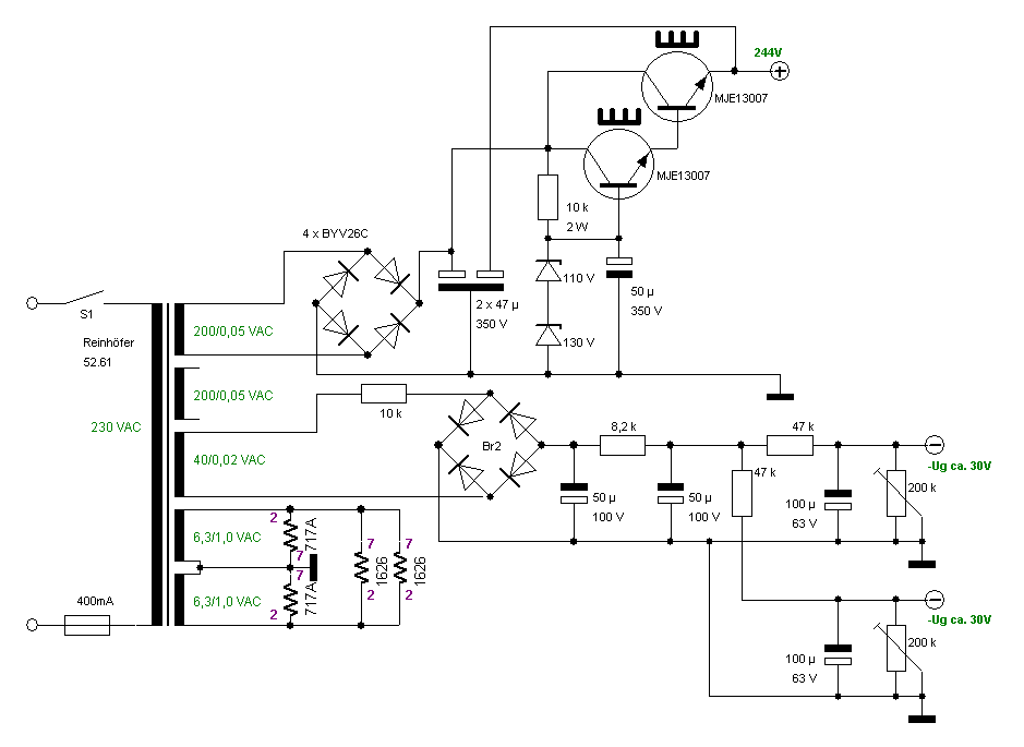

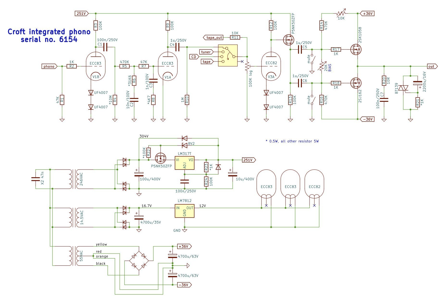

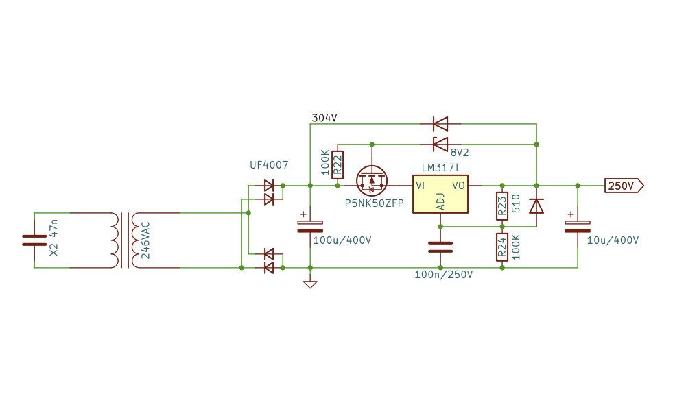

Image 1-3 show some serial regulator schematics like used in the Croft tube pre- and power amps series 7 (image 4 is the topology from the croft series 7 itself.
Are there a colloquial naming for this kind of serial regulation ?
Thank you for an advice.

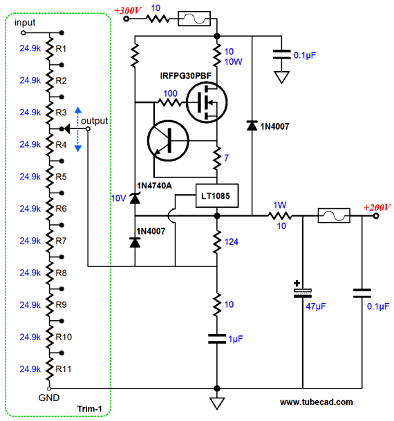

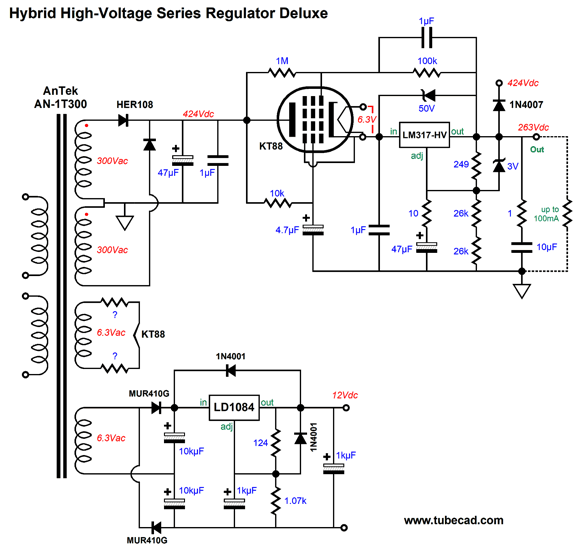

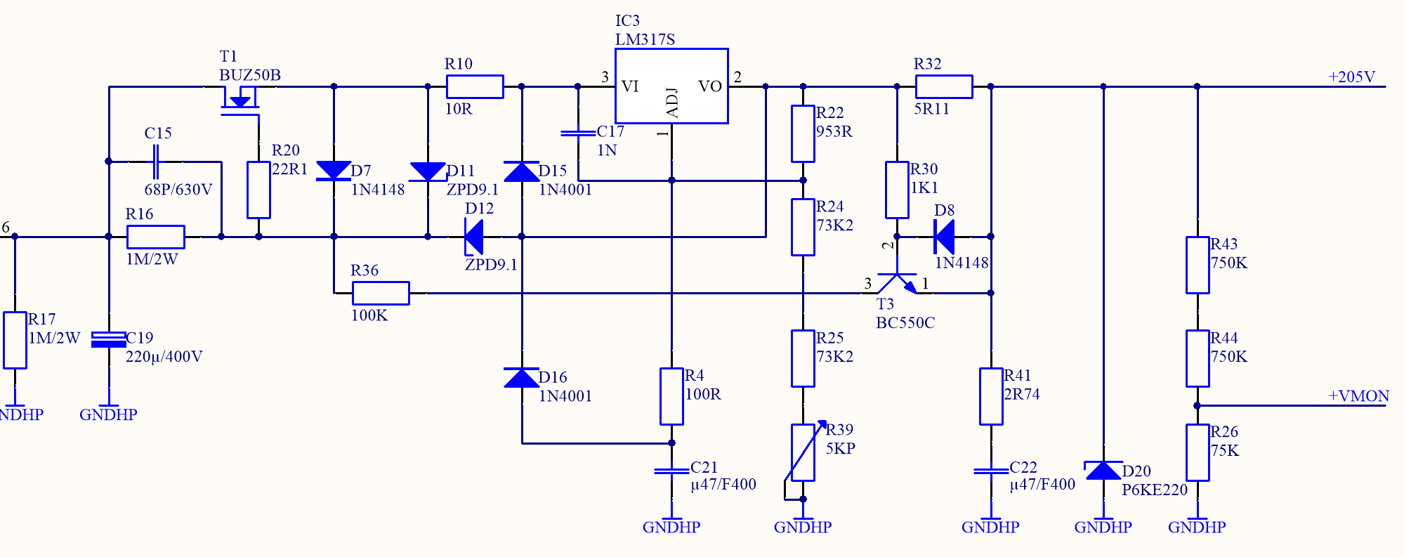

HV LM317+BUZ50B 205V_100mA voltage regulator - microcontroller.net Stabiröhrenschaltung erset...webp24.2 KB · Views: 117
What is ...YOUR... definition of ''best possible sound quality'' ? Does any of the examples create that? How do you know?

yes, good advice (AN007335, National Semiconductor Linear Brief 47, Michael Maida, March 1980)Maida style regulator...?
An interesting approach to use low voltage integrated regulators for regulated high voltage power supplies.
https://www.ti.com/lit/an/snva583/snva583.pdf
https://www.ti.com/lit/an/snoa648/snoa648.pdf

21st Century Maida regulator doesn't regulate heavy load
Maybe it is possible to make things better in the version used in croft series 7.

I remember long time ago (80s) Klimo explained during a demonstration of his tube amp devices (with outdoor power supplies) at a trade fair (High End, Gravenbruch Kempinski/Ffm), that only with a passive filtering the very good sound results, which were clearly comprehensible on this day, could be achieved.
P.S.: (reply post #5) ''best possible sound quality'' means for me, a maximum authenticity, i.e. the presentation of the recording on a listening test session gives the illusion that it is taking place "LIVE"

Ultimately, I believe that – when series regulators are in use – the sonic influences arise from the fact that the filtering capacitor behind the series regulator is usually too small, and thus the signature of the series regulator is more or less evident in the sound perception.
This is the great advantage of parallel resp. shunt regulators and passive filters; here, this capacitor, this is between pos. and neg. rail of the actually amp resp. preamp unit, can be made as large as desired with lowest ESR, thus achieving maximum possible sonic performance (of course, in power amplifiers, only if the transformer and choke are significantly oversized).
Unfortunately this is not possible with serial regulators without additional efforts for protection the serial regulator unit due the inrush current peak after switch on.

This is a very complex question that discussions often try to simplify down to a single simple answer.At first glance the benefit of serial and parallel regulators are a very stable voltage, that is additional adjustable in a wide range.
The difficulty is what effect a power supply has on a amplifier's signal path is very complex.
I will mention a few basic issues. There are many more often largely ignored or misunderstood.
Many tube design amplifier stages have low power supply rejection ratios (PSRR) .
Some tube design amplifier stages have modest PSRR.
A very few tube amplifier stages where the designer by intent focused on the PSRR are good at preventing power supply characteristics from affecting the signal path.
So what effect a power supply will have on a amplifier's sound is very dependent on the amplifier's basic PSRR.
Second PSRR of a amplifier is almost always frequency dependent.
Some amplifer designs have PSRR with a subsonic PSRR of zero dB or less These amplifiers can experience bias wander affected by unregulated supplies from line voltage variation that will cause a varying level of distortion as the line voltage drifts up and down.
Other amplifier designs have poor high frequency PSRR and will add high frequency "hash" to the signal path if the power supply has any high frequency noise from active regulators. These noises can cause increased nonlinearly in feedback designs if the hash noise is above frequencies that the feedback loop correctly works at leading issues like the slew rate limiting in the input circuits where the feedback is injected.
