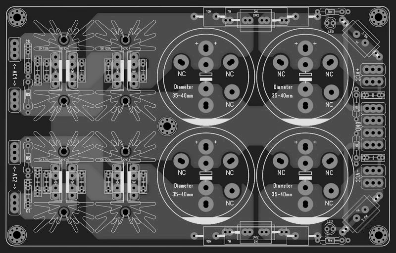

New layout
Hello everyone
The layout of the new version is ready! 🙂
It will be possible to use 5-pin capacitors and also rectifier diodes in the TO247 package.
Thanks again to Prasi for taking care of the purchasing group. :up:
Regard's

Great design. I have a very big stock of 5 pin capacitors and until now I never could use them without modifying them.

Hi Prasi,
I have built two power supply with the previous version and I was impressed by the quality of the PCB, however I found that the mounting holes for the heat sink were a little bit too small for some suppliers like "Ohmite heatsink TO-220 EA-T220-51E" from Mouser, I would suggest to increase it by 0.1 or 0.2 mm for this new version...
Rgds,
Marc
Hi Prasi,
Rgds,
Marc
Ok, I will edit the layout,
thank you. 🙂
