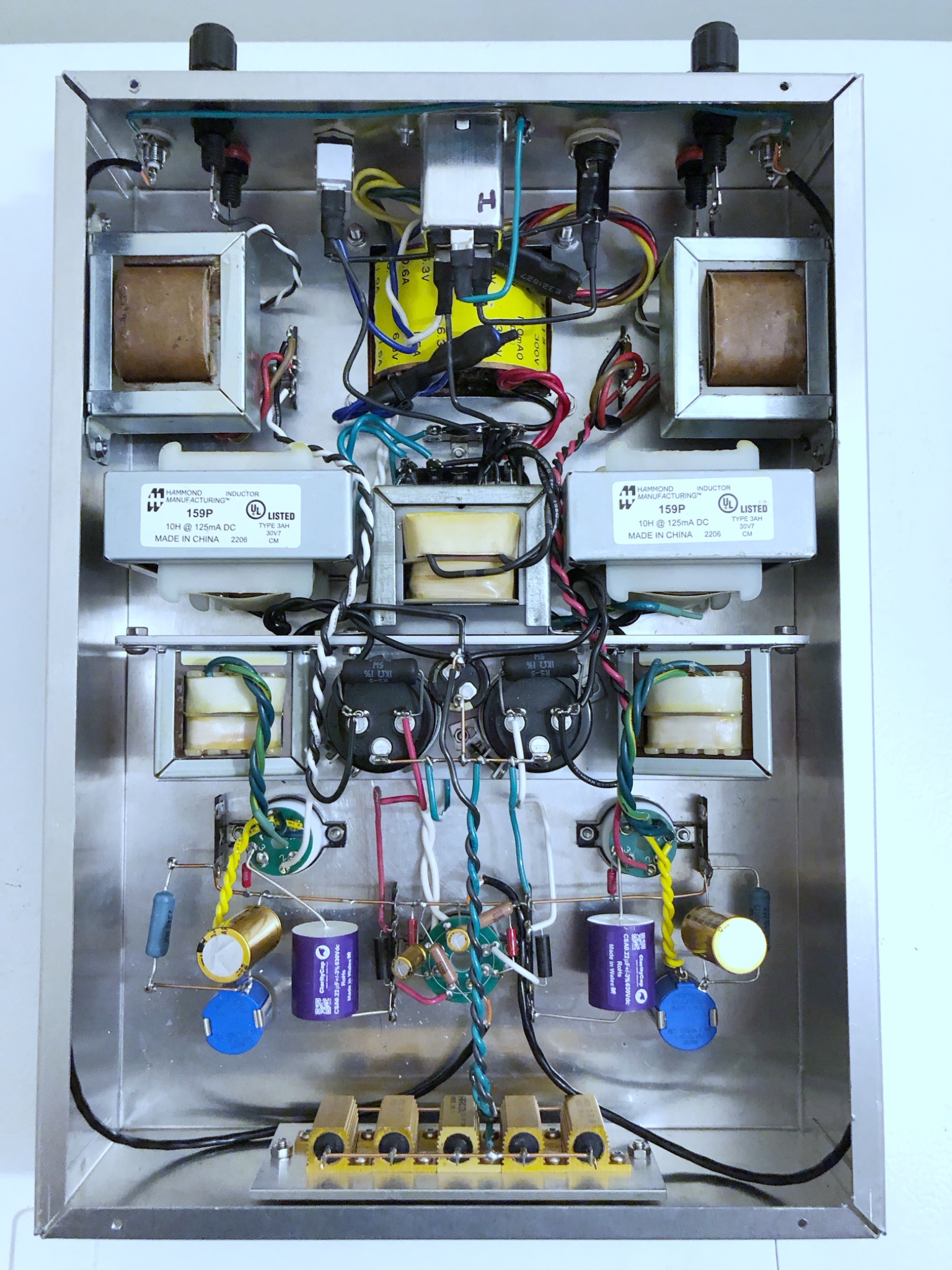

Please don’t forget to ground the speaker negative, one shorted turn, and you end up with B+ on the speaker jacks, not good.
Thanks!
I will address the speaker ground! Where is the “best” place in the ground path to connect those?

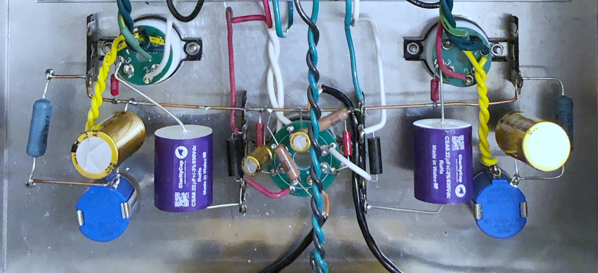

And all the resistors are there, just might not be easily visible 🙂
That two 600ohm taps are wrapped and capped, not visible as they are tucked away under the output transformers.
As they are 600ohm taps, a 600 ohm resistor? I wonder how they were handled in the TC500A at the headphone jack?

I had obviously planned to just leave them twisted/capped. Had not considered doing anything w the 600ohm taps. But how these things work, is above my pay grade.

I did not see any grid stoppers on the two 4 pin sockets, around 100 ohms would be a good value for the 45 tubes.
Rikaro is half right, you should not terminate the 600 on winding with a 600 ohm resistor. In the TC 500 a schematic it is terminated with a 3.3 k resistor at the line out jack. That’s exactly what I use in my build. A 3 W resistor.
If it was another four, or 8 ohm winding, you would not need to terminate it. But due to the fact that it is a 600 ohm winding, if it is not terminated, it will affect the high frequency response of the transformer. Don’t believe me? Measure it.

Technically, the best place to ground The speaker output would be where the cathode resistor for the output tube is grounded.
The 600 ohm winding on the transformer is in reality quite many turns of copper. 5K to 600 ohms is a 1:3 ratio. Output Transformers are complicated……. It can have parasitic effects on the frequency response if it’s just left, floating in the wind.

I still don’t understand how “craigtone” Decided to use an input tube that is resistor loaded, with a gain of probably around 15, to drive an output to its biased at around -50 V…. You need a preamp has a heroic output to drive this amp…..
That’s why I went with a 6sl7 in my 45 amp, it has a gain of around 70, much better suited to produce a drive voltage for a DHT that requires so much voltage swing at its grid.

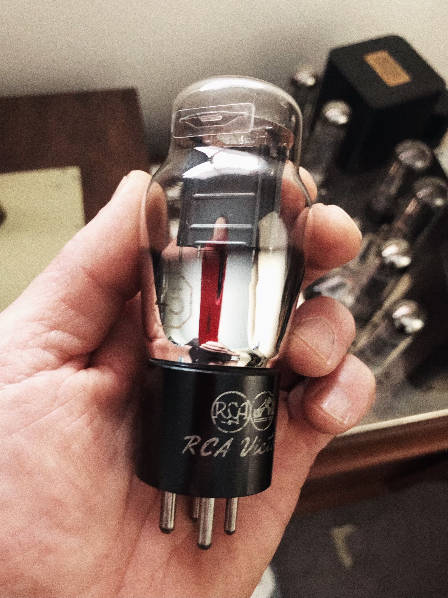

Tubes arrived! Bit delayed because of postal strike, but now they are here.
Amp is dead silent. No hum or hiss. Makes me very happy. Was also spared any magic blue smoke.
Problem, however, it’s distorting the sound like crazy!!!
Voltages are exactly where they should be - I think….
Any help would be greatly appreciated!
