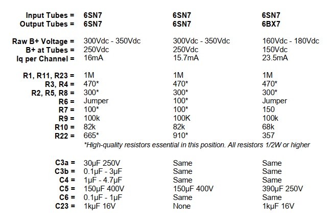

The power transformer will be 230vac, giving something like 320vdc at the filter caps (minus losses).
To throw a spanner in the discussion, John Broskie specifies a 250Vdc rated cap for this position in the Octal Stereo Manual.
Does this change opinions at all?

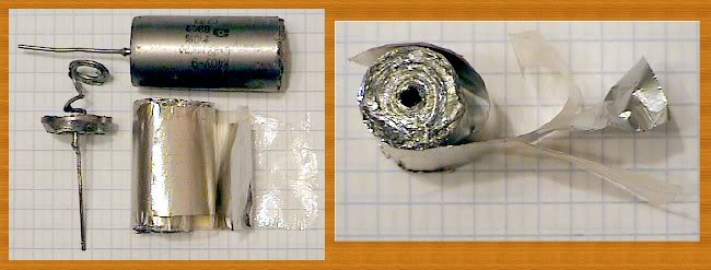

Ok I have used K42y russion 25ov PIO a good bit, and I do have a few comments, they are paper, not film so they will take 20% over voltage or so, no more.
As one poster mentioned, they must be checked for leakage, I have had one leak....and here is the drum roll, I had a failure I did not understand, desoldered the K42y, and it was leaky after, when I had tested it as good, before installation....The problem:
The K42y was installed in 4way junction that I had to get really hot for my silver solder to wet nicely.
I believe I damaged the K42y during soldering.....so this is another tricky issue when you are close to overvoltage ....this kind of damage will take anything "extra"....
I heat sink them when I solder now....

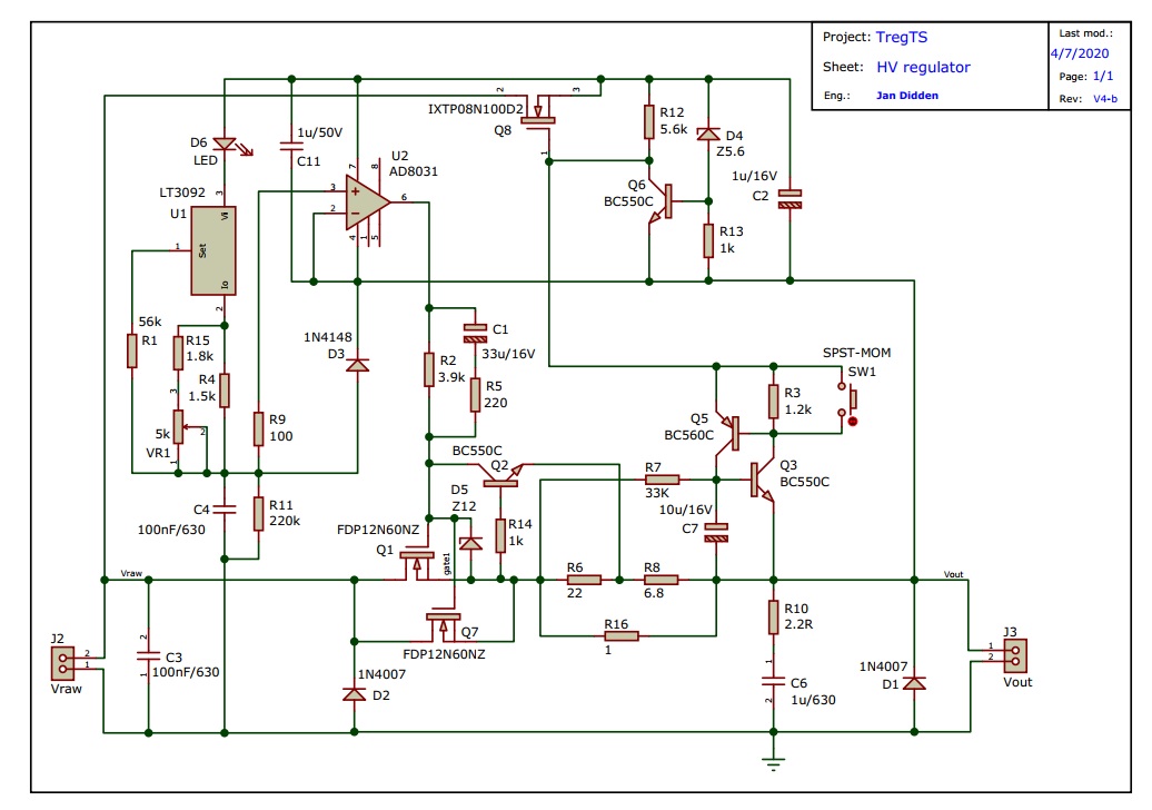

Also I am not sure which capacitors you are referring to in your schematic...All of them? C3, C4, C5, C6...etc...
And for each capacitor a fault analysis question should be asked specifically if you are going to go ahead....i.e. if this capacitor fails as a short what will the results be, for each capacitor position.
