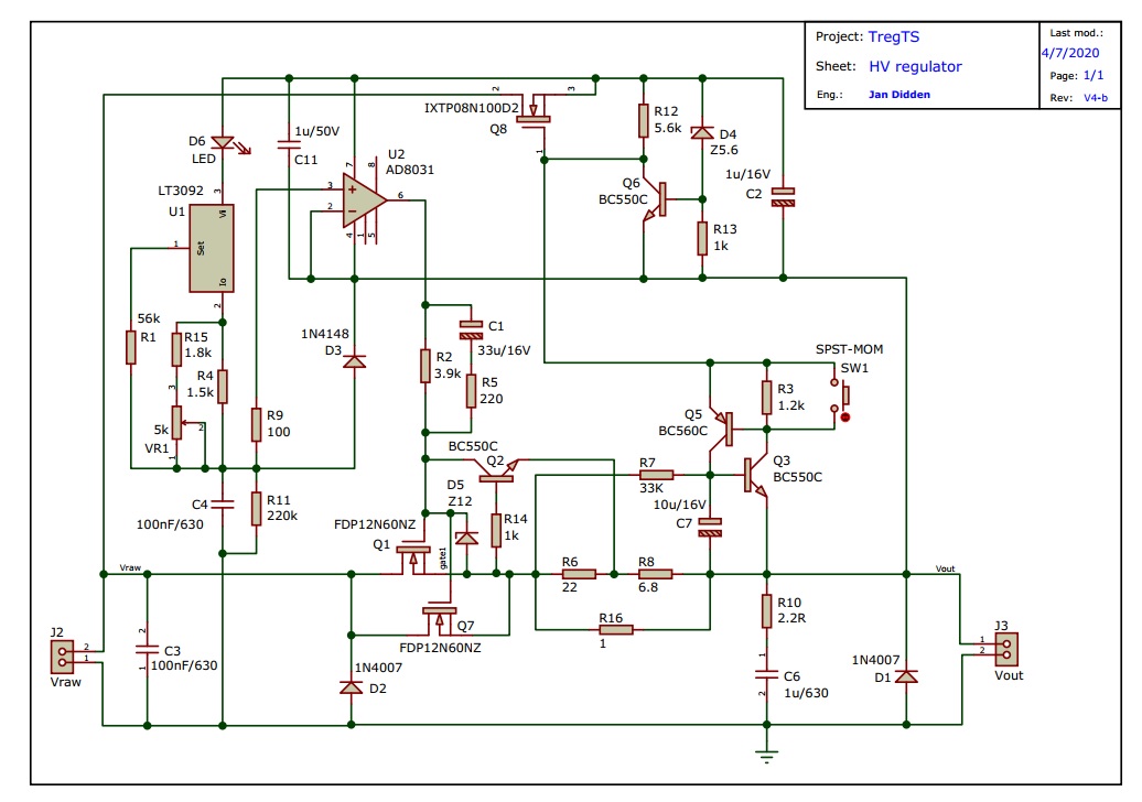

The regulator in question is Jan's Treg.
The power transformer will be 230vac, giving something like 320vdc at the filter caps (minus losses).
To throw a spanner in the discussion, John Broskie specifies a 250Vdc rated cap for this position in the Octal Stereo Manual.
Does this change opinions at all?
i think the question you have to ask yourself is, what if tubes or devices fail,what will the cap see in terms of dc volts?
deciding then becomes easy..

Also I am not sure which capacitors you are referring to in your schematic...All of them? C3, C4, C5, C6...etc...
And for each capacitor a fault analysis question should be asked specifically if you are going to go ahead....i.e. if this capacitor fails as a short what will the results be, for each capacitor position.

What is C6 for? That looks like a misteak(sic) to me.
On board psu decoupling for the heaters.
I’m open to the idea that it is unnecessary however it seems to be present on all of Broskie’s designs from which this is adapted.
Are you sure? I see in the manual:To throw a spanner in the discussion, John Broskie specifies a 250Vdc rated cap for this position in the Octal Stereo Manual.
"*voltage rating must equal or exceed B+ voltage"

Ah. IIRC in later versions of the design he added 1M 'emergency' resistors to the grid of the top output tube, so even if one is pulled, the output capacitor won't see more than 250V.
